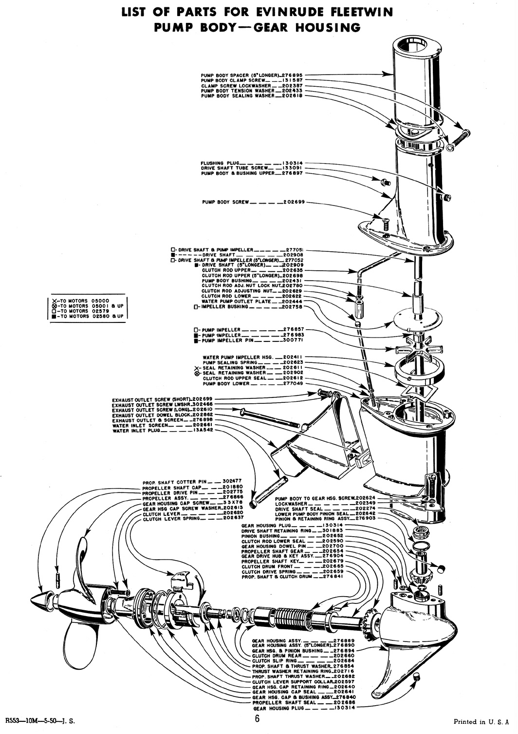

      I am working on an early evinrude fleetwin outboard from 1951 7.5 hp
      I so far i have not been able to locate a rebuild kit for the early models and was wondering if anyone has a list of seal numbers to buy to make up a kit for myself at a bearing and seal shop. Also i am looking for a waterpump for this paticular model and know it is a tricky thing to find can anyone help me out with that also.
      Thank you
      E.H.
      #14461
        A kit was never made for those models. You will have to match them up at a supply warehouse.
