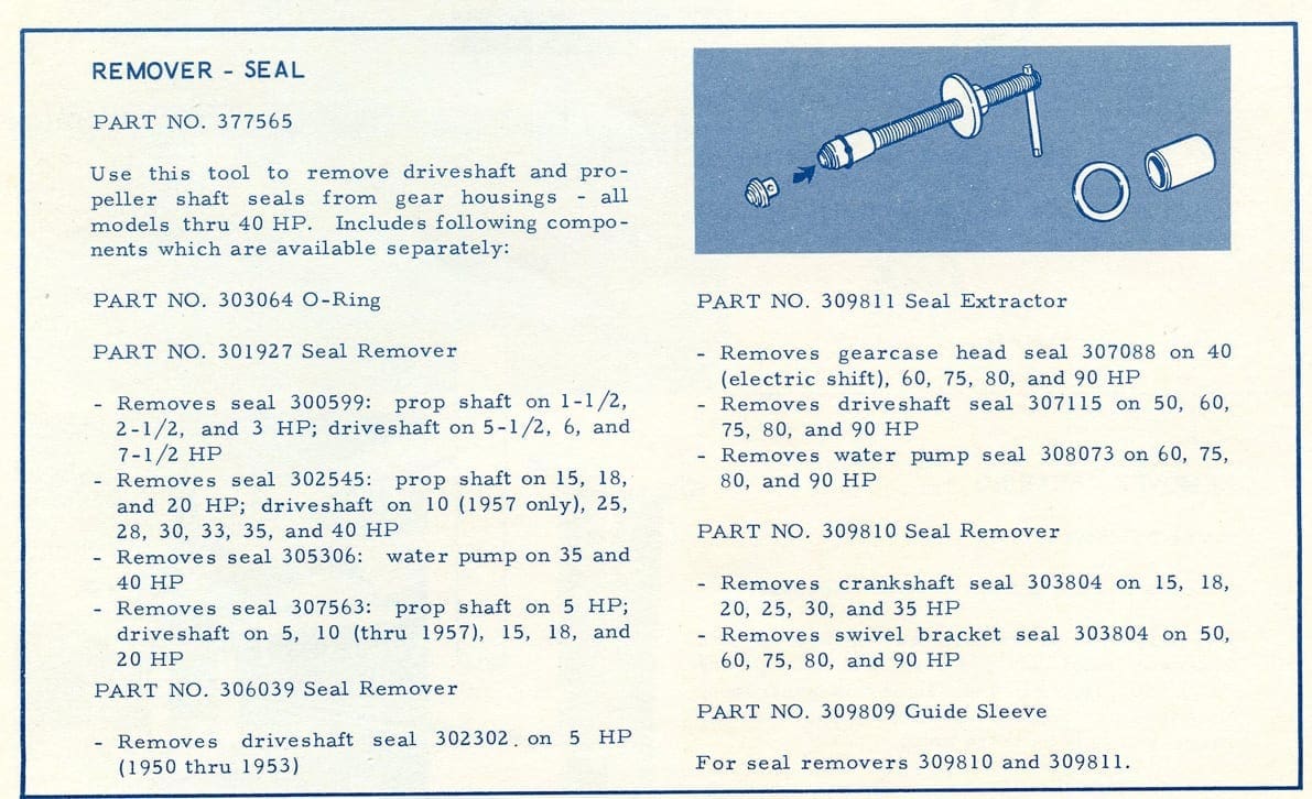

        #184085
          This is what I have – – –
