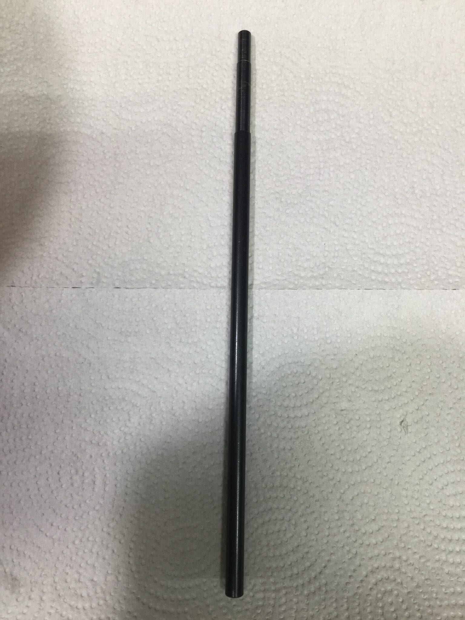

        The tool for removing the shift rod bushing and O-ring seal is OMC #304514.
        02-OMC-Bushing-Tool-304514
