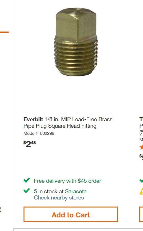

                  Home Depot has them in square head. Got a hacksaw?
                  Capture-plug
