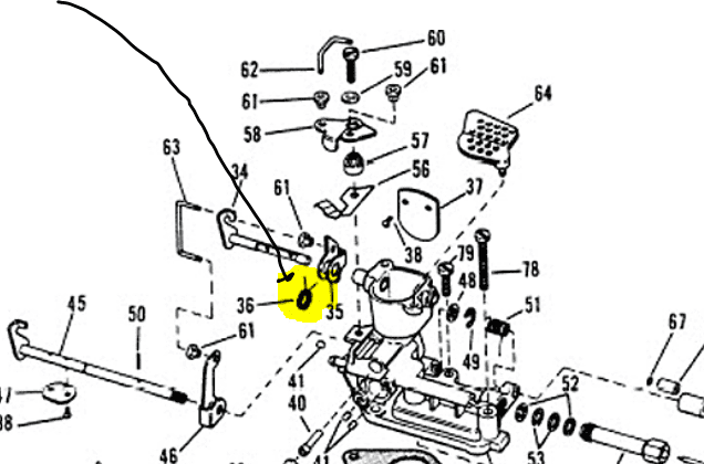

      any hints or special technique to form small springs from .029″ inch piano wire….??

          my 9.5hp choke plate needs a new spring

            Wire 0.029 is pretty heavy piano wire. What is the proposed spring to be used for? And .. what size spring are you hoping to make?
            As for actually making springs from piano wire, not a problem, just a cold forming process. Of course some trial and error may be involved as there will be considerable “spring back” after forming on whatever mandrel one uses. You will find that the mandrel size will have to be considerable smaller than the desired finished spring size…. trial and error.

                        JOECB ….when I measured the choke plate return spring on my MQ 9.5hp …..it measured .0255 I did not want to go smaller and .0255 was not available where I looked
                        so I went .029
                        yes it is a bit bigger …but I am confident I selected a good size that will do the job I need it for .
