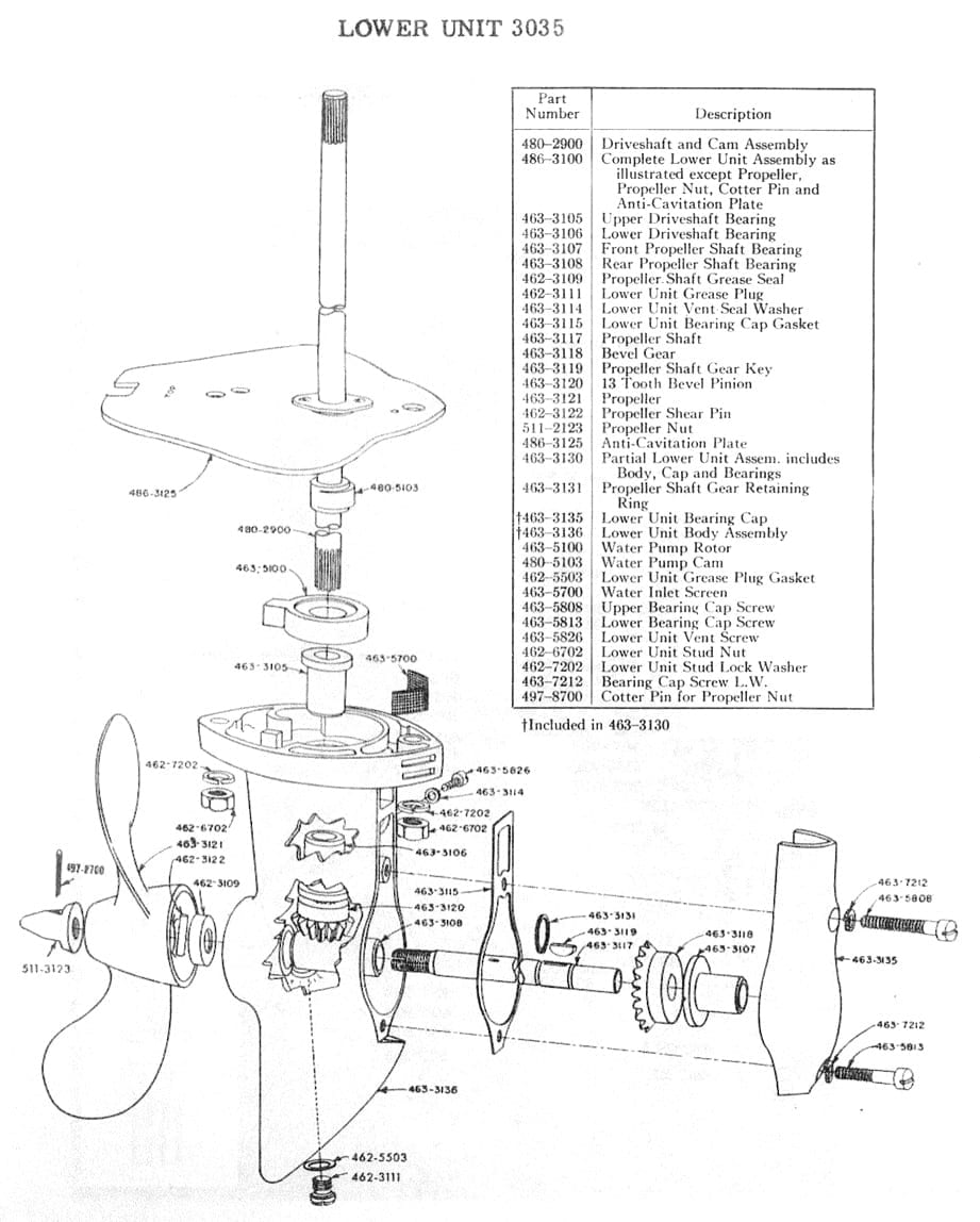

Regarding gear case I only see one nut under cavitation plate. There is no spring clip as I have seen on other old motors I have messed with. How do you get the lower unit off?

RalphMarch 10, 2020 at 8:51 am #197084It’s a 1957 by Scott-McCulloch. Does it have a shift? This is as close as I have (1953 non-shift). As you can see, take the front cap off to access the second nut.
