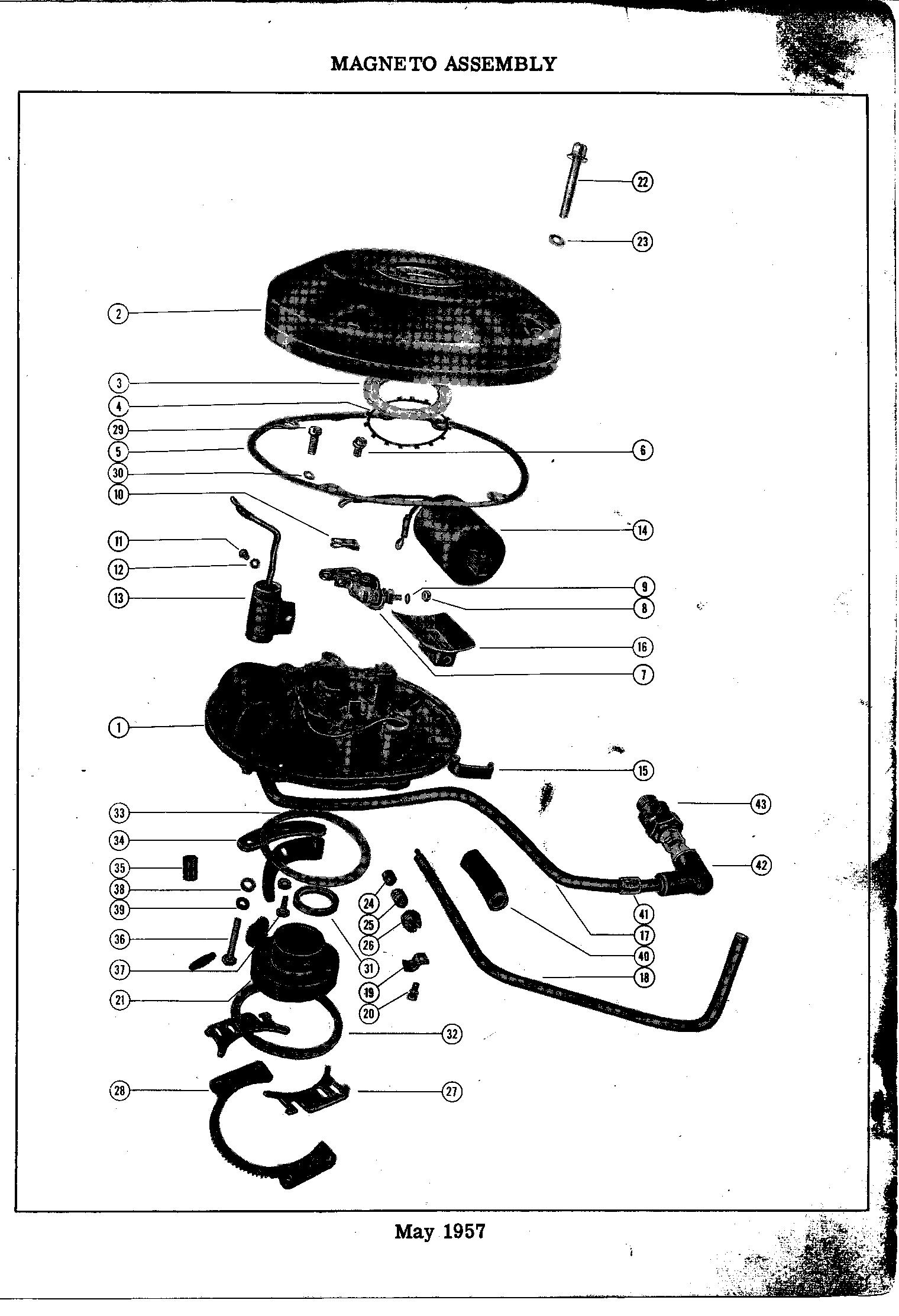

      I replaced the condensers, disassembled, cleaned and polished points, replaced plug wires, sealed cracks in coils with corona dope and checked resistance between coil and plug wires as 4.3. Checked air gap and cannot get a spark. Think the coil is too weak? points bad? Scintilla bendix mag. Something obvious. With this type do I need the flywheel on when I spin it?

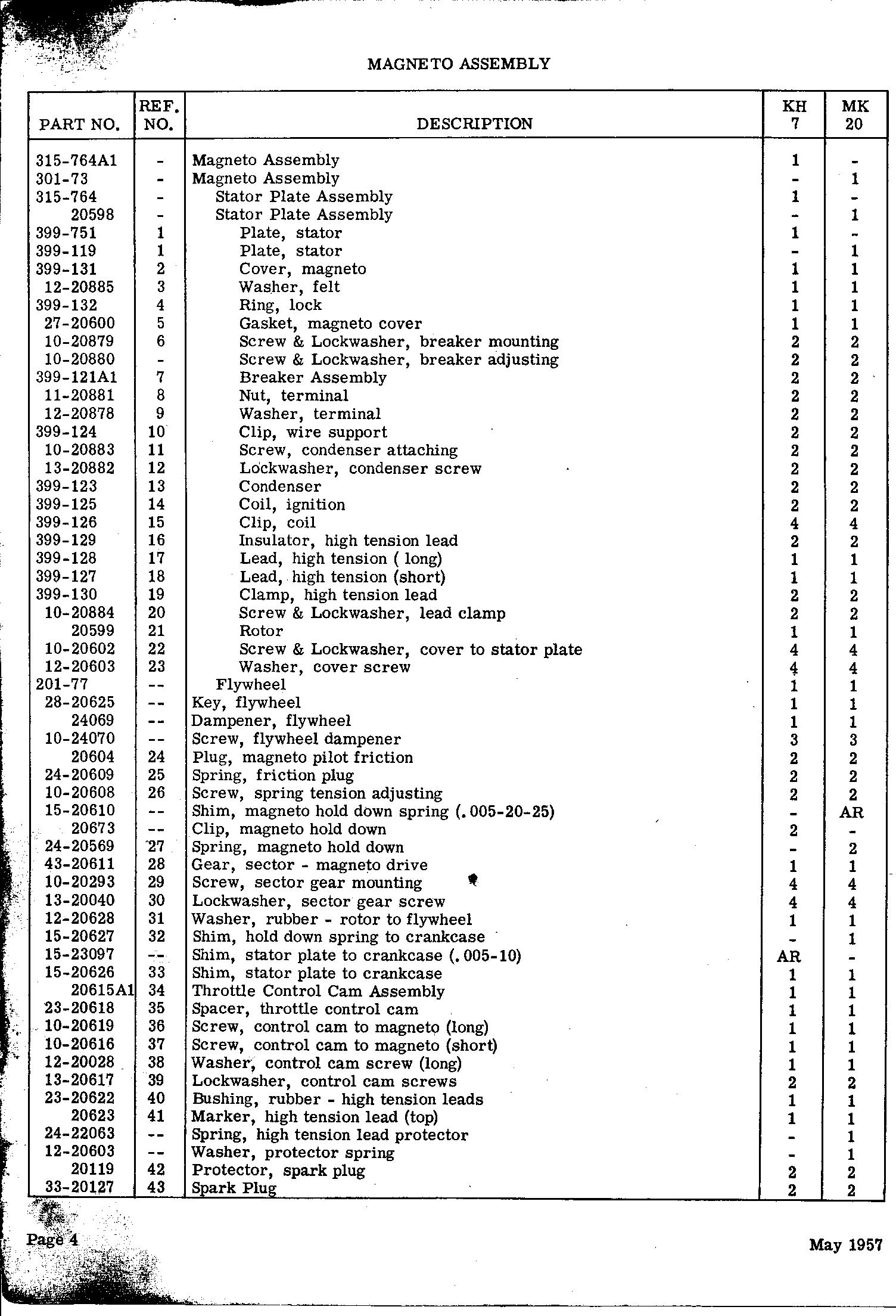

          Mark 20 has magneto 301-73. Cam is on magnet rotor

              0.020" for new points and 0.018" for used points seem pretty much the rule for Bendix
              Repco/Phelon, Wico and Eisemann magnetos.
