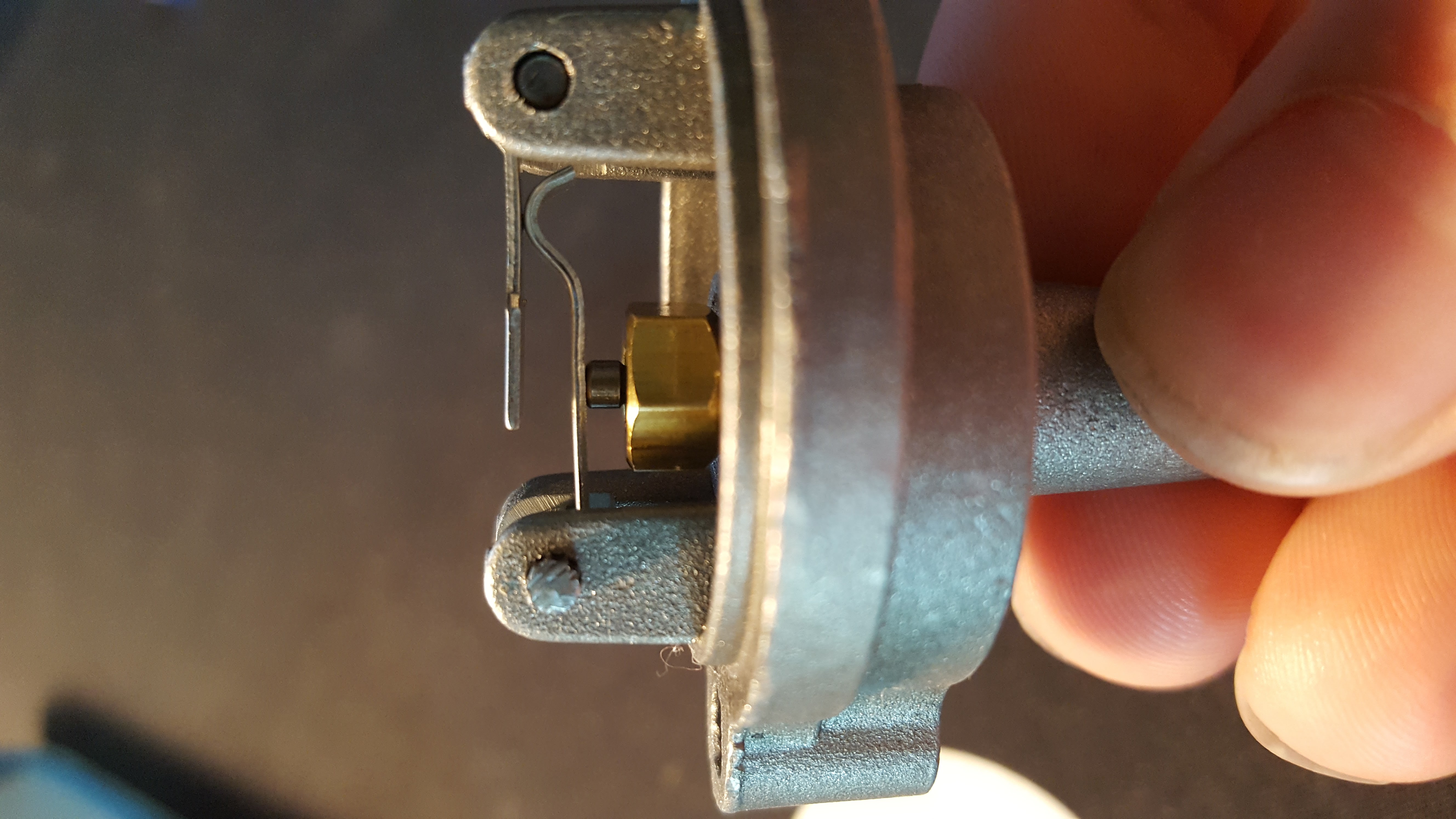

September 21, 2017 at 6:03 pm #65203September 21, 2017 at 6:16 pm #65204looks a little high bend the one touching the needle till the top one is level. don’t press it as in the pic just turn it upside down.

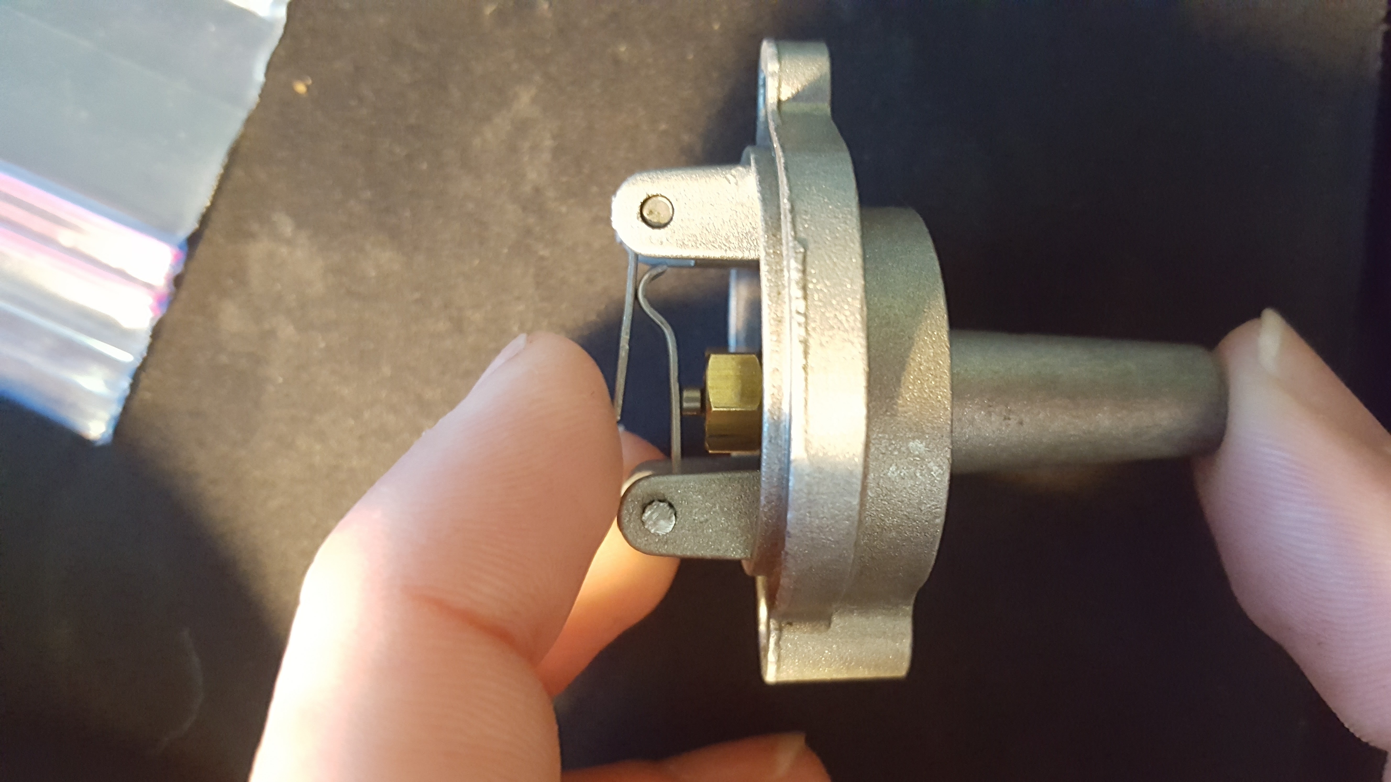

September 21, 2017 at 6:33 pm #65206ok i bent it
September 21, 2017 at 6:34 pm #65207September 21, 2017 at 7:01 pm #65208Looks good now.
