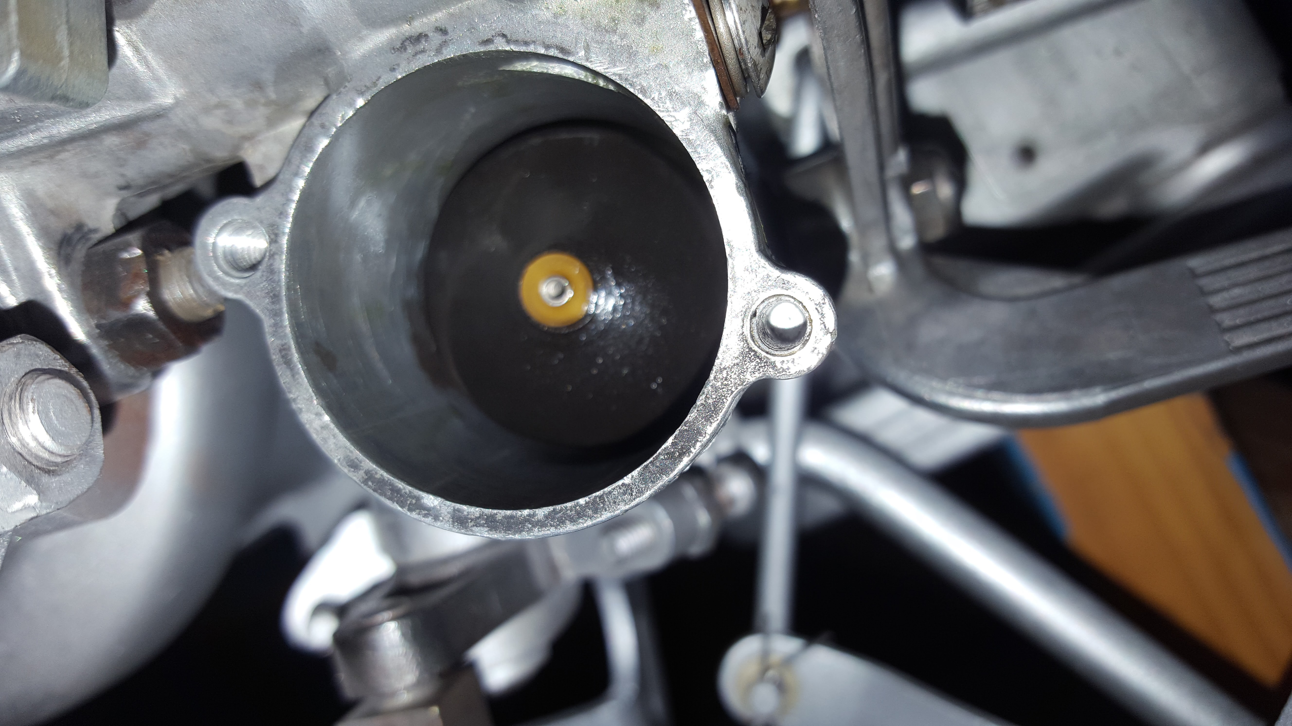

        cheetahgod
          The carb is still spitting out gas and floods the engine when the pull start is pulled. I’m using a vented tank. What am I doing wrong?

          dave-bernard
            could be bad reeds. or bad fuel pump diaphragm.

            cheetahgod
              already replaced fuel pump diaphragm. Adjusted that level again but now not getting any gas. Also I can’t get the top cowling off because one of the n nuts keeps spinning with the bolt.

                cheetahgod
                  IT WORKS!!!!!!!!!!!!!!!!
                  but something wrong with throttle on carb
                  #65228
                  cheetahgod
                    the fuel line thing that connects to the top of the carb was blocking the throttle.

                      cheetahgod
                        The throttle on the carb is bent slightly. Is
                        this normal?
