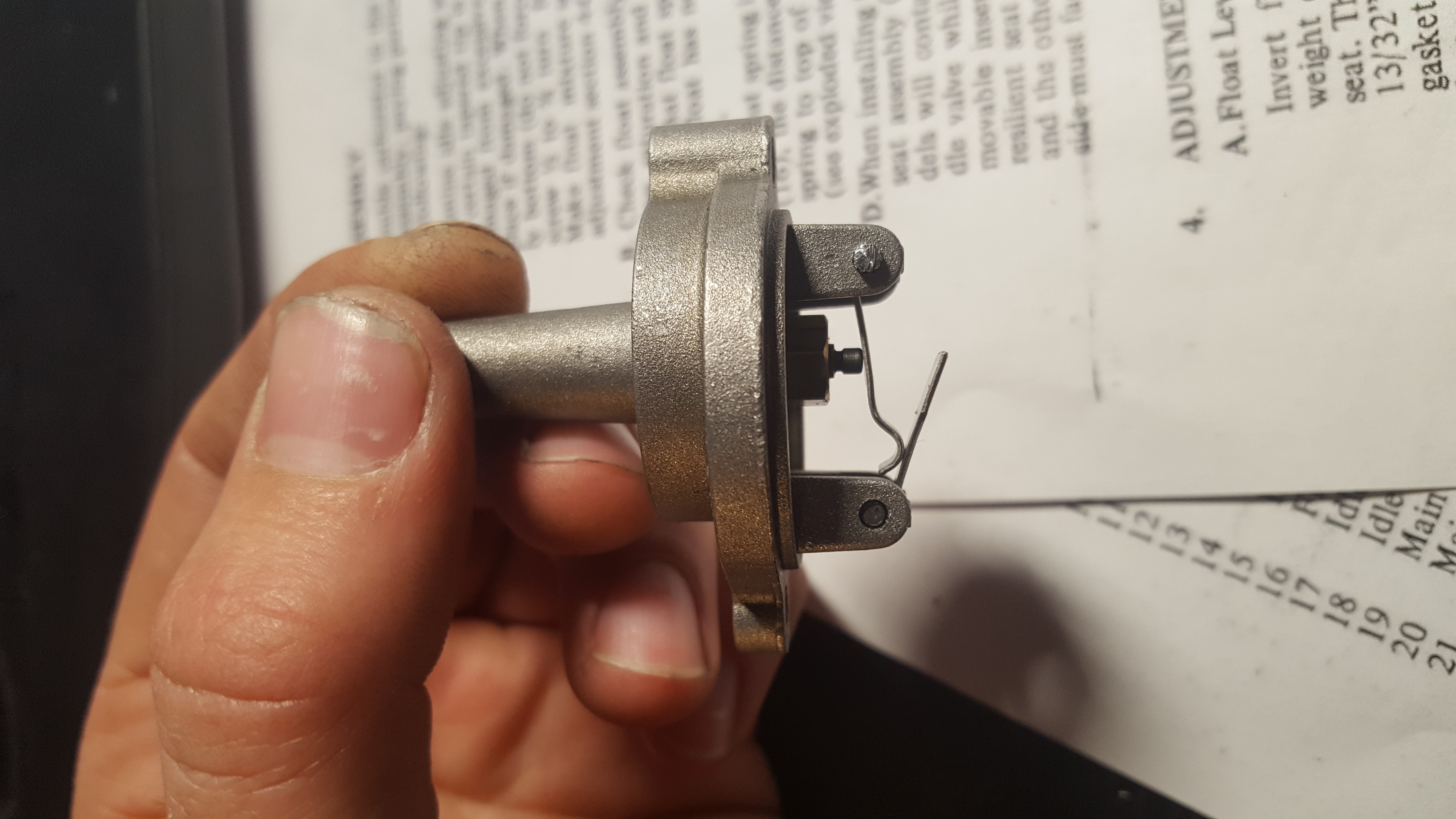

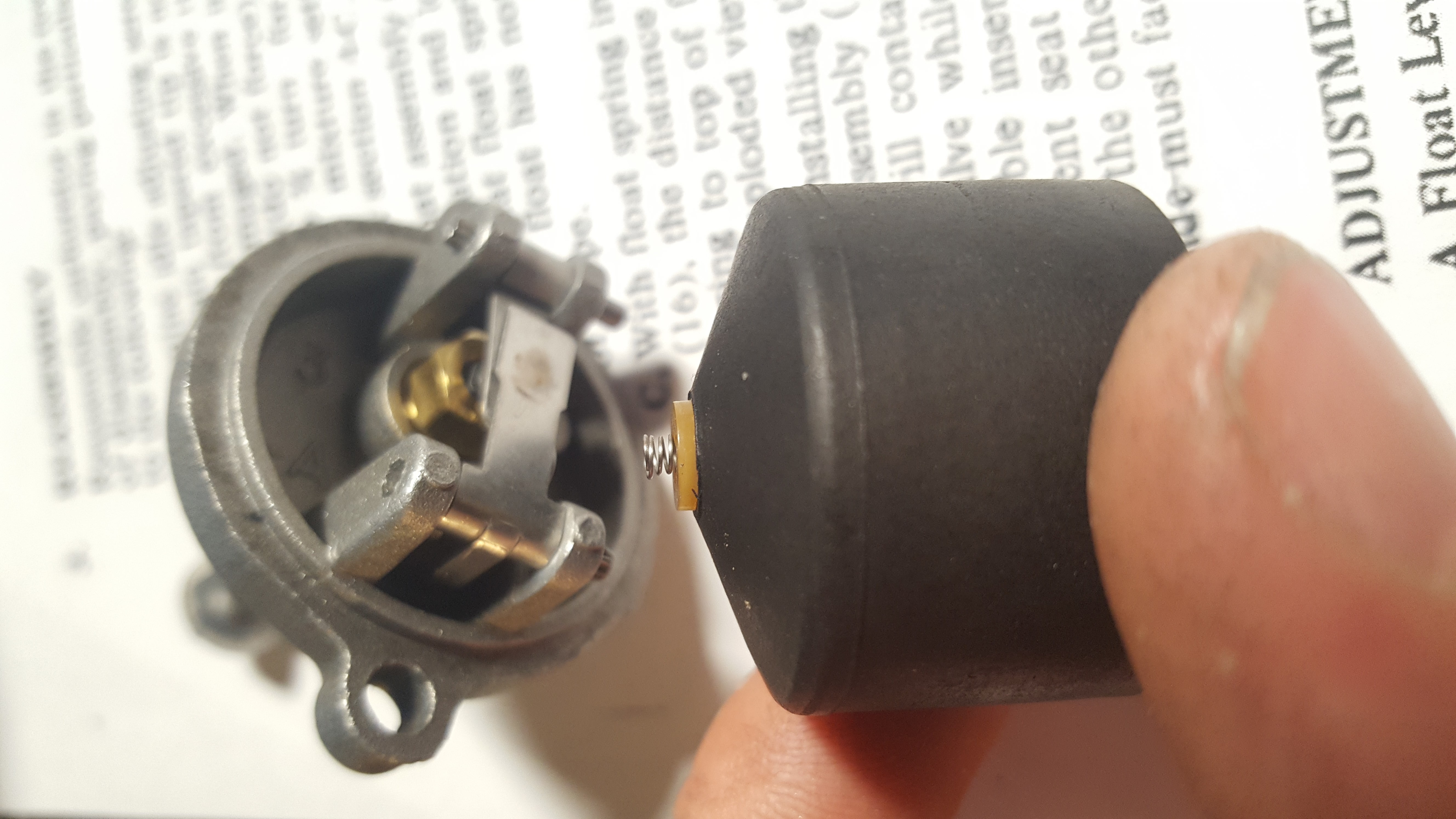

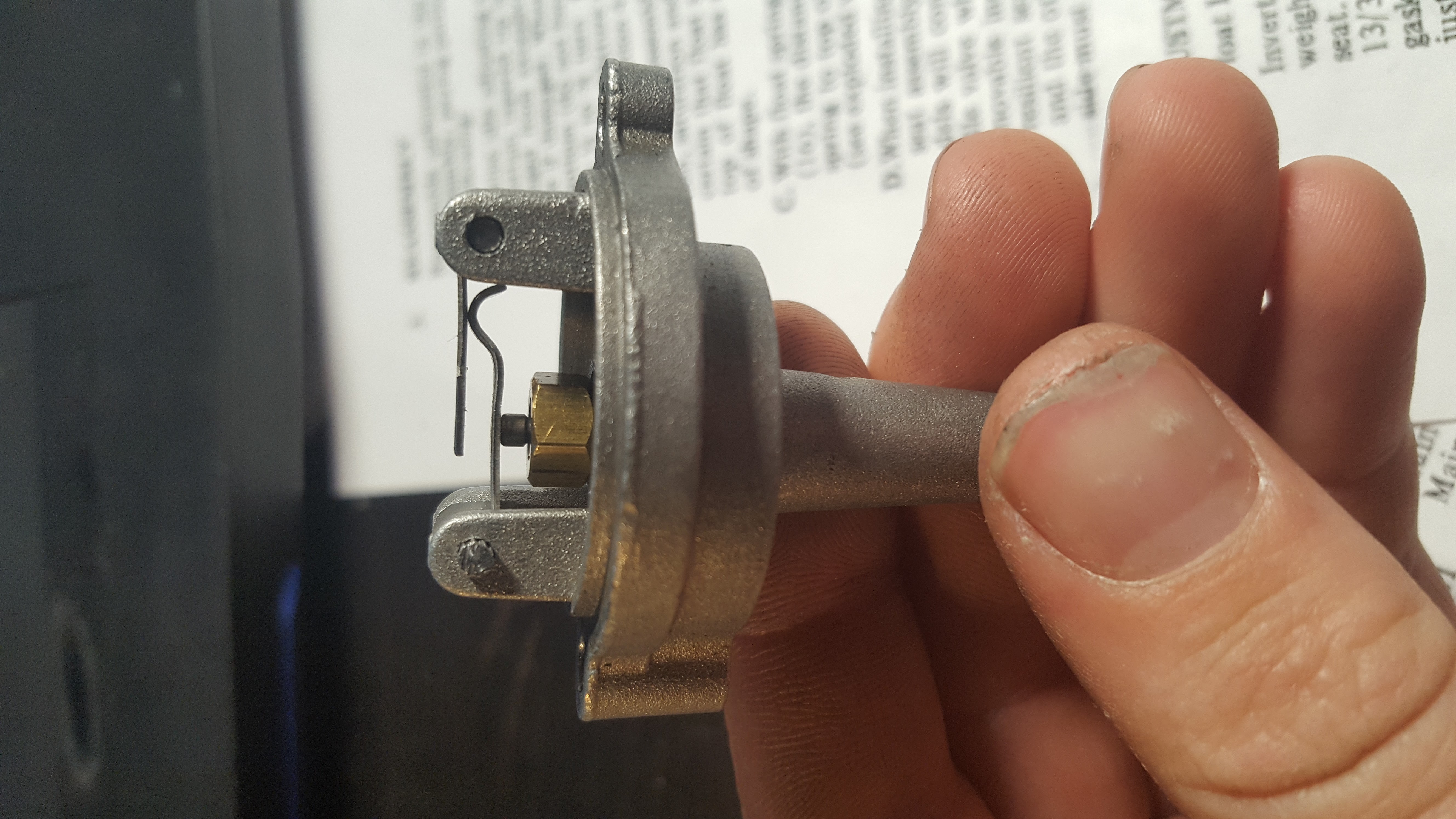

            cheetahgod
              Thanks Dave
              I adjusted float lever several times and was still running Rich. Adjust carb spring and now it’s running too lean
              #66888
              dave-bernard
                check seals and intake port gaskets
                #66901
                jeff-register
                  Any failure in the fuel system, if not corrected will bite you. They MUST be very clean. You found the weak link. Replaced the needle But did you set the float correctly?
                  #66902
                  jeff-register
                    I assume before even trying to start " tinker toys" has already been there & inspect,
                    #67117
                    cheetahgod
                      What do you think?
                      #67127
                      jeff-register
                        that’s an easy one, The float or needle need to be checked for level & drop, You are now delivering fuel but found the weak link. Merc’s have close tolances to run right. That’s what I liked about them, a challange! 😯
