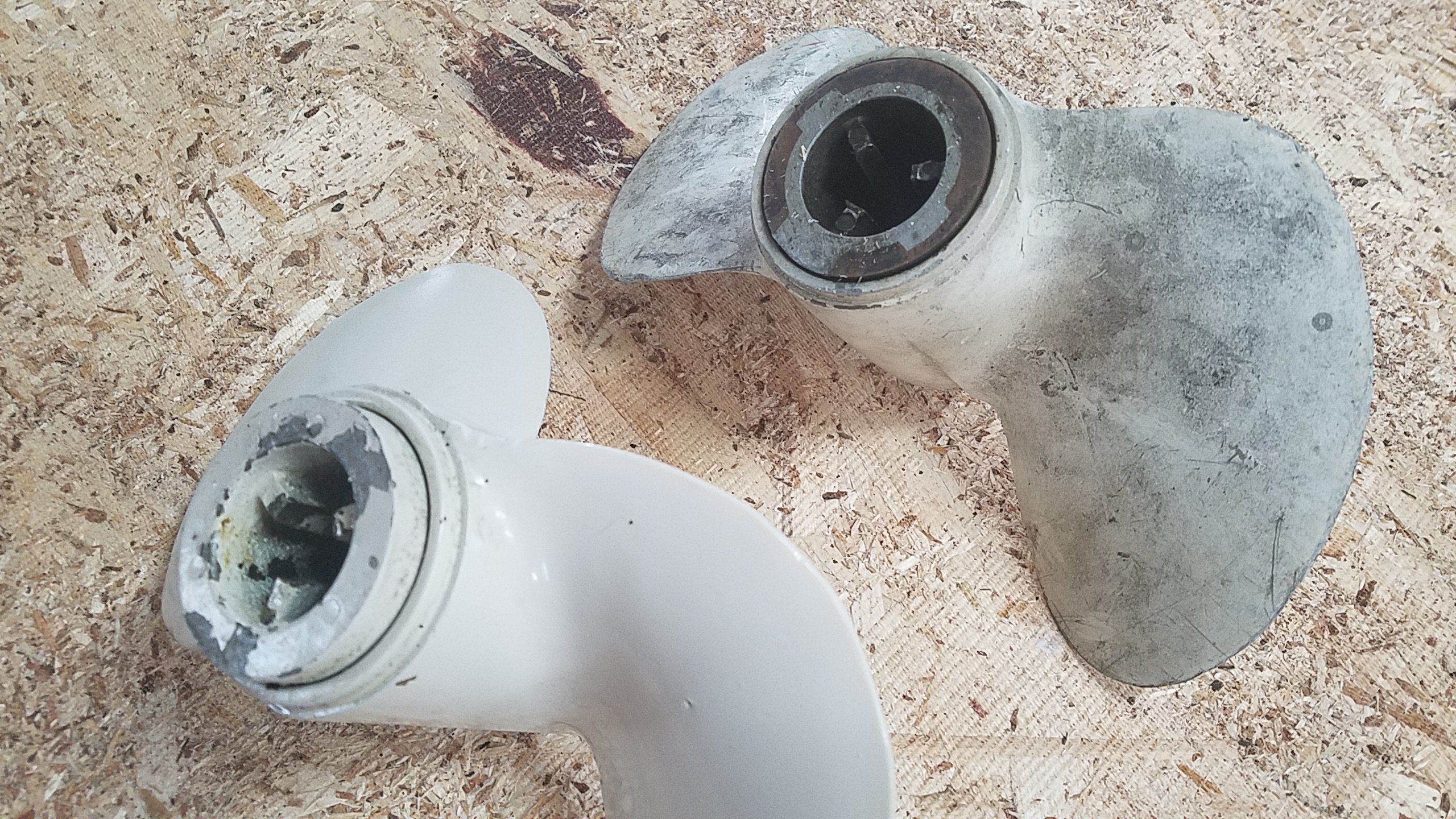

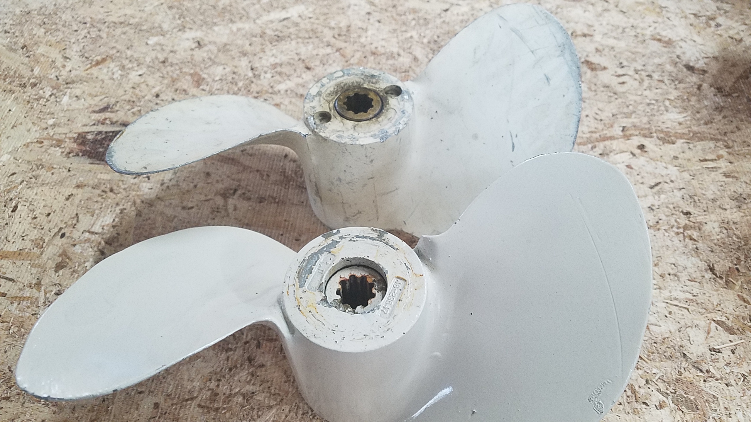

      I have 2 props for a Mark 25. One has the hub sticking out further than the other. The one sticking out seems wrong as it does not fit right. I have tapped on the hub with a punch and hammer but the hub does not move. I don’t want to pound too hard and damage something. Are these pressed in? Do I need a press to fix this one? Should I just hit it harder? What is the correct way to fix this?
      Thank you for your help.
      Bill

        The one has slipped. Dave McKinney has the parts to repair these props. He is in Gainesville GA.
