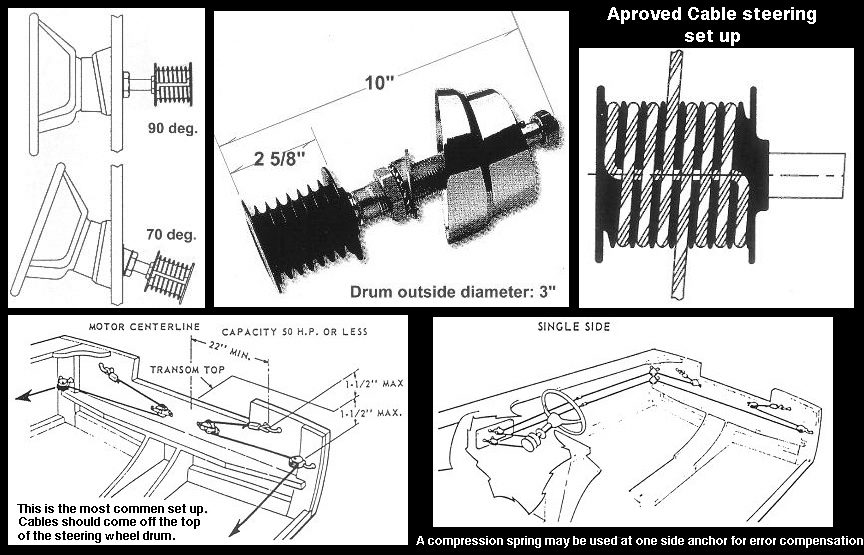

      Can someone send me a picture of a mk 25 on a boat set up with remote steering. I would like to see how steering cables are run with the pulleys
      #68180
        from the corner pulley to pulley on the front of the motor back to the corners with springs
        #68181
          This diagram might help.
