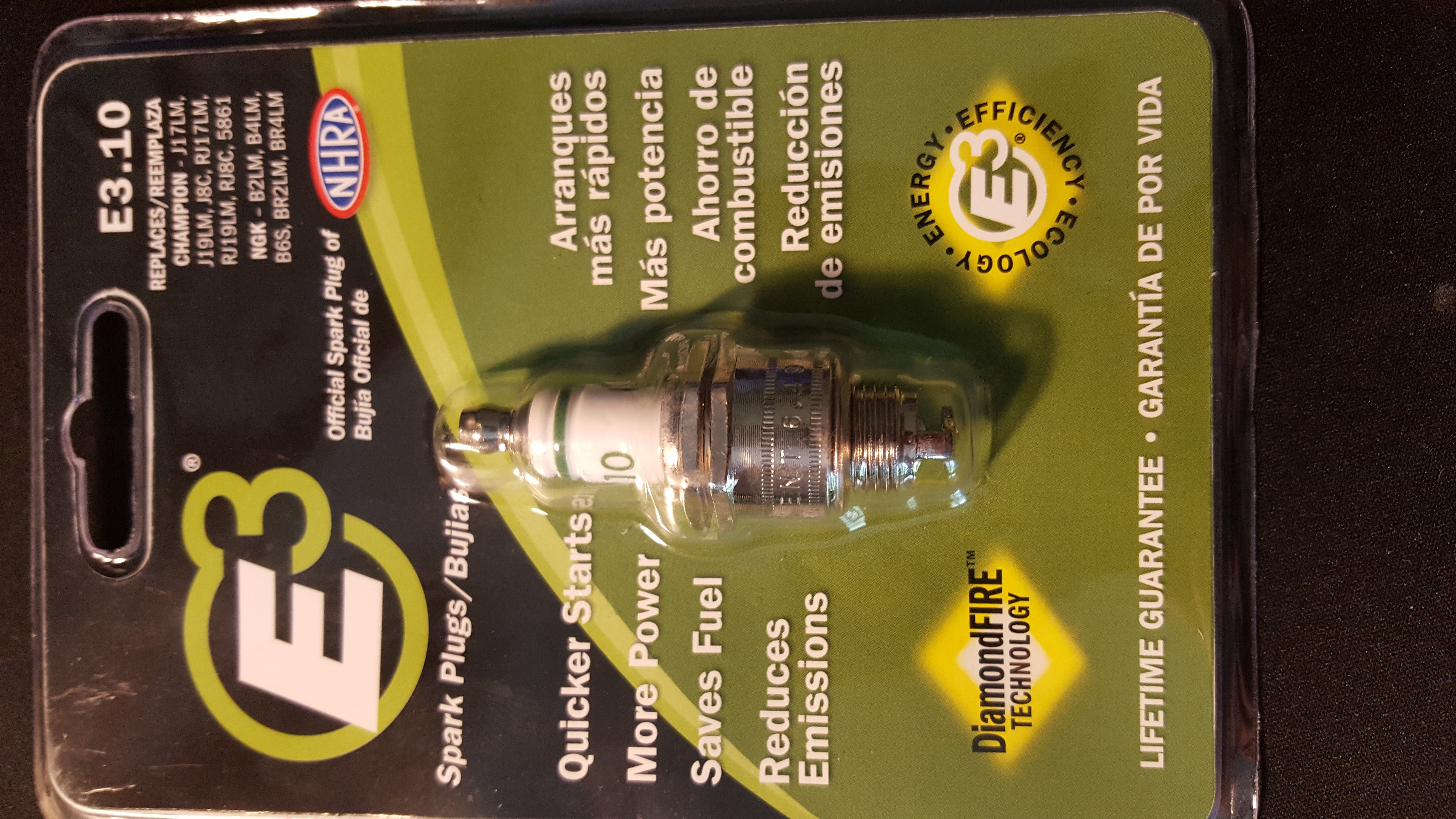

I just went to their website as I had not seen these before. Looks interesting, but I will stick with NGK’s for half the price and a good track record.
July 12, 2017 at 9:33 am #61460A recent campaign comes to mind…..A lot of great promises but nothing but BS.
July 12, 2017 at 9:35 am #61461Agreed, stick with correct NGK for your engine these E3 are hype. I have seen these and other multiple ground plugs before, "More Power", "Saves Fuel", I doubt these claims unless previous plugs were worn, ignition system not tip top shape and the engine was not delivering. Regardless of multiple ground electrodes only 1 will fire at a time and which one is random and depends on voltage needed at each ground electrode (and it will be slightly different). If ignition system is in tip top shape it can only produce so many volts (independent of spark plug type/design). What the engine needs to ignite the spark is designed to be less than what the ignition can produce, the difference is "ignition reserve". As spark plugs wear out (and ignition system wears) the reserve is reduced and if really worn no reserve left and engine operation problems. More reserve is good and spark plugs will not increase the reserve. A tip top ignition will give the most reserve it was designed for to light the plugs.

July 12, 2017 at 4:28 pm #61478Some years ago I bought a ‘disposable’ lawnmower; very cheap, Chinese-made, extremely difficult to service. The thing requires some kind of oddball spark plug and the only one I could find after going to several stores, including where I bought the mower, was the E3 equivalent. The mower starts, usually on the first pull and purrs like a kitten. So I’d have to say that brand has worked very well for the lawnmower application.
