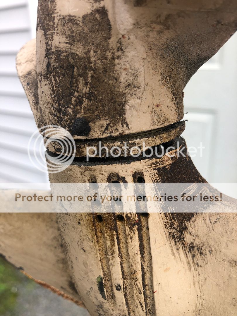

      i just picked up a real nice mark 6 super silent, just noticed the lower unit is split would anyone know were i might find one? and will a mark 5 lower untit work on it? thanks all

        Yes the MARK 5 will fit. the KF5 wont. got a pic of the split may be repairable.
        #260429
        Joe Mott
          yes sir and thank you, what do ya think? its a super silent and id love to get her going    https://hosting.photobucket.com/images/v368/fishguts1/IMG_6232(2).JPG

            sorry this link should work to the pic of the break

            #260432
              remove the broken part. and should be able to get it working. there will be a space but will work.
              common problem.

                #260466
                Joe Mott
                  it worked out perfect for me, i had to cut down the spacer with the seals on the same amount that broke but it worked perfect!! thank you soo much!
