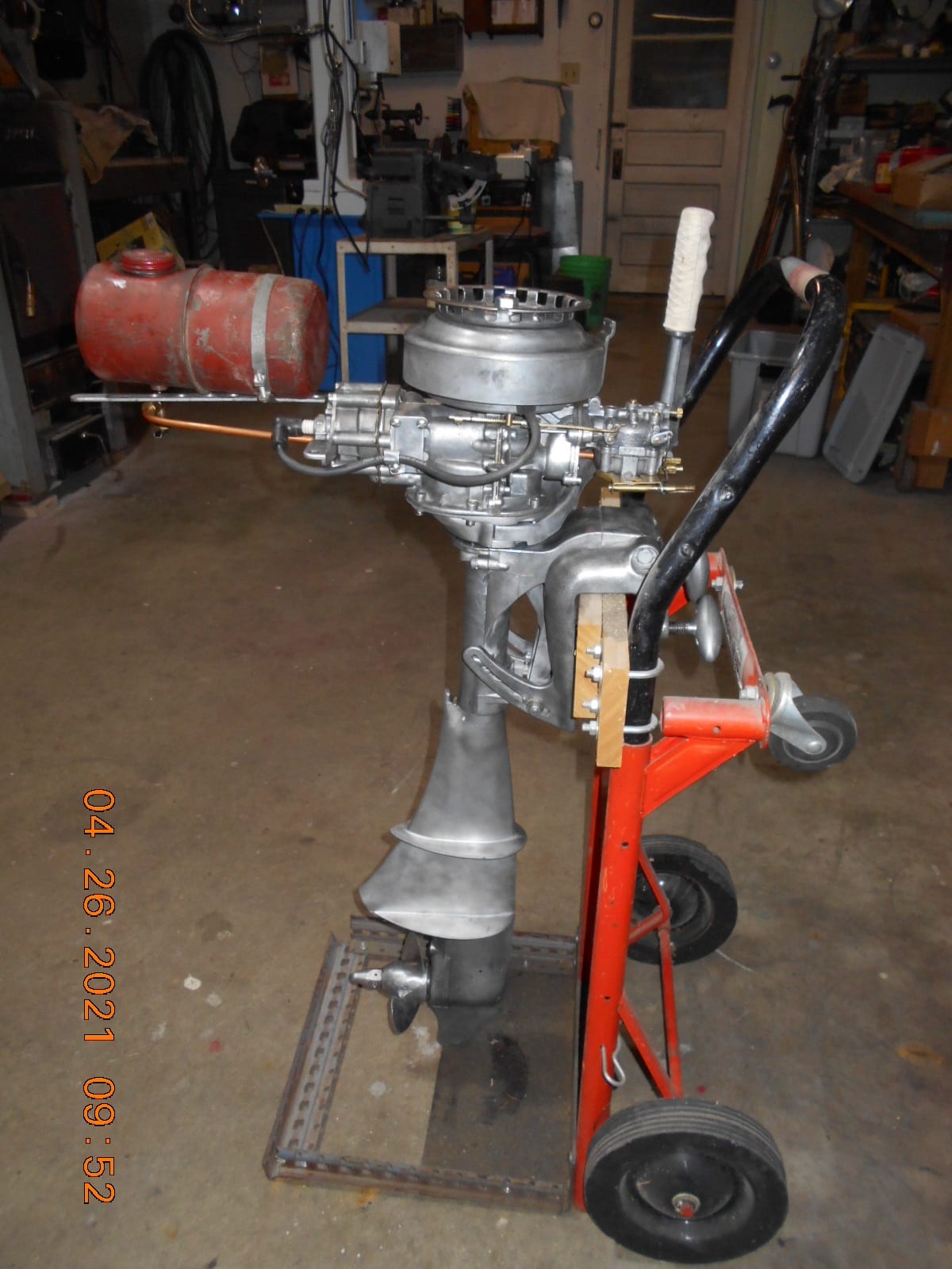

      Yesterday I tried starting the little Martin 20, 2.3 hp motor I’m going through.
      Before I tore it apart it tested at 75 psi compression. I reused the original
      rings, but did give the cylinder a very light hone with a ball hone.
      Honing showed a little cylinder imperfections, but not “bad”.
      I could only get it running yesterday “out of water” and using a drill.
      I retested the compression today, and it showed 100 psi using the drill,
      and 90 psi with three rope pulls.
      Surely 90 psi should make a runner….. or not?
      I’m not used to working on this little of outboards. What’s considered good
      compression on these? I believe it has a 1-9/16″ bore.
      I did discover today that I had the old original J-8 plug in it, and only
      finger tight, so I changed it out with a new J-8C, but I have not
      tried to restart it yet….. weather is gloomy.

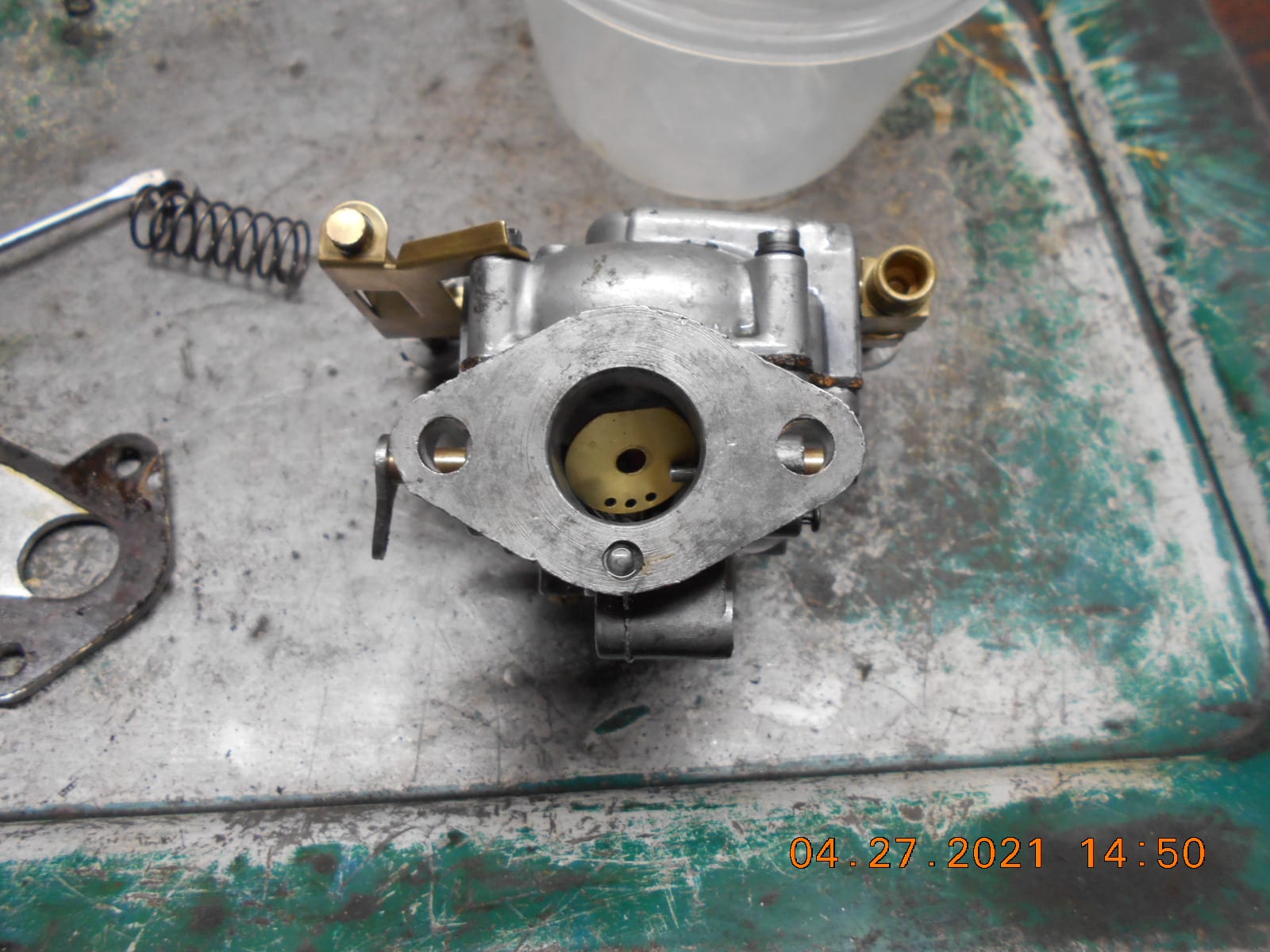

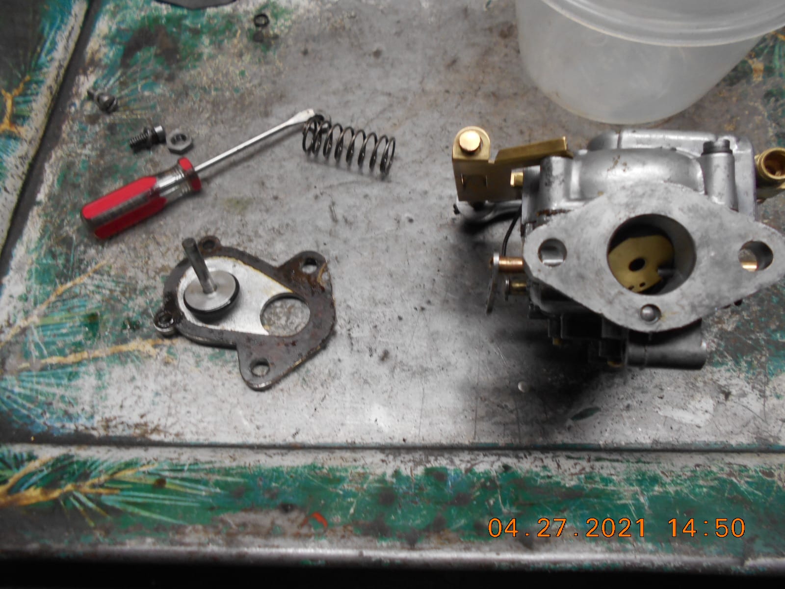

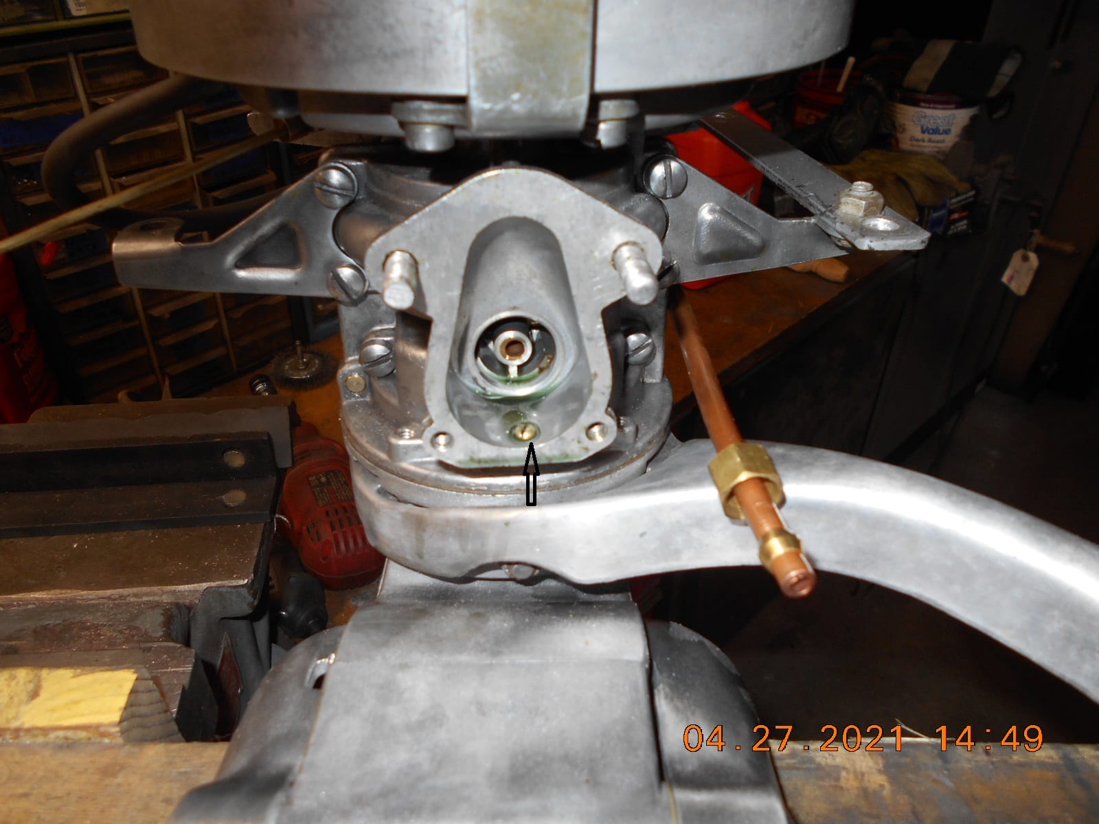

            Yesterday when running it I got my glove between the mag advance lever
            and flywheel. Mag then slammed the throttle shut and it was “out of sync”.
            I thought it was just the little set screws locks that slide out of whack on
            the linkage, but found out today it broke the head off the throttle plate
            screw, and the throttle plate was flopping loose inside the carb. Luckily,
            the brass head did not make it through the poppet valve!
            I put the hand lever on the mag plate advance today, and did not wear gloves, lol.
            Running wide open here. It will only start in the water with the drill. Will
            rope start when it’s “out of water”. Guessing my 90 psi compression
            isn’t quite enough for this little motor. It likes a quick choke to start,
            even when warm.
