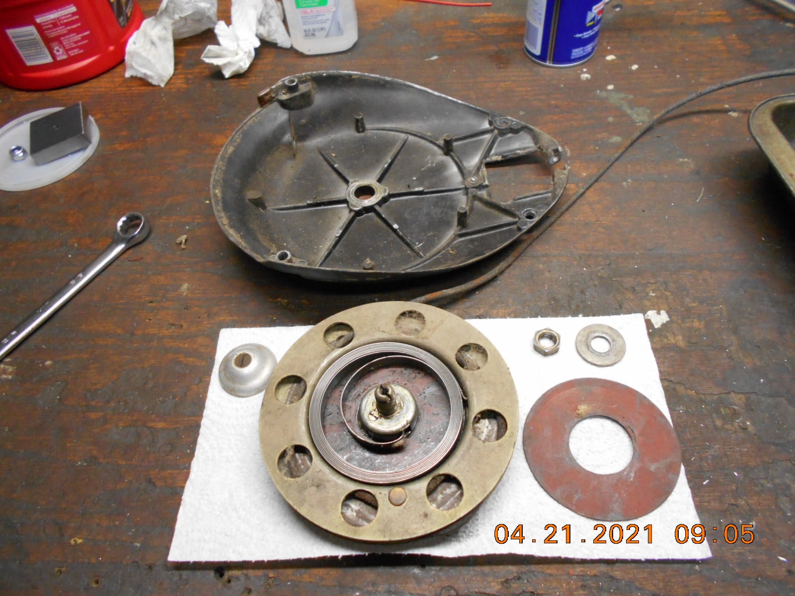

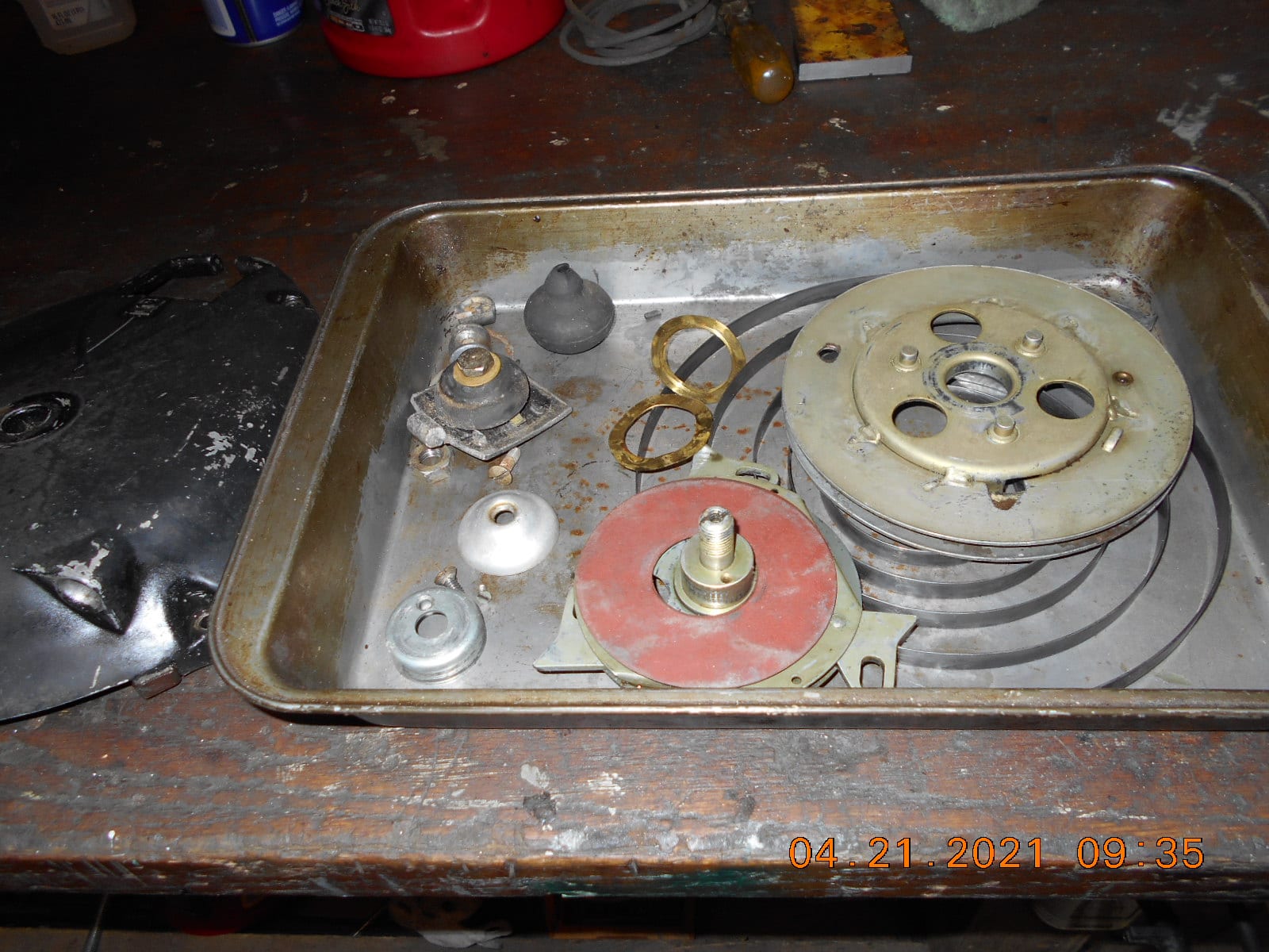

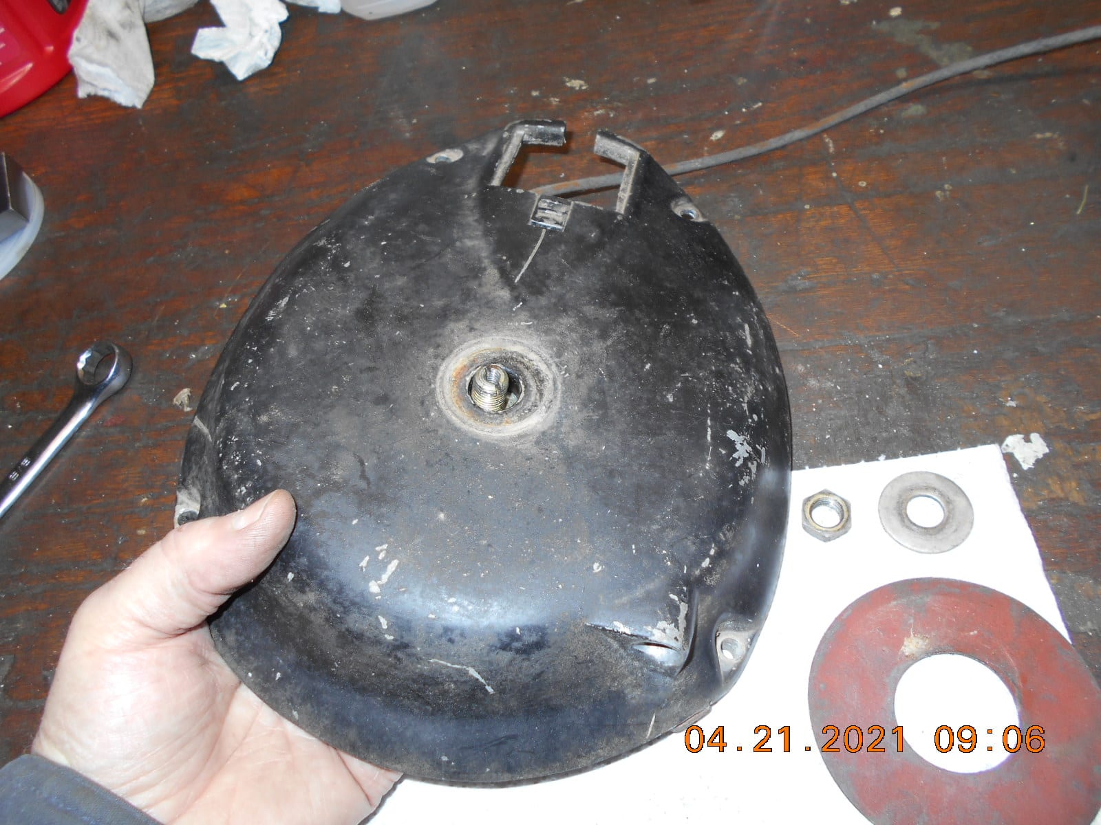

      Is there suppose to be a bushing of some kind on the center stud of the rewind,
      where it goes through the housing? In the one photo you can see how sloppy it is.
      My only thought that perhaps it’s designed this way so one can “center” the rewind
      guts in the flywheel cog wheel.
      I looked at my parts pdf, but can’t tell for sure in the photo.
      Thanks.

      #236776
      JOHN D.
        Use a 1/8″ rod or drill bit to line up it up with the flywheel. No bushing there.
        #236779
          what jc said. A rod through the center bolt, into the counter bore of the crankshaft.
          #236797
            Thanks for the suggestions. I’ll look this morning, I didn’t realize the bolt was centered
            drilled all the way through!
            On certain snowmobiles of “old” I use to engage the dogs into the ratchet cup on
            the crankshaft by pulling the rope, with the rewind housing bolts loose, so the
            rewind would “self center”, then tighten down the housing bolts.
