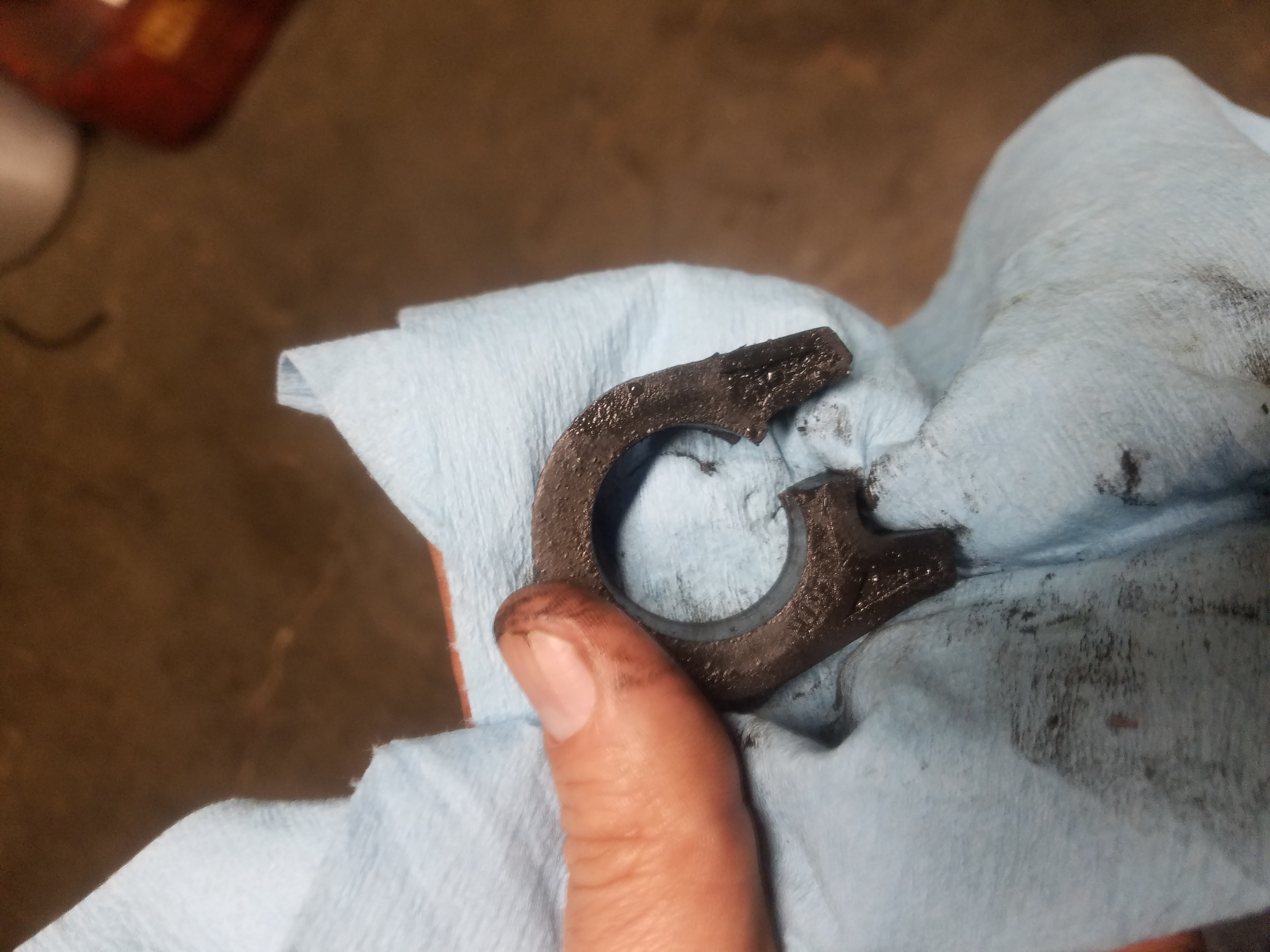

                  Got a new shipment in from Larson’s today. New pump rotor and pull cord knob among other things. I am not familiar at all with this type of water pump. I took a picture of what I assume is the exit for water leaving the pump. It appears to be totally clogged but I wanted to check with people that know before I start poking holes in things.
                  #74297
                  bullie
                    Finally got this one going tonight at about 9:15. I got excited enough to get the wife off her chair and outside to see it run. It got a bunch of new parts and it’s running good and running cool. I need to adjust the carb a little more but I think the off and on battle with the little Martin is finally drawing to a close.
