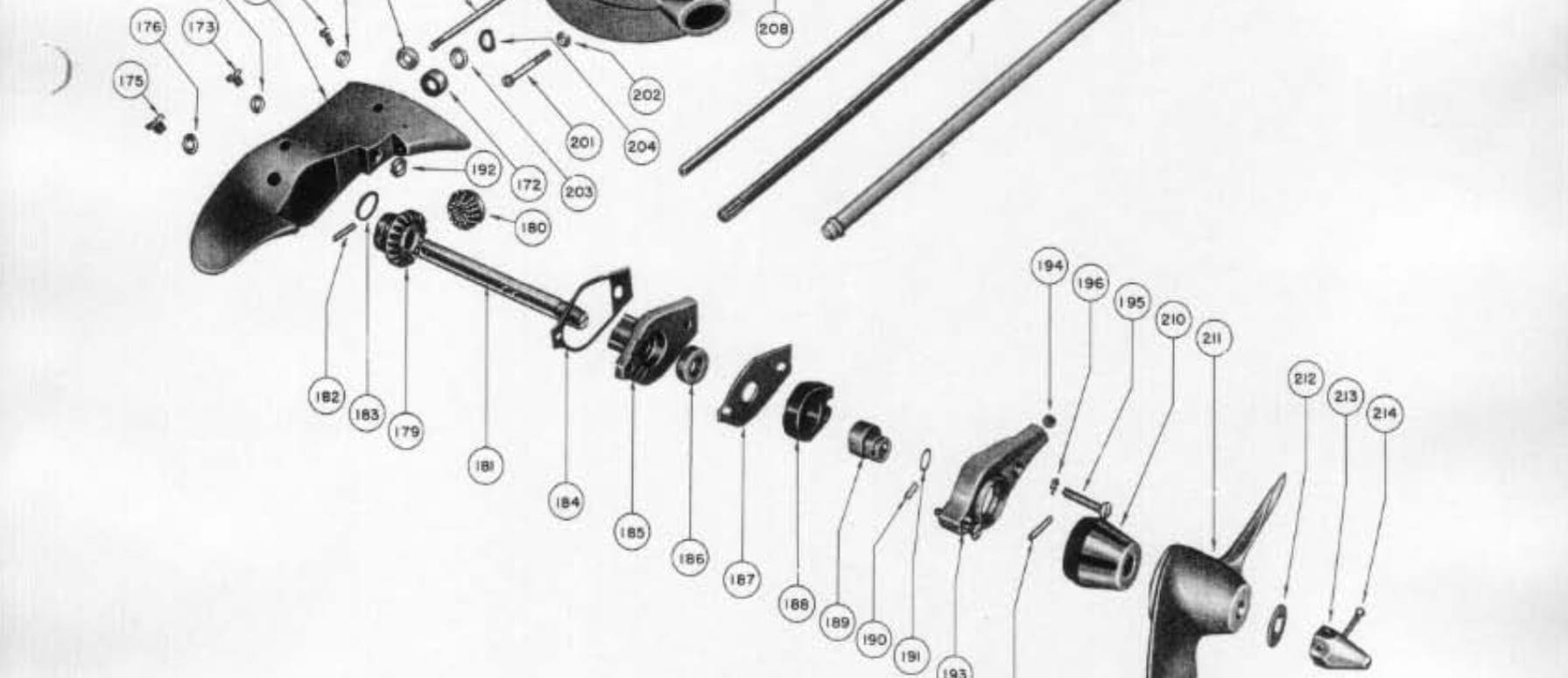

        Perhaps this photo, assuming it’s what you have, will help visualize the problem
        for others to diagnose. I’m not seeing any thrust washers that may be missing.
        How much back-lash are in the gears?
        martin-40

                Is there anything on the driveshaft, such as a pin or clip through, or at the pinion gear
                that prevents the driveshaft from riding on the gear case, causing the flat spot / wear?
                As the gears wear in over time, I assume the driveshaft would drop down slightly.
                This wearing in of the gears will cause excess backlash, which is sometimes
                adjustable by shims or other means.
