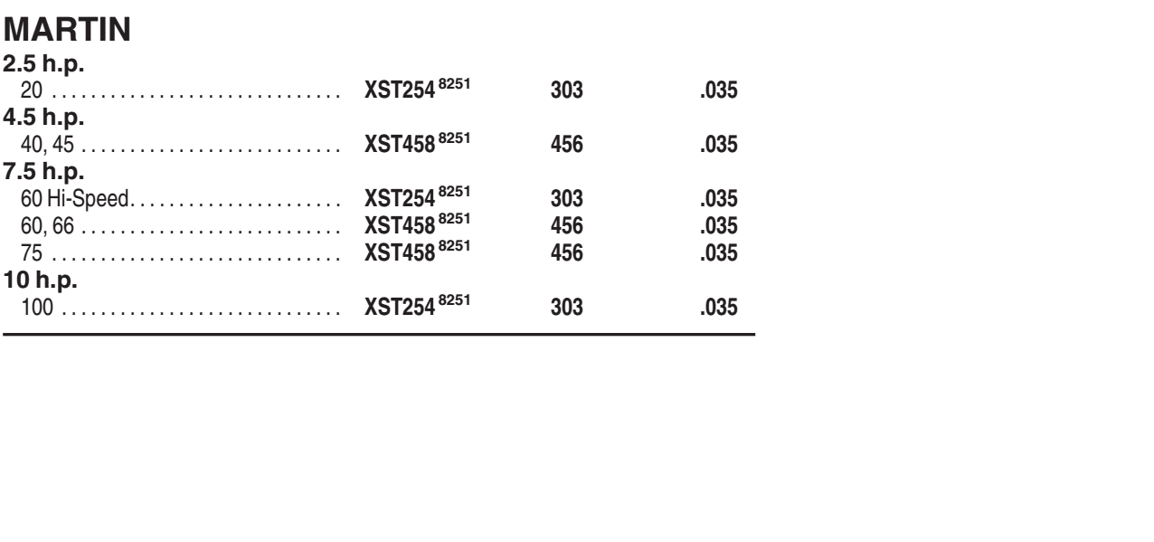

      I picked up a 1950 Martin 60 and waiting on a few parts. I cant find what the spark plug is supposed to be for it. I saw one place that had a Champion j8c listed but not sure if that is the right one? It seems to be in pretty nice shape for a 72 year old motor and hope to get it running!
      #258811
        These are Autolite numbers. You can cross reference them on the Net
        if you like champion.
        Martin-plugs
        #258818
        jimk
          Thanks! Looks like it will work as it crosses with the XST458. Dont think I need the high speed one. Autolite Isnt very common around hear. At least not like Champion and NGK.
