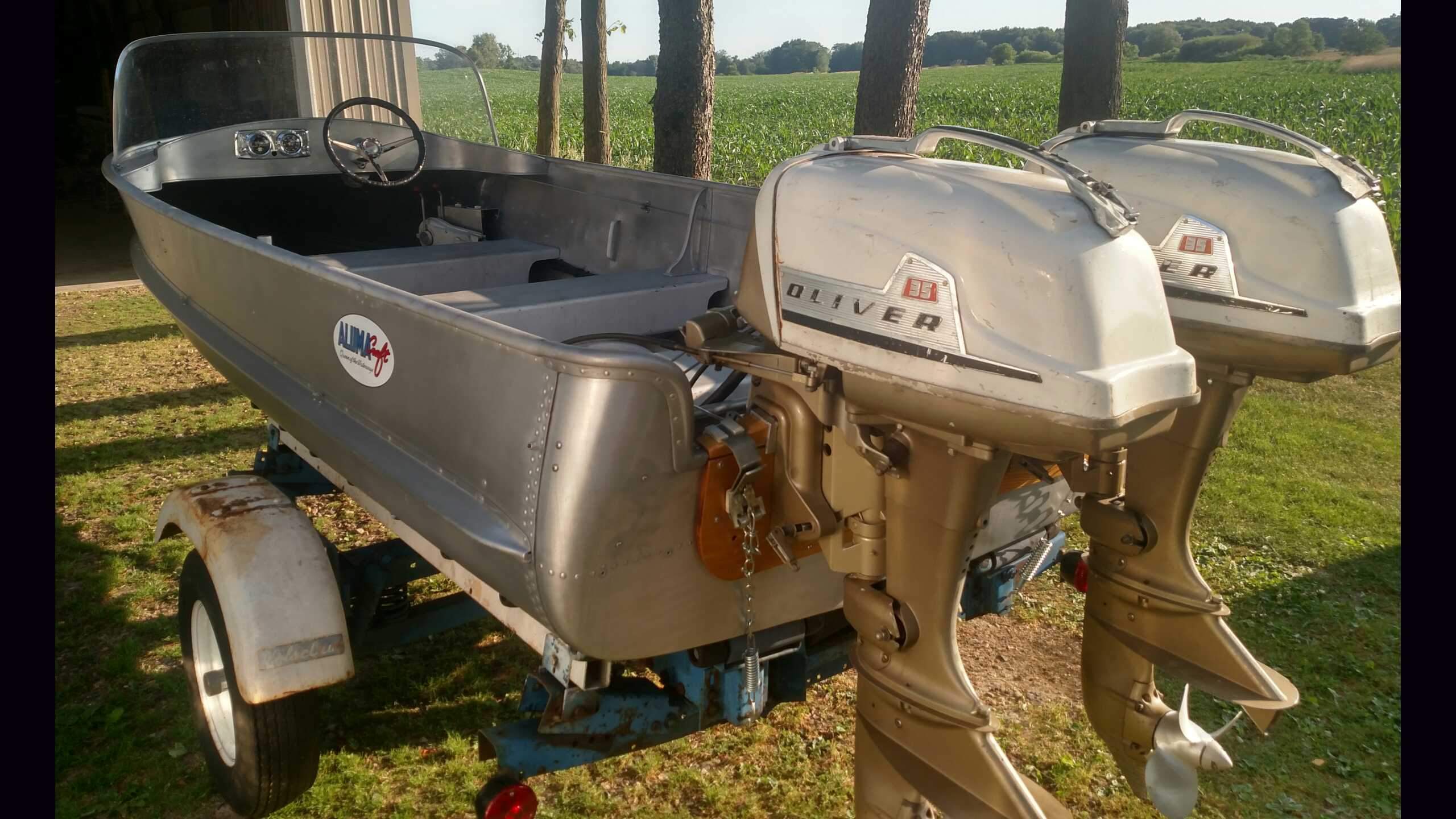

One other word of advice on the poppet o rings, they will be hard as a rock from age. I carefully cut mine free with a razor blade. Avoid the temptation to pry them off, as you will damage the valve.January 6, 2017 at 9:36 pm #50483While were on the subject of poppet valves, I was reading about the 35 hp Oliver Olympus outboard in the Old Outboard Book the other day. It seems after George Martin parted ways with the National Pressure Cooker Co. and left Martin, Oliver incorporated his Poppet design idea into the 35 hp. Oliver Olympus… interesting!
This rig belongs to Dan Soderstrom, the Oliver guy . -
