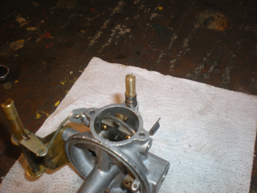

C. Try to remove the old needle.Pretending that this was the last Carter N carb in the world,
what way would you try to remove the needle?
Drill with a left hand drill bit?
Drill and easy-out?

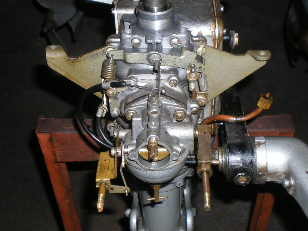

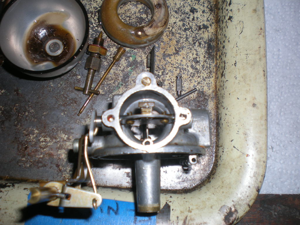

Other?Photos of carb with broken needle, and of other Martin carb
with what I presume said needle is suppose to look like!
Thanks for any ideas.Prepare to be boarded!
August 15, 2016 at 10:43 pm #42146I think it would be less confusing if you call the problematic piece the "needle" not the "jet."
Comparing the needle in the lower carb pictured can probably tell you how deep you would need to drill. At this point I would suspect the best alternative would be to drill out the needle to below the threads, and enlarge the hole as much as you can without drilling into the carb body. At that point the remains of the needle will hopefully fall out, and you can pick out residue and retap the threads. If you have access to left handed drill bits it would make sense to use them, as at some point the bit might catch and bring the remains out. I’ve never had much luck with EZouts but some people swear by them. this is a job that would be much easier with a mill and some small end mills, but should be doable on a drill press. Since you will still need another needle it might make sense to look around for another carb. (but, carbs often have subtle variations specific to the application…..)

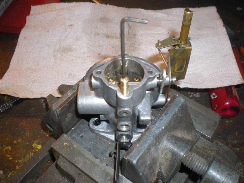

August 16, 2016 at 11:25 pm #42201Success! I drilled a small hole in the broken needle about 3/8" deep.
Then found a hexed Allen wrench slightly bigger than the hole and
tapped it down. Heated up the carb body with a propane torch
for a while and the needle unscrewed !

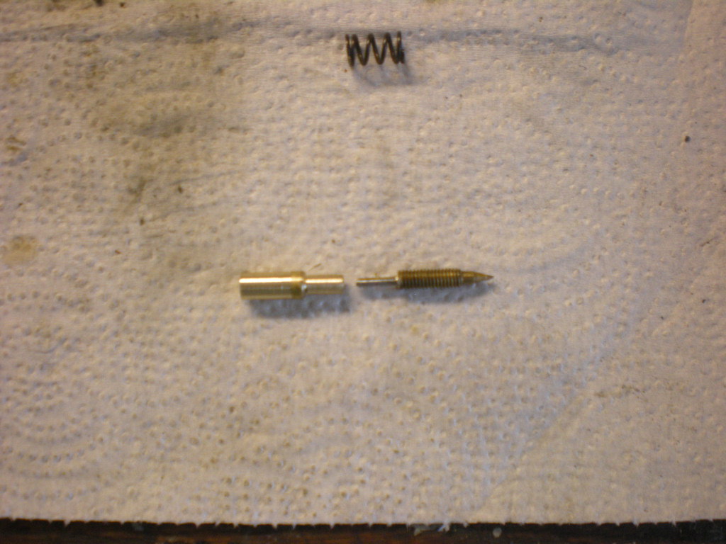

Having no new needle, I decided to fix the old one. Found some
small brass round stock, drilled the same size hole in it as the broken
part, did a little machining to make a shoulder for the spring to ride on,
then cut off the Allen wrench the correct length, put a little epoxy
in the holes, and joined the two halves together. Seems to work good!Prepare to be boarded!
August 17, 2016 at 12:59 am #42205Cool! Nice job Buc. Hopefully that epoxy holds. Looks like a good fix.
-BenOldJohnnyRude on YouTube
