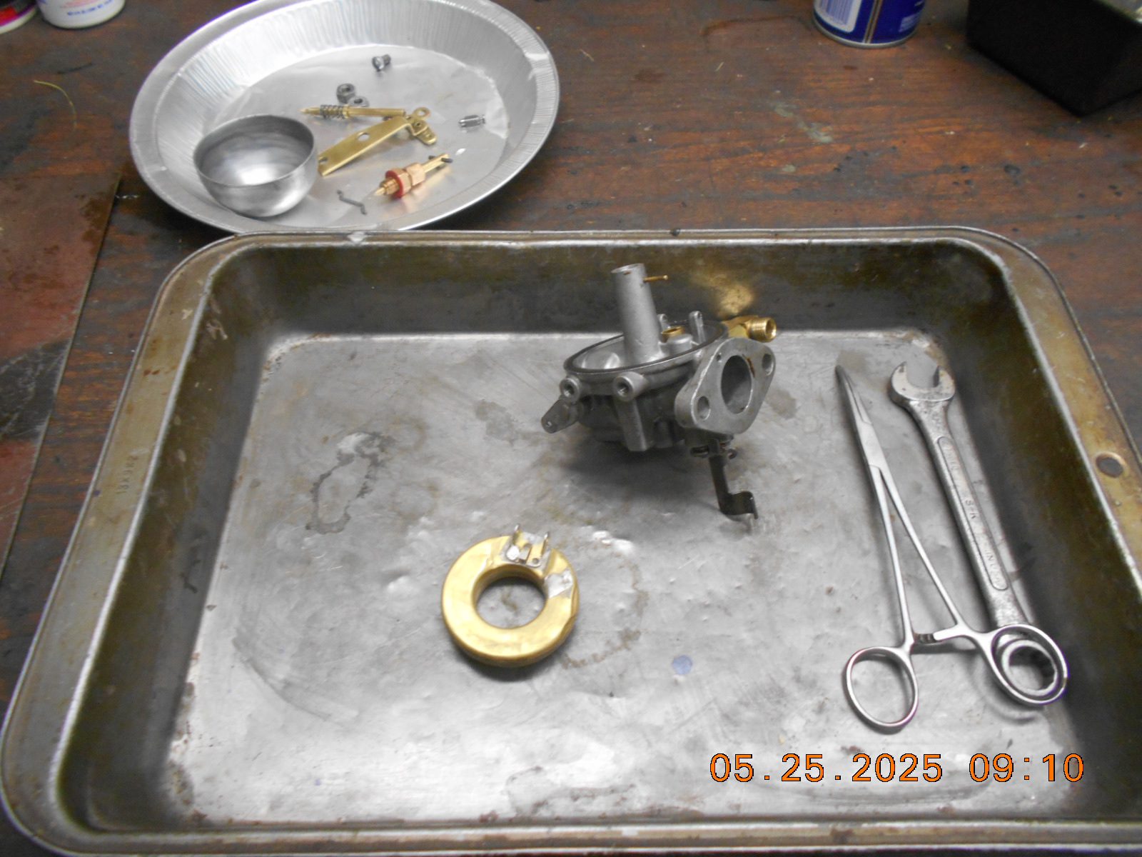

      Was hoping to take the newly “gone through” Martin 100 for a
      boat test by now, but for the last two weeks while working on
      the 1931 OMC 402, the Martin was slowly peeing gas down it’s leg.
      Couldn’t tell from where with the cowls on, and was somewhat
      perturbed about it, so no hurry.

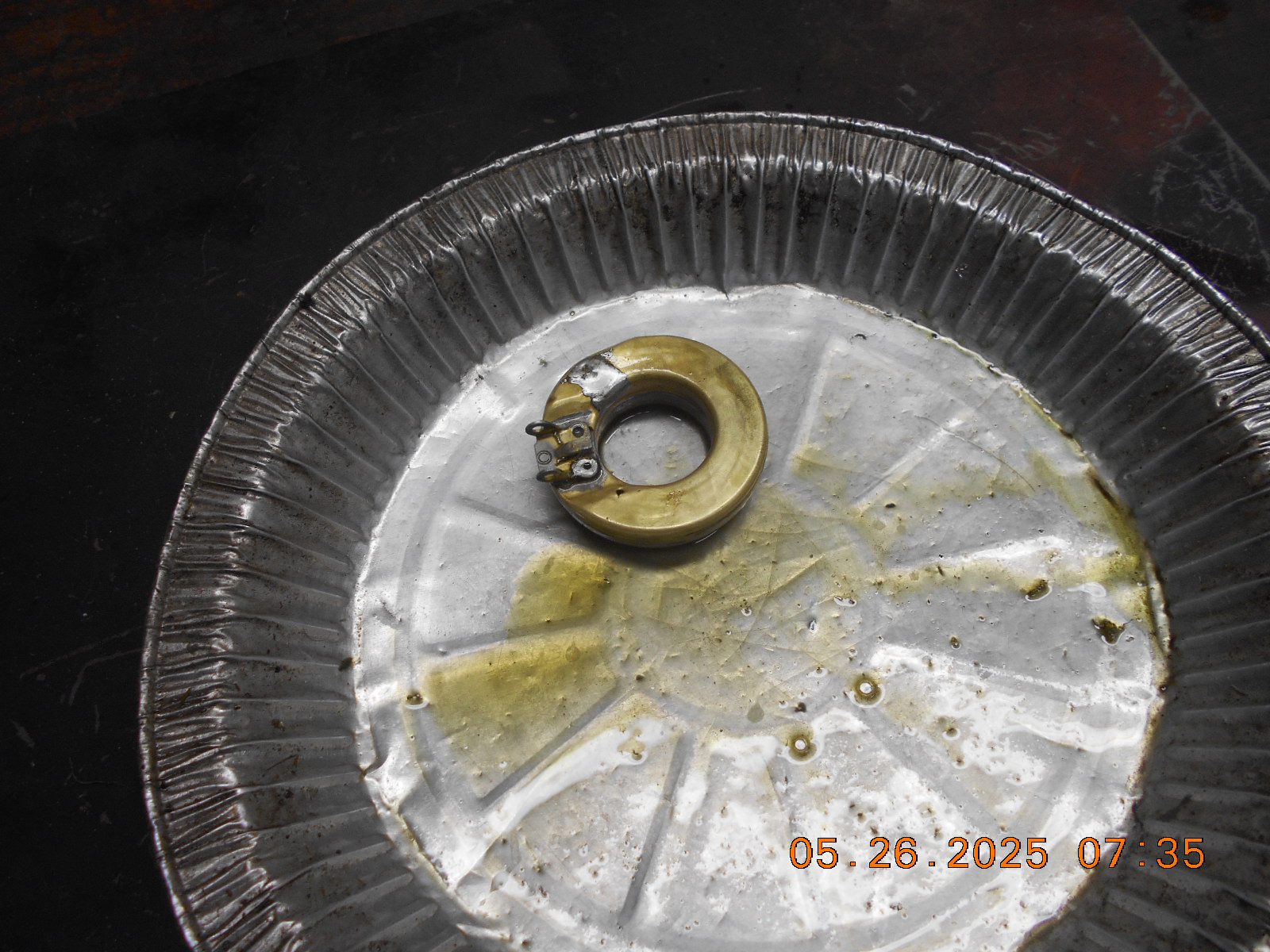

      Finally tore into it, and discovered the brass carb float that I repaired
      had another crack, and the float was half full of gas.
      Hence, the shut-off valve must be leaking by a little as well.
      For a Plan B, in case I couldn’t find a new float,
      I shook the gas filled float, and couldn’t get one drop of gas to
      come out. Perplexed, I got out the heat gun and heated up the float,
      and the leak revealed itself shortly. Tiny little crack barely visible.
      Drilled out the crack, got the gas out, and re-soldered the float.

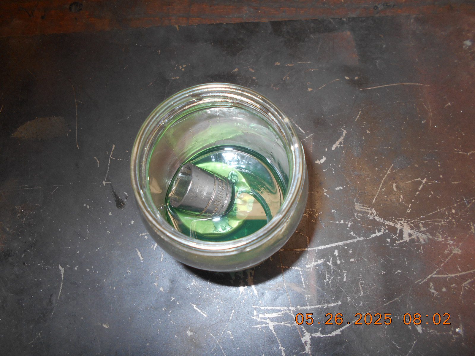

      Got smart this time around, and submerged the float in a jar of
      gas to test for leaks. So far, so good.
      Plan A, I searched for a new float. Appears to be hard to find,
      and some of the Carter N brass floats over the years (Non outboard)
      appear a little different.
      Some research gave me hope that one of the Kohler engine floats
      might work, so I ordered one of those.
      Plan C – Anyone know for sure of a good replacement, lol?
      DSCN2454
      DSCN2457
      DSCN2459

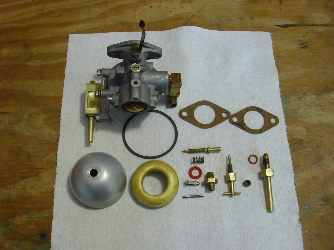

         This picture is from  a 75-TS I have. Carb looks the same. I bet you could by a complete 75 for what a new float would cost, if there was one available. There really isn’t much interest in most Martins but after my experience with the one I have I am really impressed with them. Because of age my “I want one” list has gotten a lot smaller but the 100-TS is still on it.
