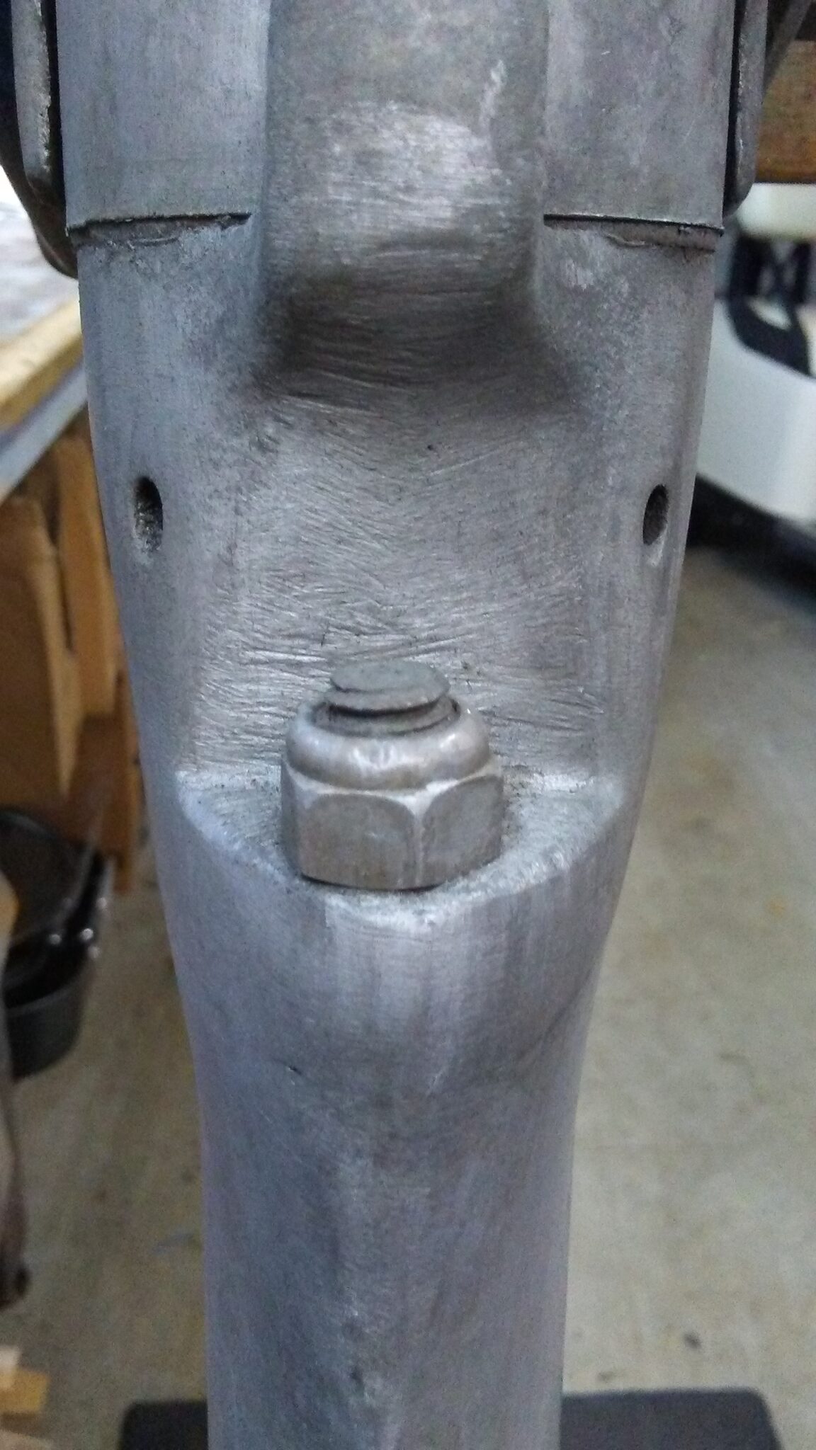

      I am bringing back a Martin 60 and have a couple of questions about the water pump. I am not quite ready to start it up but getting close.
      1) Does the Martin 60 have a telltale? Is there a way to know the pump is correctly functioning?

        1. If memory serves, there should be a water spray out of the exhaust relief holes, about half way down. If it sprays at slow idle, it probably is ok. Rotor should be a close fit on the eccentric cam and be a close fit depth-wise in the housing. There should be a gap between one side of rotor and the housing. The gap moves around as the rotor wobbles through it’s rotation..

        drifter
          Thank you, Frank.
          I should have noticed these two holes sooner. It appears these are exhaust relief as well as telltale for water flow.

          drifter
            Can’t seem to post a photo
            20210903_142443

            #246044
              Yeah, those look familiar.
