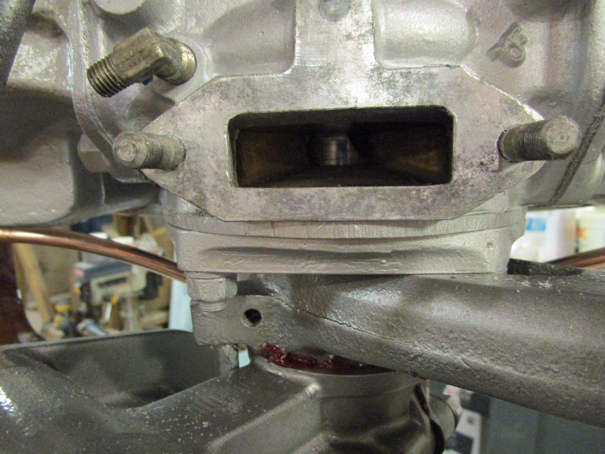

      I feel like an such an idiot .. Ok so I have my motor apart for painting . Carb is off so I didn’t want anything to get into the crank case . So stuffed a rag in the port and taped it up where the gasket seats . .
      Long story short I untapped the flywheel from the timing ring to shine it up before putting the tank on . I had forgotten that the rag was in the port and big dumb -ss me turned the flywheel to get a better position for polishing .. well of coarse it grabbed the rag and pull some into the crank case . It was a very thin rag and I was able to unwind and pull pieces out . I really have no clue if any bits of rag are in there or not . Man I tell ya I’m about at wits end ..LOL !

        Wouldn’t the reed plate prevent the rag from getting into the crankcase?
        Don’t feel bad as I always stick a paper towel up the exhaust when storing a powerhead. On one motor after a rebuild, I noticed the water wasn’t coming out the exhaust relief very well. After a little while it cleared itself out but then I noticed all this shredded paper towel in the test drum water. Yup, forgot to remove the paper towel and now it had to come all apart again to make sure the water passages were clear.

          https://i0.wp.com/www.walagata.com/w/chapsboy/PartsBooks/48_22HPpg2.jpg?w=885&ssl=1
          Not really sure where it could have possibly gotten to .

            I wouldn’t think enough material would have gotten in the crankcase to do any damage,
            and what fragments are in there, should work their way out or disintegrate trying
            to get out.
                to get out.
                Ah, a rotary valve, not a reed plate. I agree with buccaneer. If a bit did manage to enter the valve it should have gotten sheared off and will pass on through with no problem. As long as it isn’t jammed in the valve. A visual look-see as you turn the shaft should suffice.
                #182483
                  From the crankcase opening, either a Speeditwin or the rare model 9039 Heavy Duty Twin which uses the Speeditwin carburetor. A Speeditwin once ate 6″ off the strap on his life jacket with no apparent dammage.
