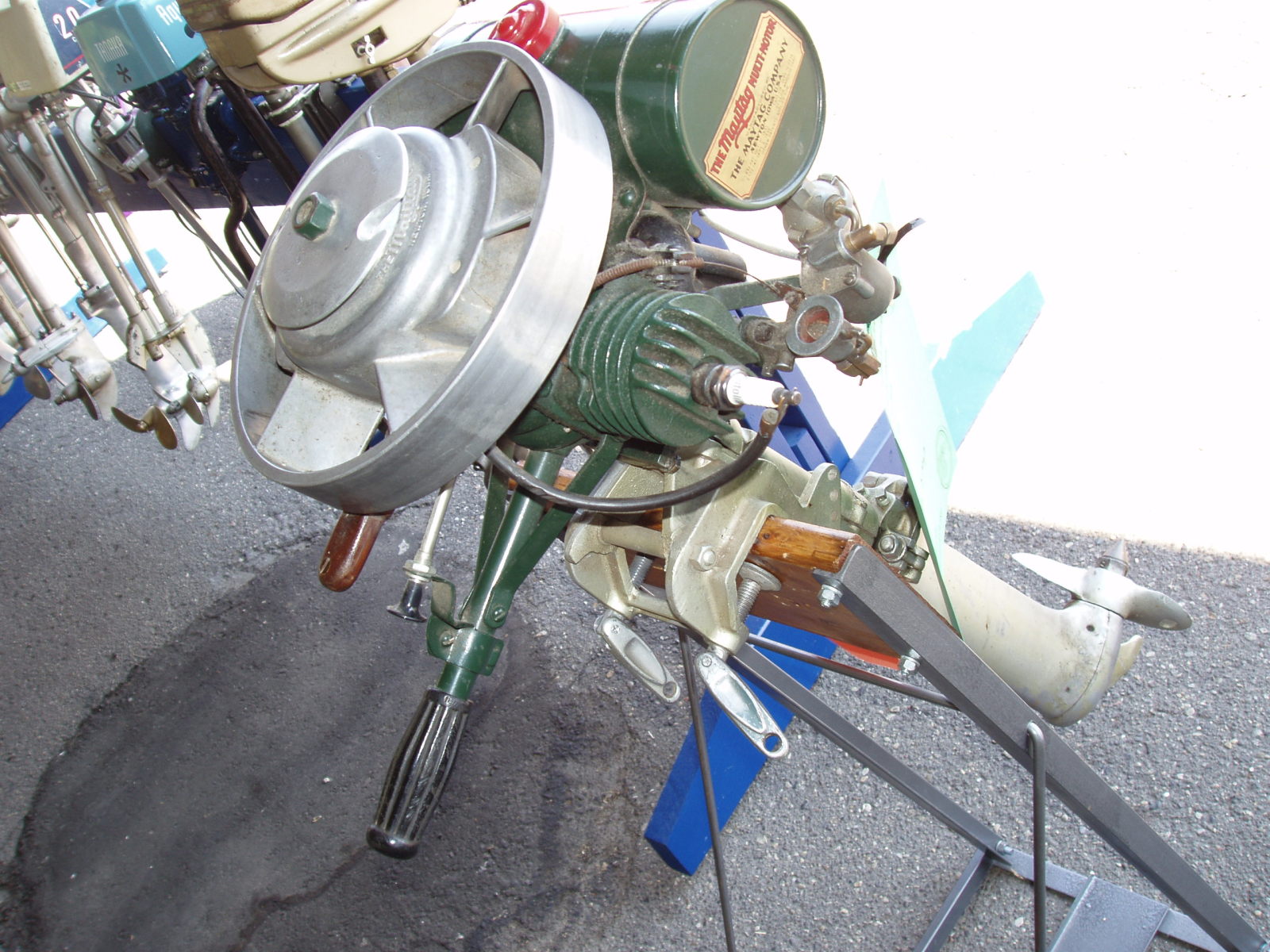

      I was going through saved photos, and can’t remember the story
      on this one. Did Maytag really make an outboard, or is this someone’s
      fantasy outboard? If so, it looks like a nice job.
      What lower unit is the Maytag mounted on?

        That is a "Franken-Maytag"

          early folding omc ?

            That looks like an old Maytag washing machine motor on a salvaged lower unit. They are a "hit and miss" type motor, but it would work ok I guess. I’ll bet it’s a noisy beast.

              I’d like to make one out of the Maytag single I have. The one pictured is a twin which is throttle governed, the single was hit and miss.

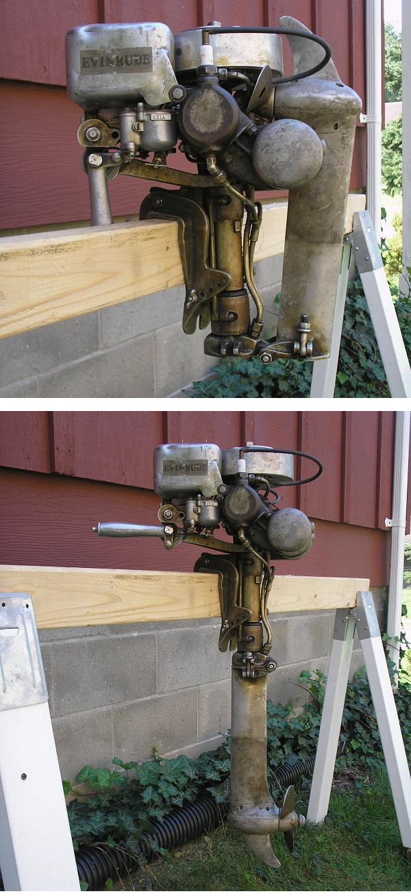

                Lincoln would be correct as the tower
                is from a Foldlight with some later transom
                clamps. The Maytag is air cooled so pumping
                water is not a problem.
                #72720
                  I wonder how the engine was fabricated to bolt on to the lower unit.
                  By the looks of this Maytag twin, it would take some work.
                  Presume the non Maytag carb was plumbed into where the
                  original fuel pickup tube was.
                  I don’t think the single cylinder Maytag would be any easier
                  to fabricate, and I’m thinking the twin would be a lot more
                  pleasant to hear and hold onto the tiller handle!
                  Wish there were more photos of this Maytag Outboard!
                  #72722
                    There was probably an adapter made as well
                    as fabricating a new upper half of the drive shaft.
                    Most anything can be done but just because its on
                    there doesn’t mean its ready to push a boat.

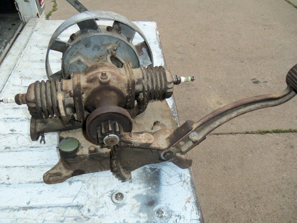

                      That photo of the washing machine motor with the foot pedal starter brought back memories. In the 1950’s, two kids on my street had what we today would call homemade go-carts made from 2x4s, old coaster wagon wheels, and Maytag washing machine engines.

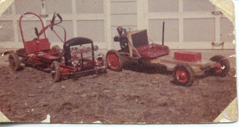

                        There were 5 of us.
                        Couple of mine.
                        We used old reel type lawn mower engines.

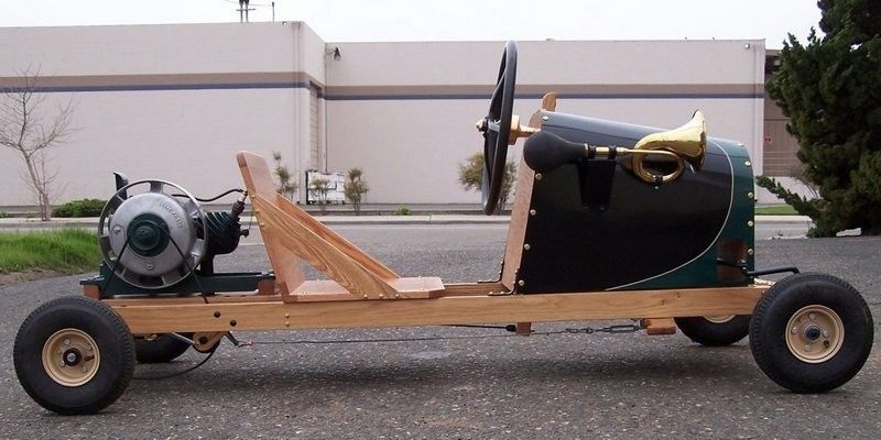

                        From the internet.
