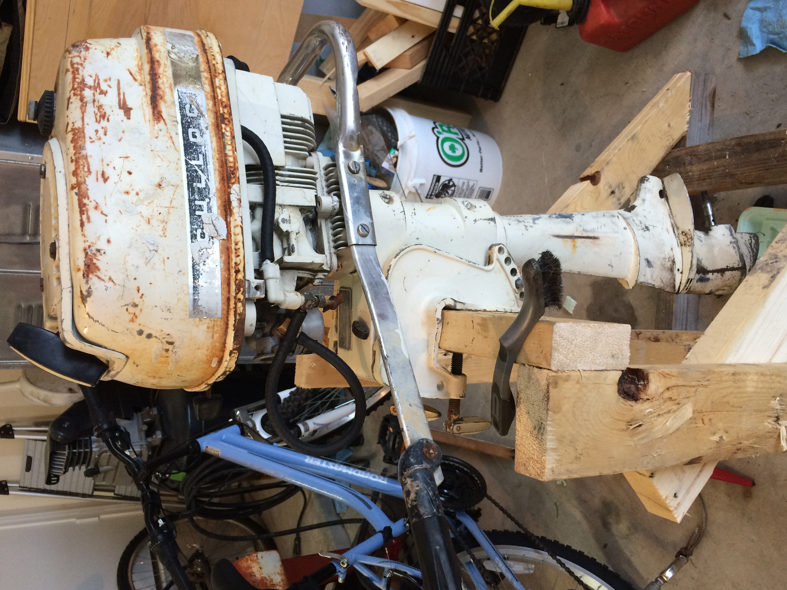

Hello all! I have acquired a 1968 mcculloch 4hp air cooled outboard that I am having some trouble with. Upon receiving, I was unaware that it had the incorrect carb installed and now I must make something work. I have gapped my points at .020 and I have great spark. However, after priming the cylinder with a little fuel, I cannot get it to fire off. Any info would be great!!

The book calls for Champion J18YC plug, set at .035. May not hurt to try a new plug…April 6, 2018 at 12:16 pm #73513The lower fuel line on there looks a little long looking at the picture it looks like it goes below the carb bowl which I would think would mean the carb bowl might not be filling up with fuel as it should since it is gravity feed. Hope that helps.

April 6, 2018 at 3:22 pm #73525The carb is not original to the motor so the position of the connections are rather inconvenient(hence the long hose). However, because the tank is higher, the bowl is full.
