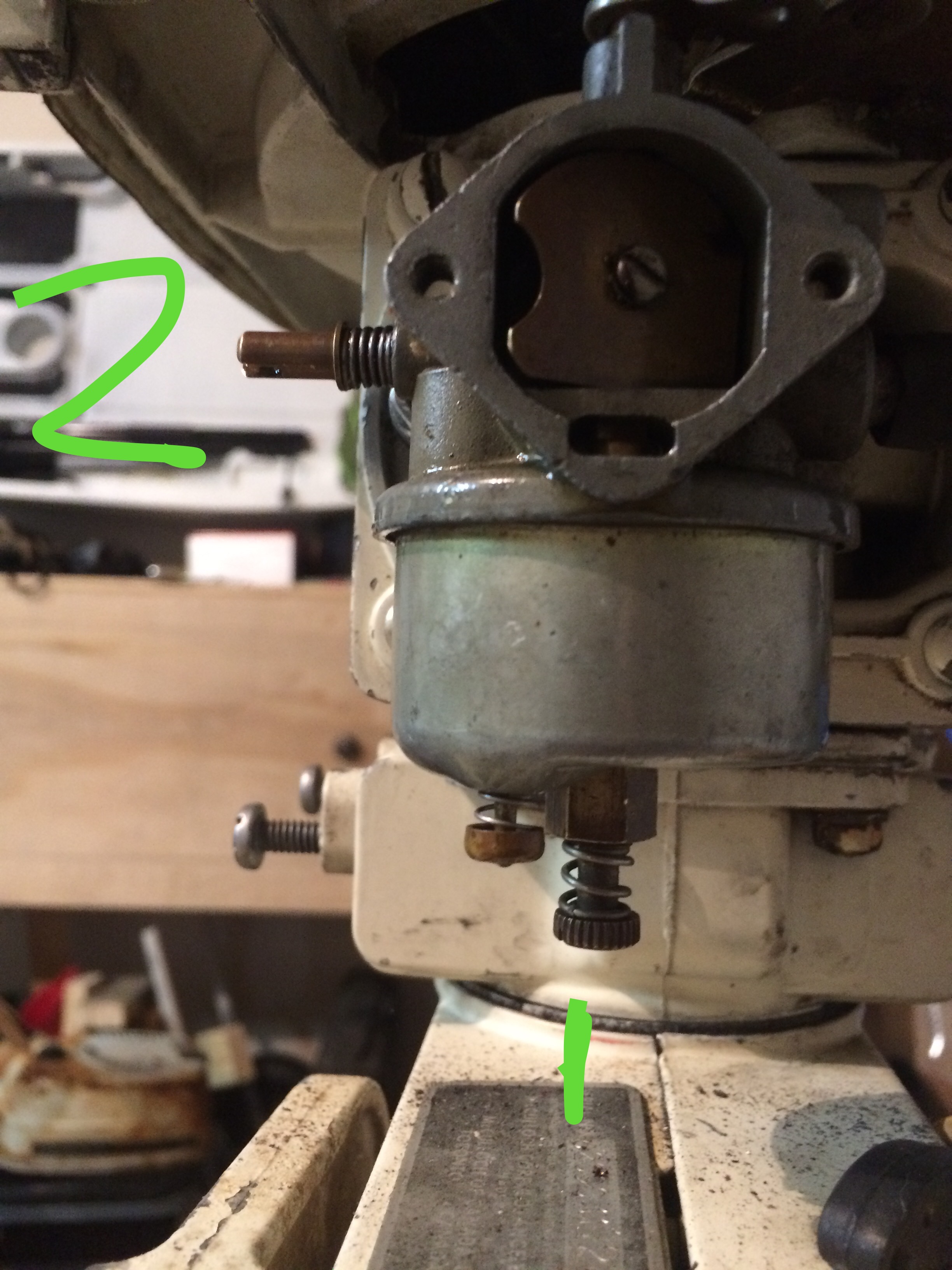

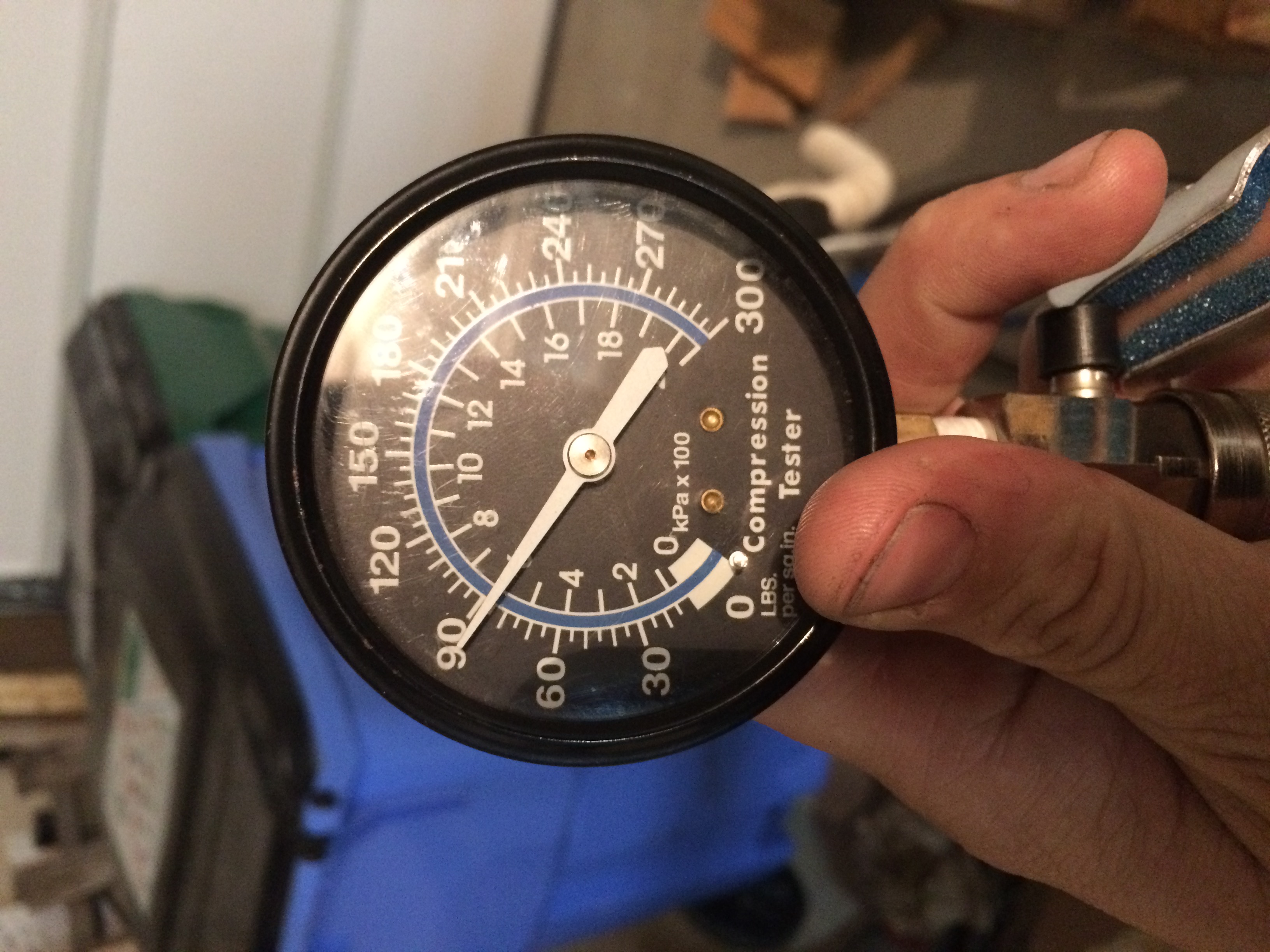

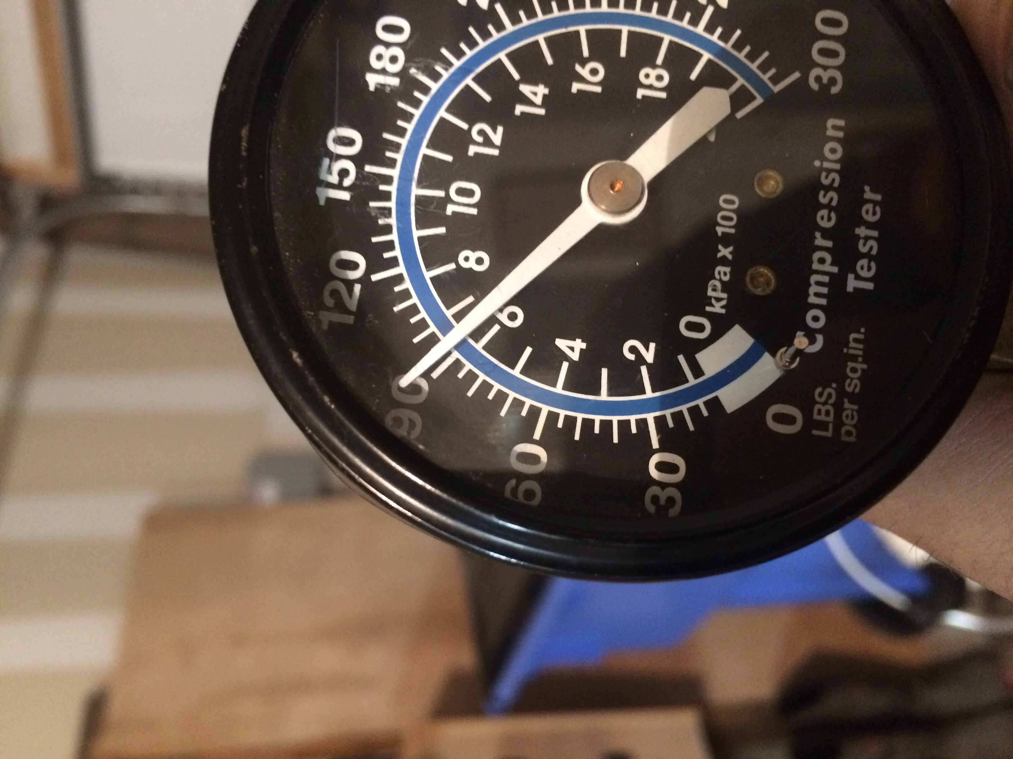

                  Well the new reeds definitely brought compression up over 90. The lowest picture is after reeds and the highest is after a couple drops on gear oil. I still have no fire. No burn. No pop. Nada. However I still have a flooding issue? I open fuel up about 1 full turn and I have fuel/carbon mixture dripping from lower shaft after cranking.
                  What should my adjustment be on these two screws? Screw 1? Screw 2?

                    Set the high-speed (#1) 1 1/4 turn open from closed, # 2 at 1/2 – 3/4 turns open from closed. If you’re still using starting fluid into the carb, you need to open the choke – that flap across the front of the carb. But I’d go back to putting fuel (or starting fluid) directly into the cylinder and crank. If that doesn’t produce a pop, your timing is off or your spark went somewhere..

                      Hmm ok. I guest I have screw 2 open too far. I’ve got it 1.5 turns open and screw one I have at 1-1.5
