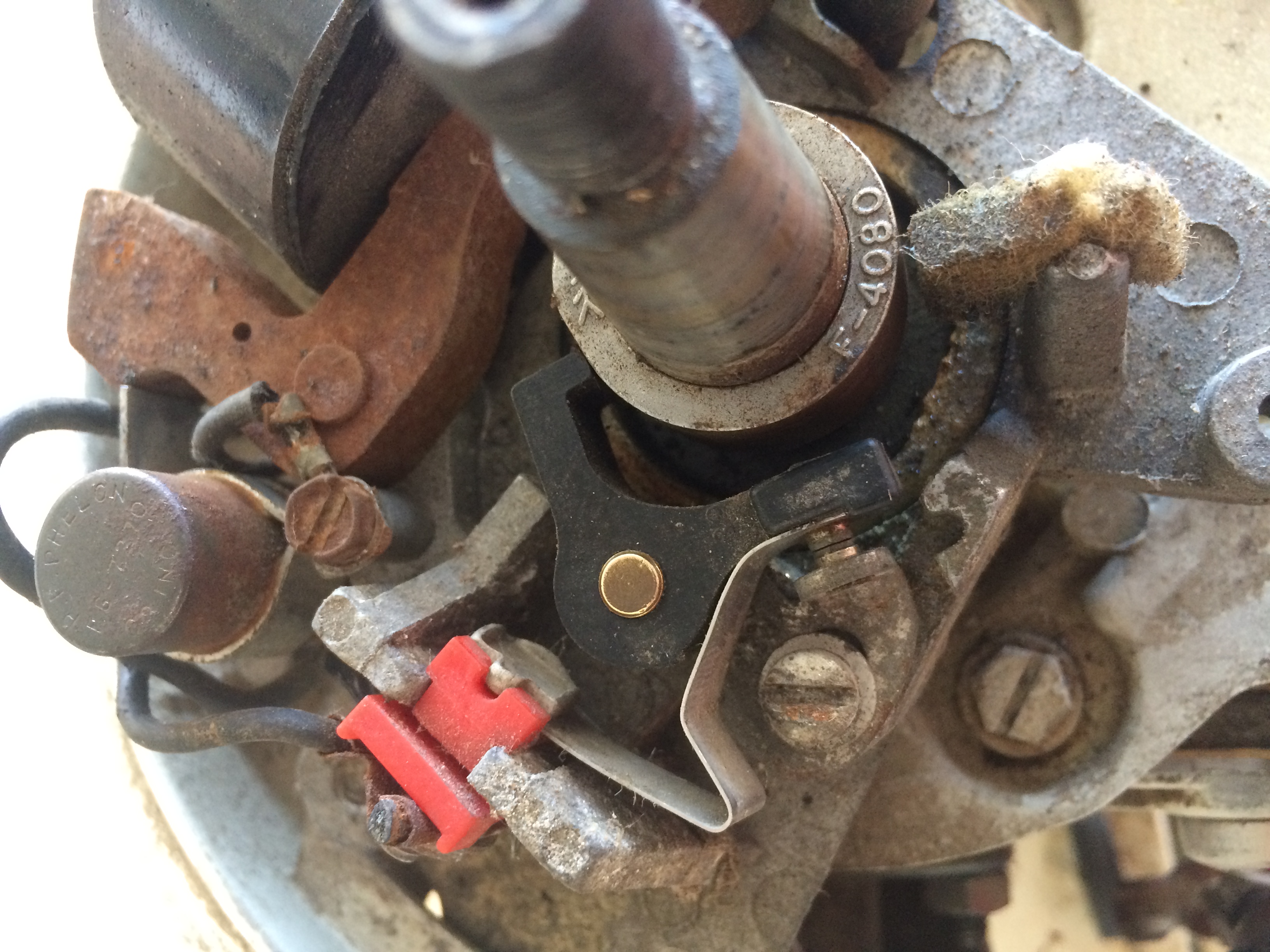

April 15, 2018 at 4:53 am #74021It sounds clear and strong when I pull cord. The points are right as I look at them. I’ll take a pic tomorrow and post here.
Yes cam is metal and is fixed. It operates appropriately.April 15, 2018 at 10:00 pm #74073April 15, 2018 at 10:28 pm #74075I’d be more concerned about the condition of the ignition components than the exhaust.

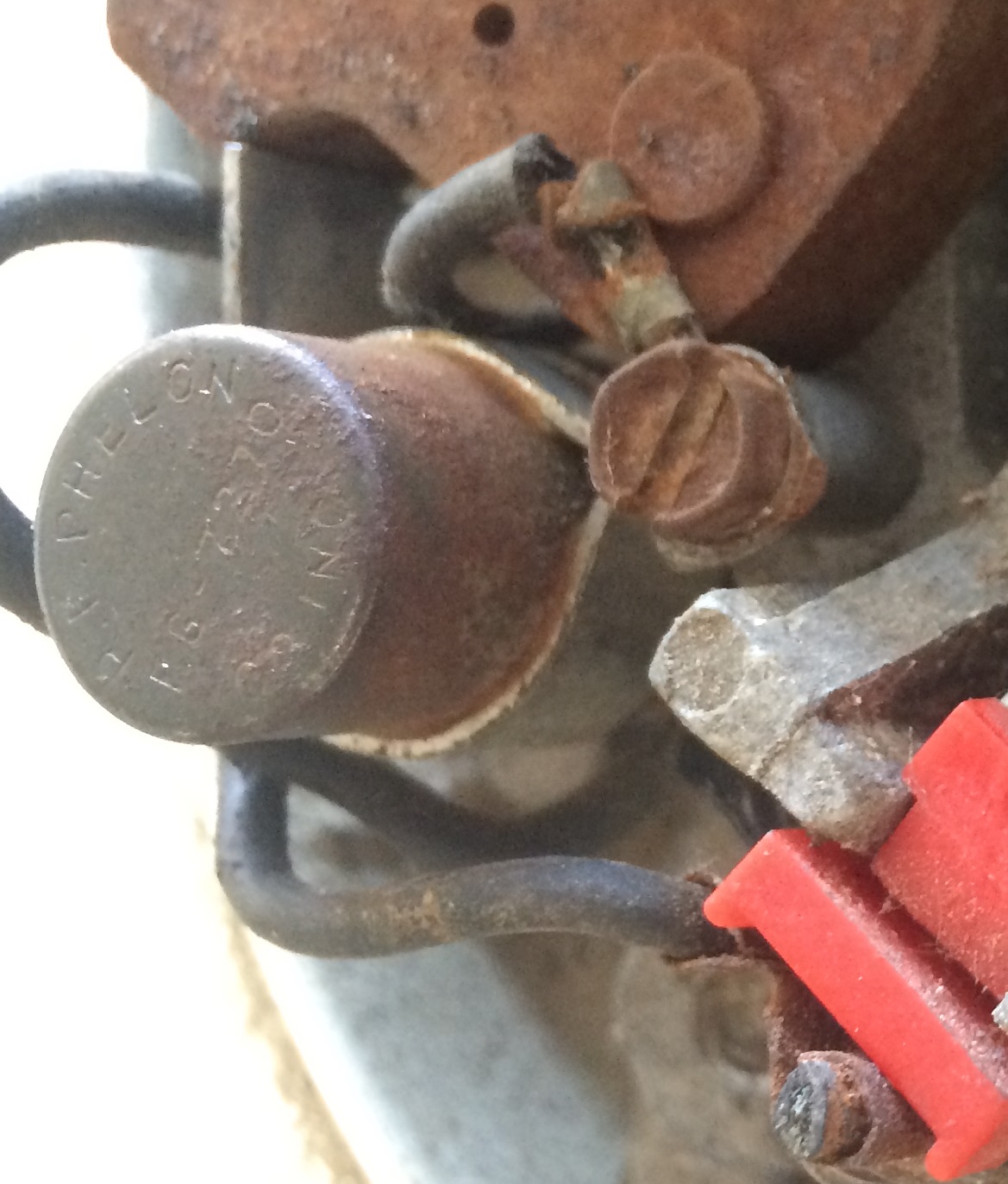

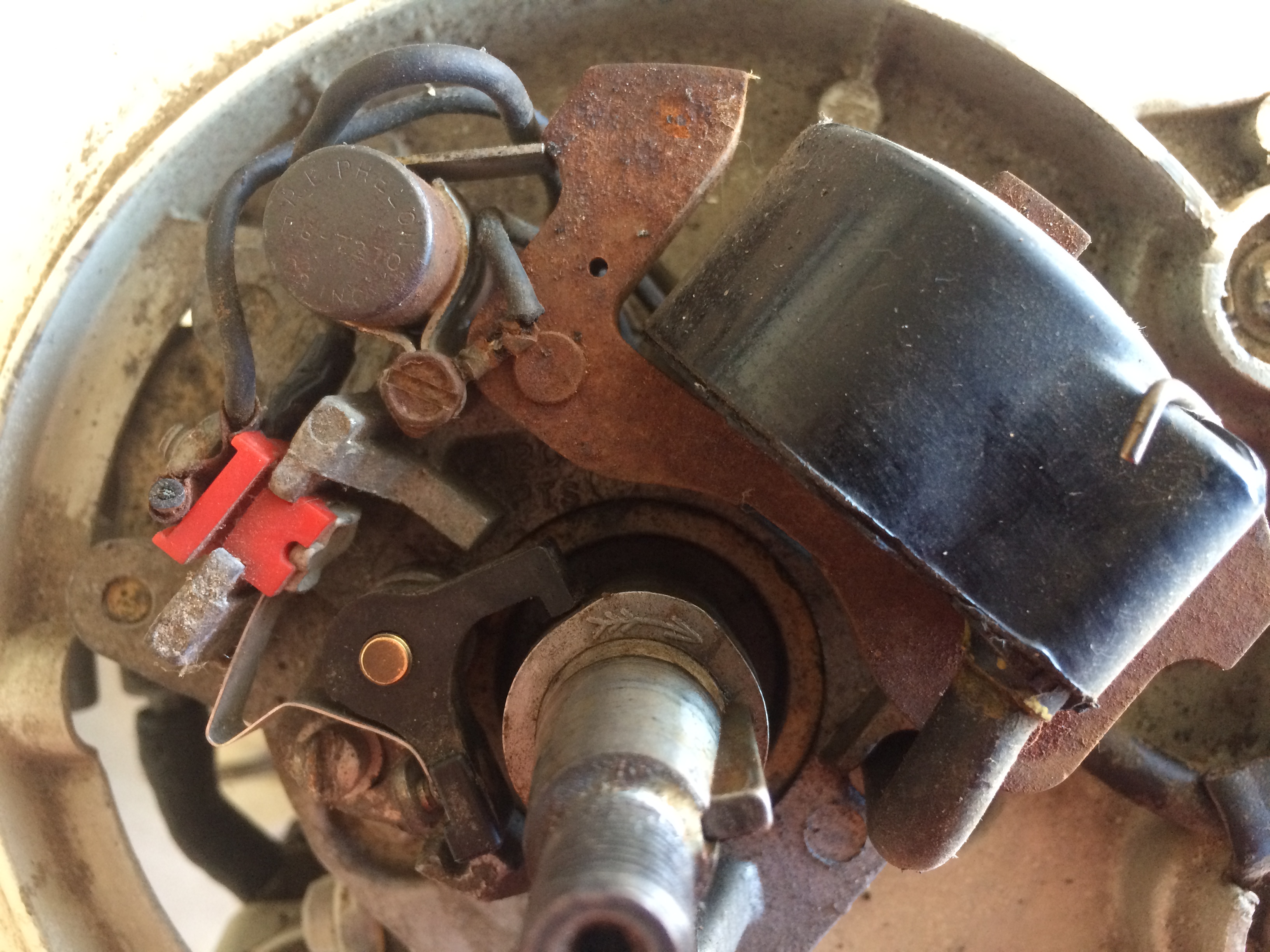

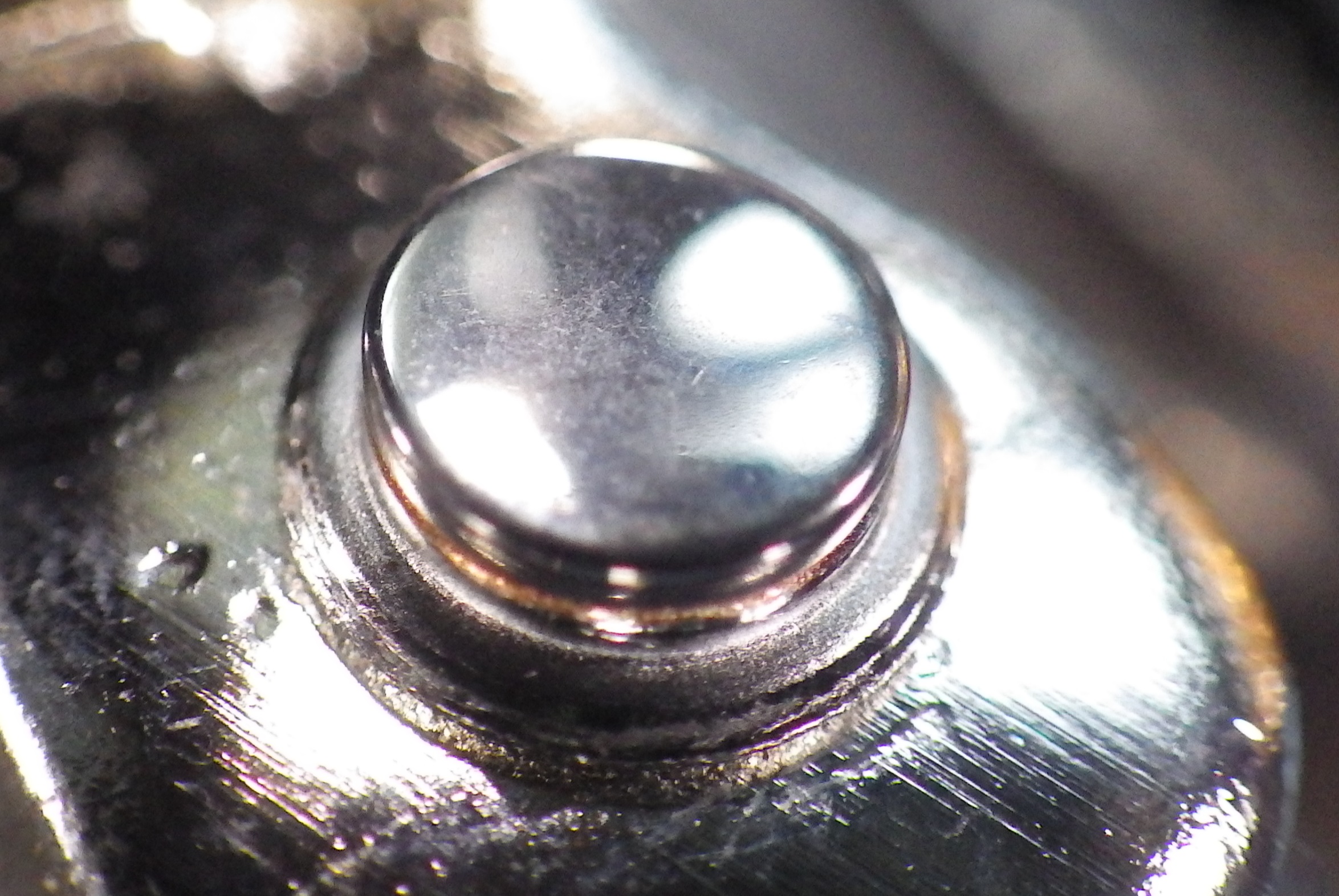

The points should be removed and cleaned of any dirt or scale and polished until they are shiny. The electrical connections look corroded to and the condenser has probably seen better days. This mag might fire a plug without a load on it but once the plug is reinstalled and under compression, it may not have enough oomph to do the job.
April 15, 2018 at 10:31 pm #74077I’ll take them off again and rewire the connections and see what happens. I did take he points off once and used some steel wool to clean them up because they were corroded pretty bad
April 15, 2018 at 10:32 pm #74078Where might I find a new condenser?

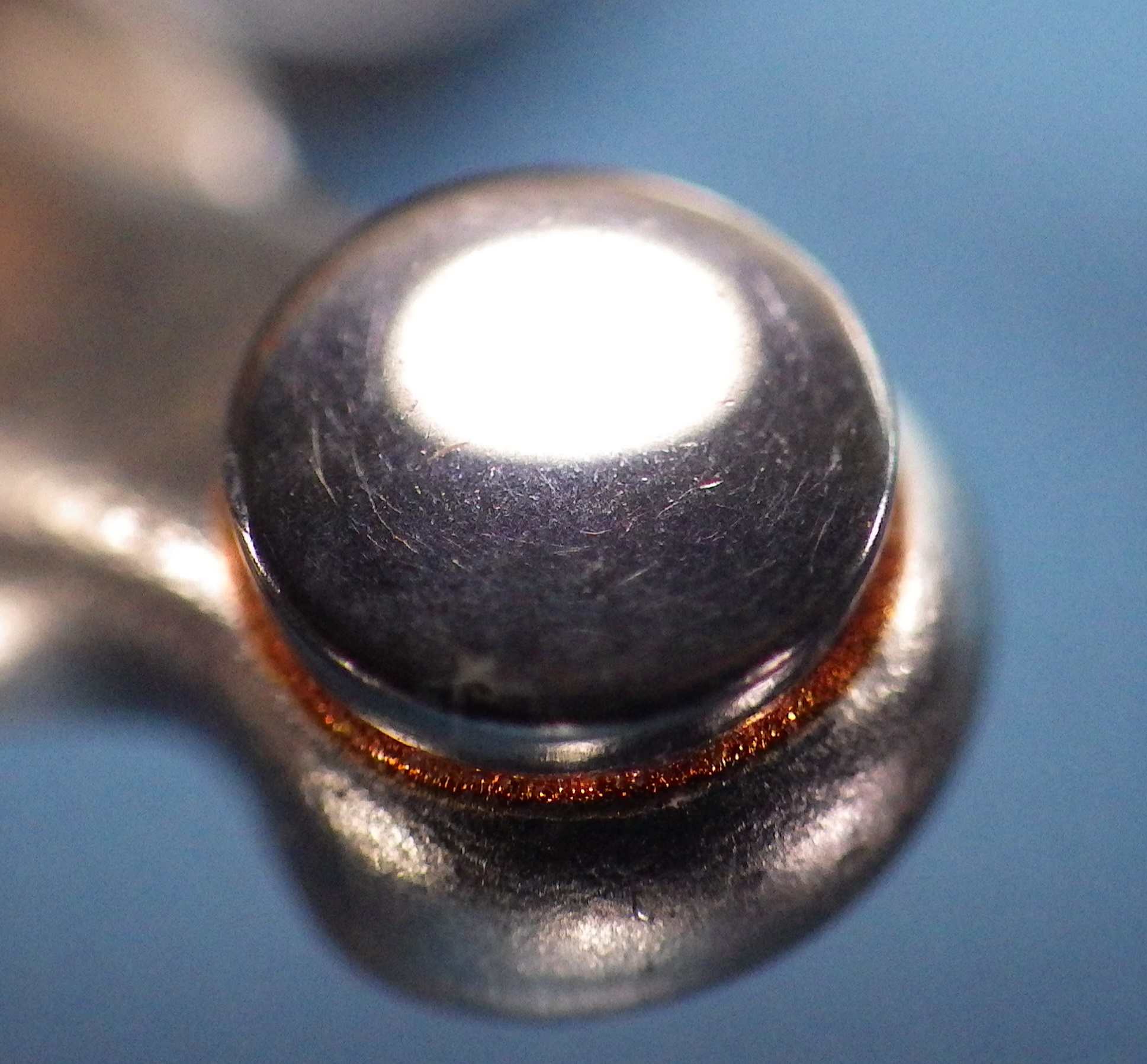

April 15, 2018 at 10:38 pm #74079You want them smooth and shiny with no scratches on them for best results. Using progressively finer grits of wet n dry paper will give good results. Usually I start with 4-600 depending on the condition and finish up with 1500 but 800 will give good results to. A used piece of paper with the sharp tooth on it worn down works good to.
April 15, 2018 at 10:50 pm #74080quote John8504:Where might I find a new condenser?That’s a Phelon mag with cap P/N PG or FG-7270? I’d try a Google search first or place a want ad in the Free Classified section here or if you can find the uF rating for it, replace it with a Vishay cap with the same or close uF rating.
Quality replacement Vishay capacitors can be found here at Digi-Key with ratings of 0.10, 0.15, and 0.22 uF to cover most outboard magnetos. Click in the upper right to change your country/location.
https://www.digikey.ca/products/en?x=23 … =bc2607-nd
https://www.digikey.ca/products/en/capa … =bc2608-nd
https://www.digikey.com/products/en?ven … =bc2609-nd

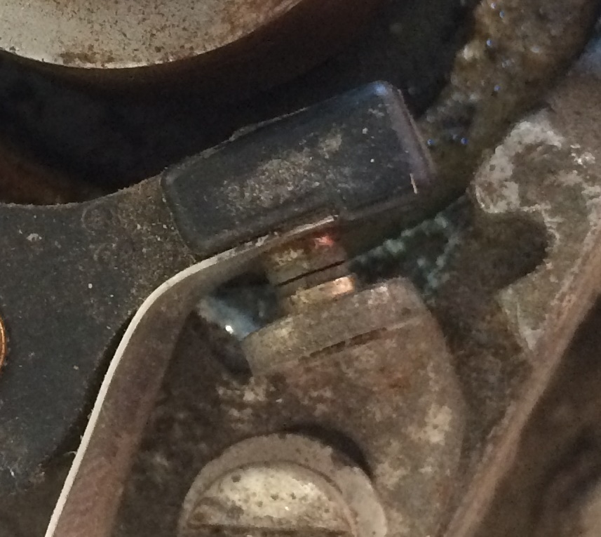

April 16, 2018 at 1:38 am #74102I did pull points off again and there was a burn mark. Also upon inspection, they do not seat flat with each other. I guess I need to start with another set of points and condensor
April 16, 2018 at 3:48 am #74107Burned points are a sign of a bad cap. Try cleaning and polishing the points first and then source a new cap.
I found the original Phelon cap listed and it is P/N FG-7270 and is rated at 0.16 – 0.18 uF. (Microfarads)
