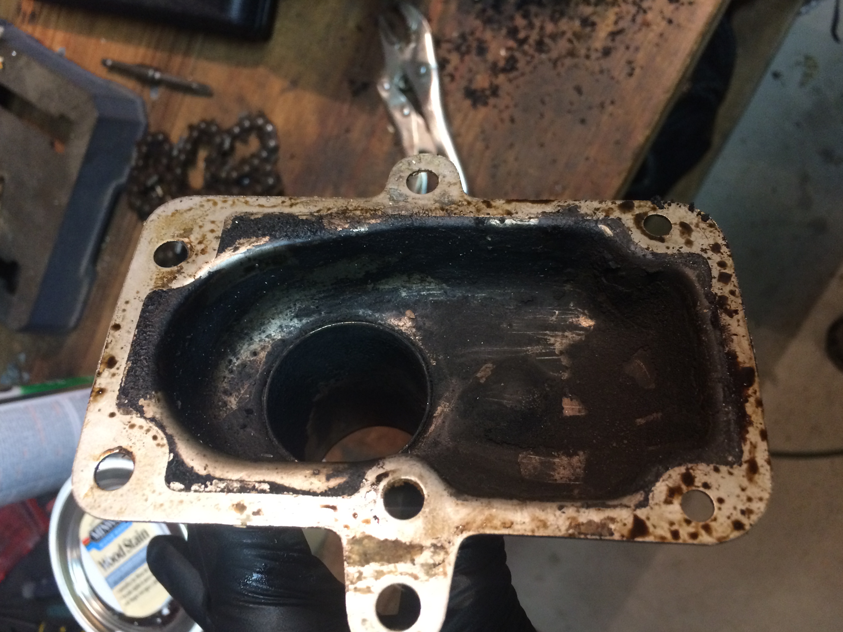

      I hate to keep harping on the exhaust being restricted but if everything else checks out to be o.k. it may need to be re-visited.

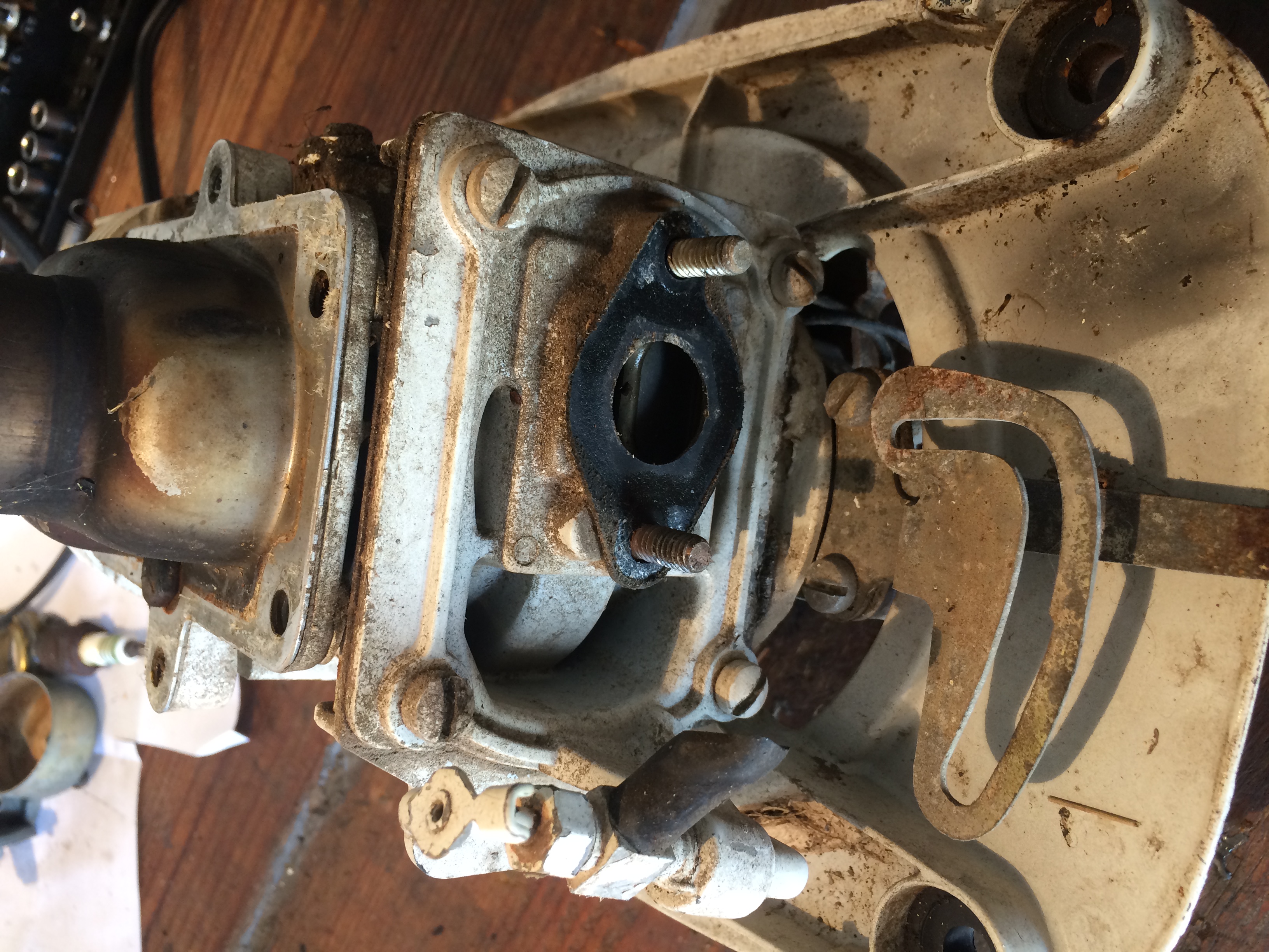

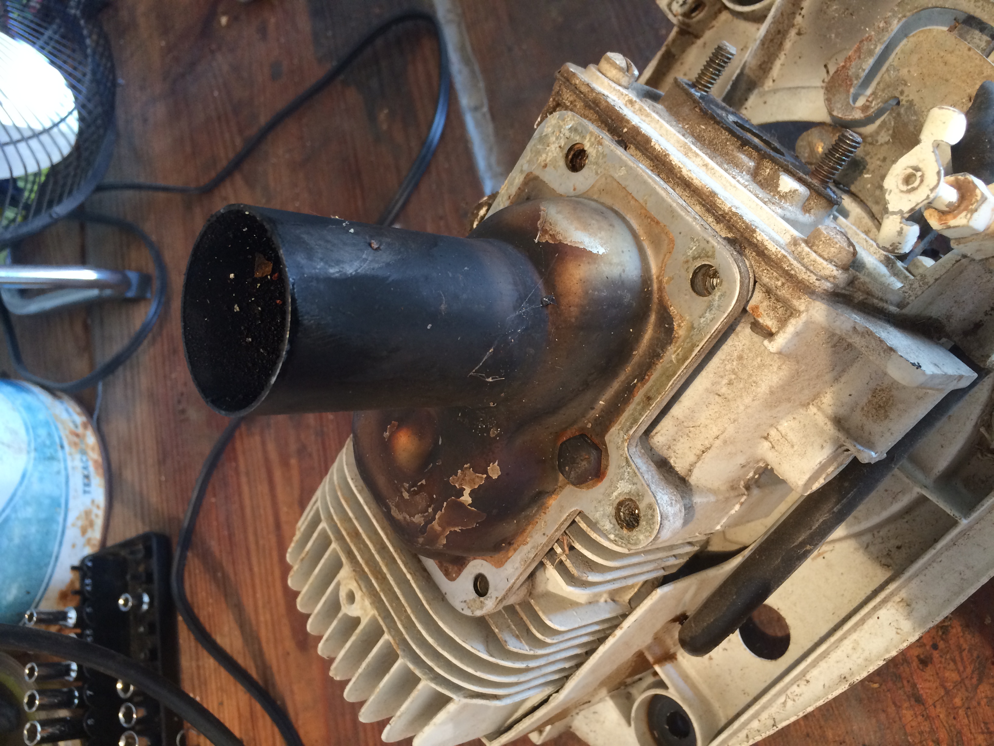

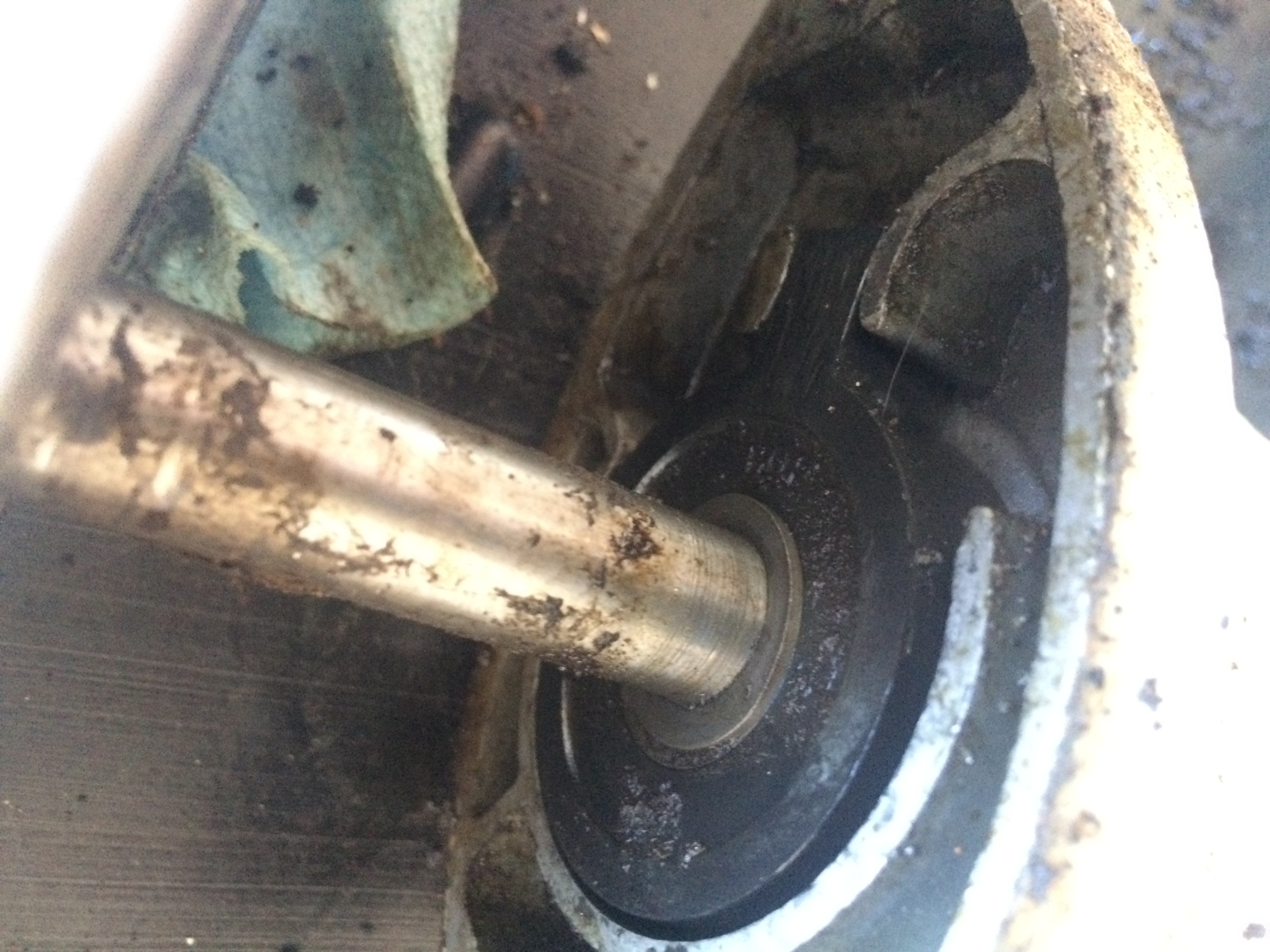

      I am guessing the motor also has an impeller to pump water to cool the exhaust. The impeller is in the 3rd picture it also helps to silence the exhaust adding the water to exhaust. Its the black rubber part in picture.

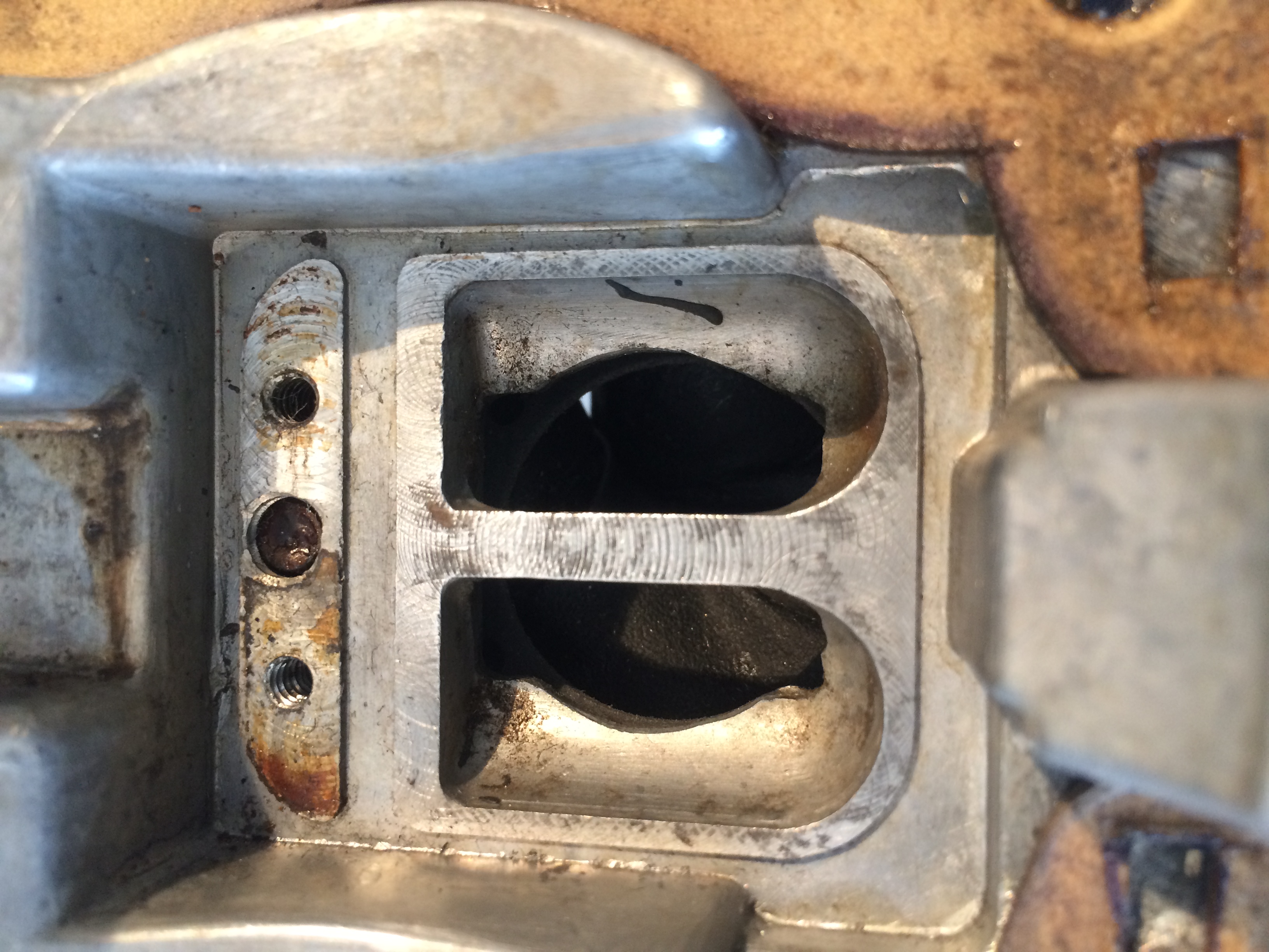

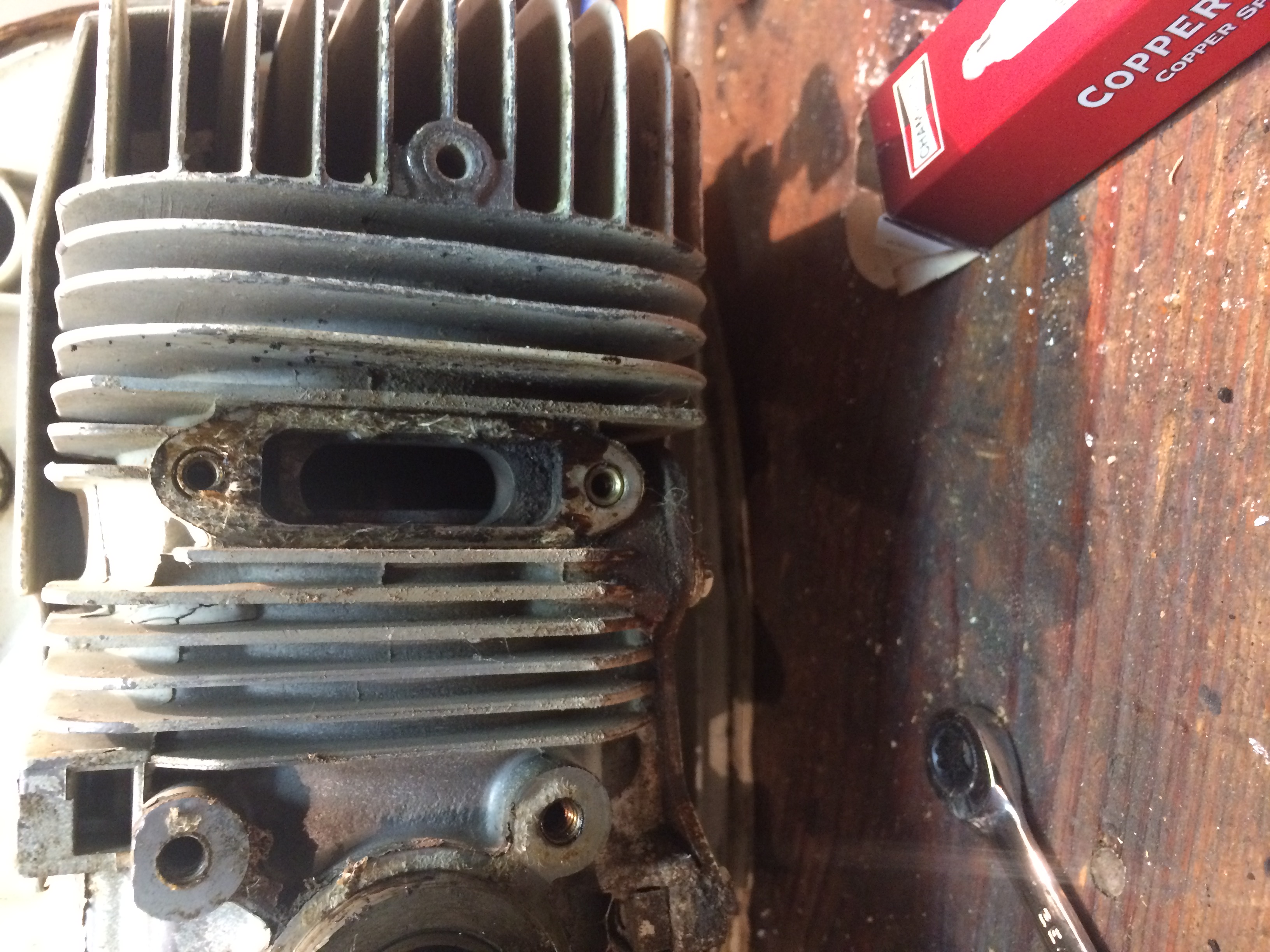

      MY QUESTION Could you tell me or show me a picture of what part bolts to the exhaust port in this 1st picture. Have you tried starting the motor briefly using starting fluid with that part off the motor?? That exhaust muffler part would take the bulk of the carbon build up since its the first place the exhaust goes. I have a 2 stroke yamaha golf cart it has a huge muffler they also become clogged and the fix without buying a new one is to build a fire then hang the muffler right above the hot coals and let the oil and carbon melt and run out of the muffler.
      If the exhaust is restricted then the engine can’t draw fuels in because it can’t push air out if that makes since. I am guessing that the part that bolts to the exhaust port here is not water cooled its the first place the exhaust goes and is vulnerable to carbon build up then the water is added thus surrounding it in the second picture to help keep it cool and reduce sound.

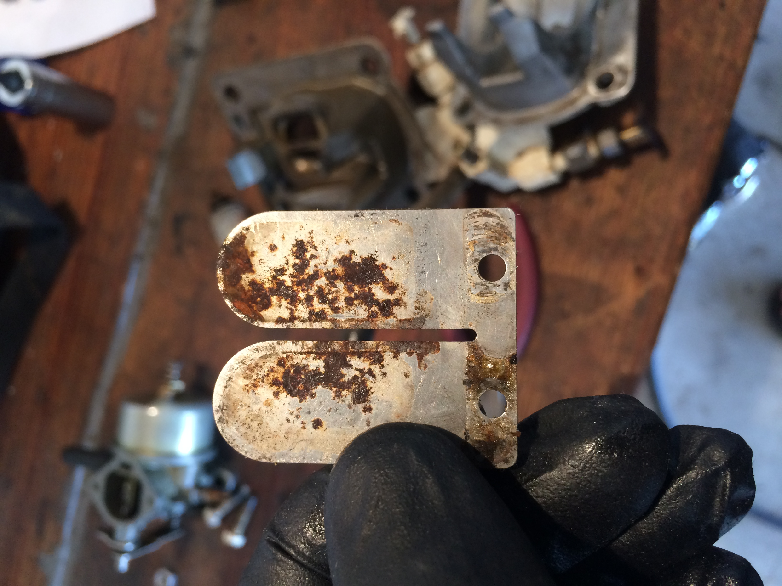

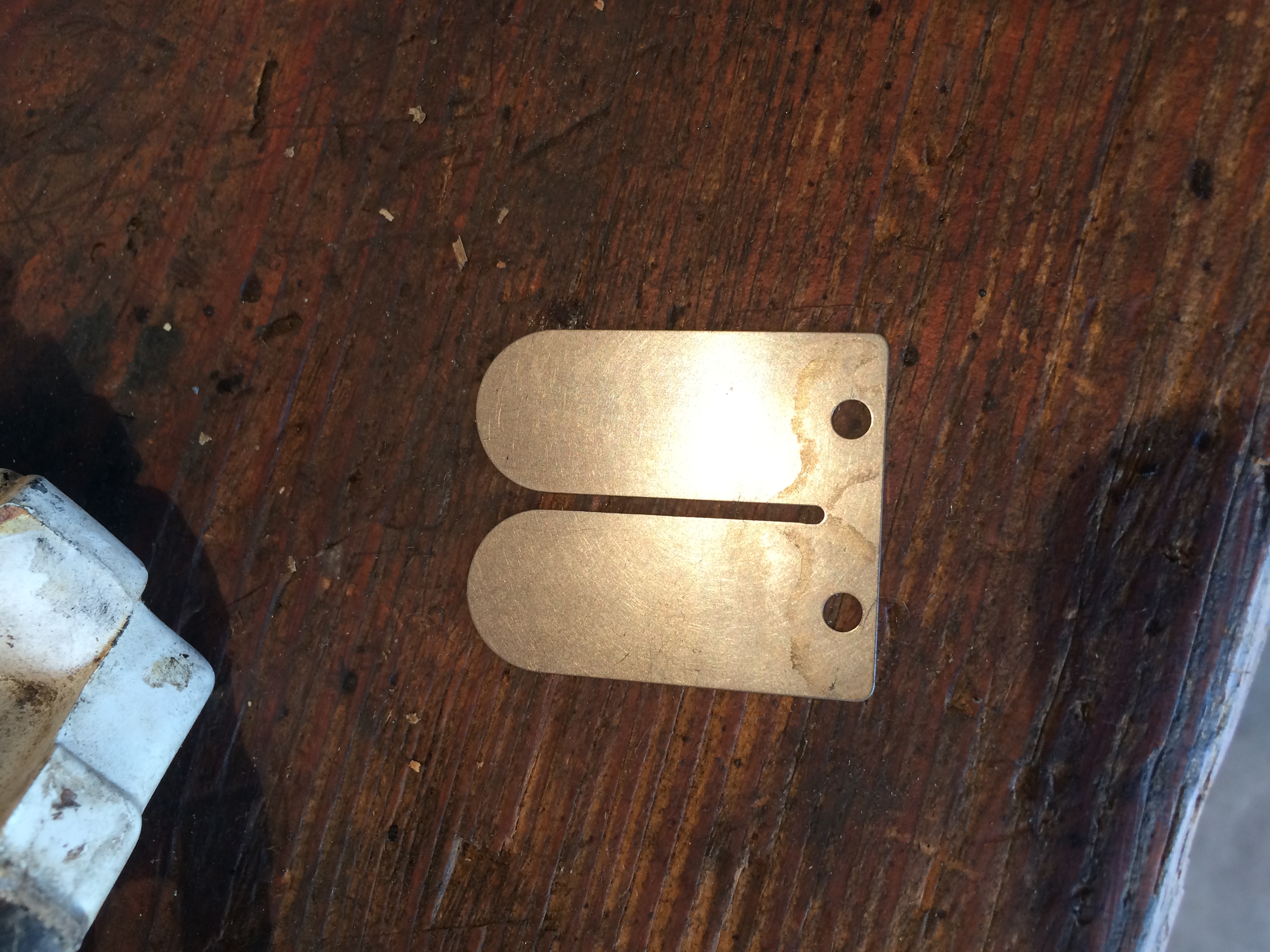

              Going to rip into motor and since I have a donor motor, I’ll compare parts and see what might require replacement. First and foremost, the reeds. Pictures to follow.

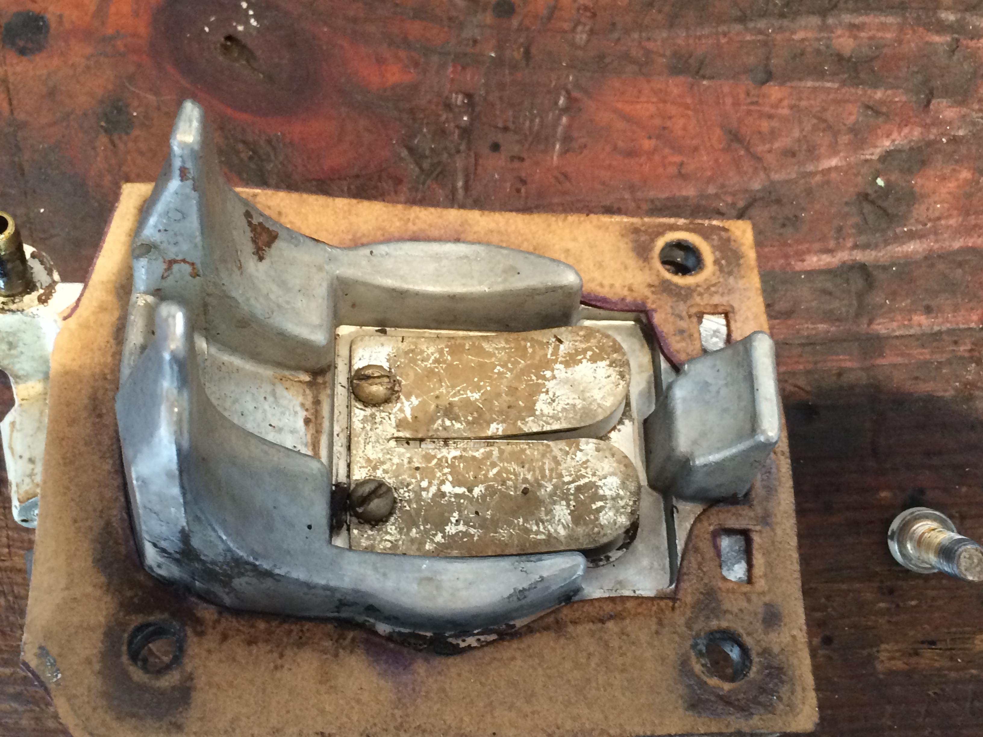

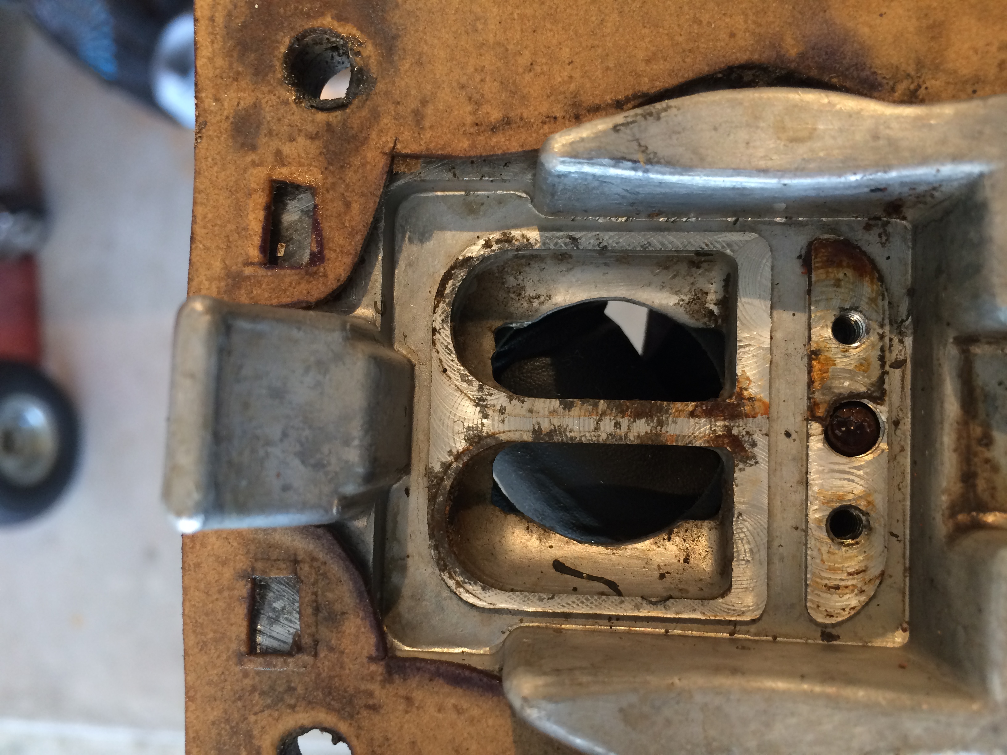

                I’m going to add lots of pictures. I did notice that the reeds on motor were not in best of shape (in pictures) and the ones from the donor were in great shape…in swapped them out after putting a little steel wool to it. Also included is the makeshift gasket I put on since I couldn’t find another.

                  Picture of bad reeds

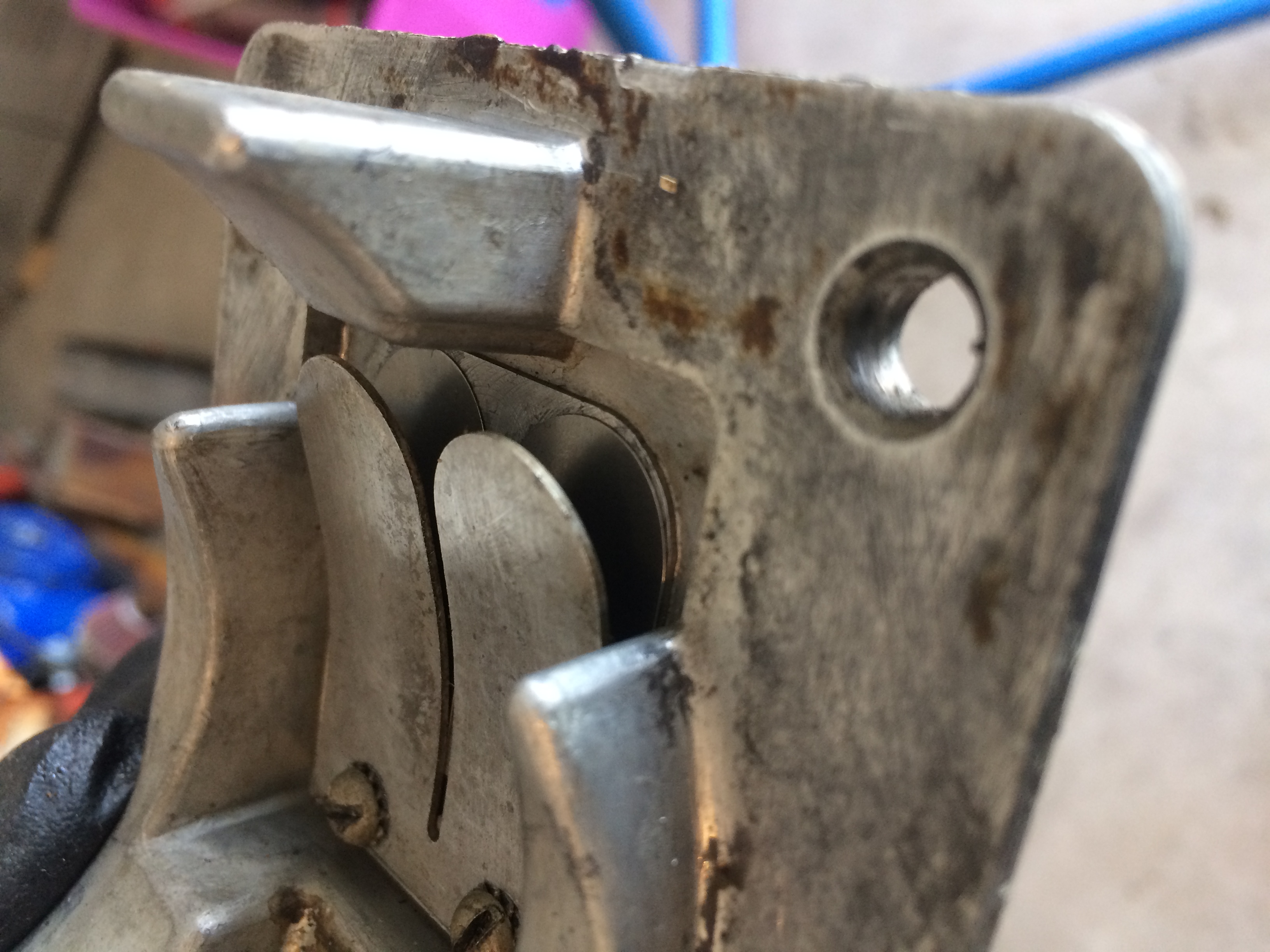

                    They look pretty clean now they did not before. I put locktite on those screws when I put reeds back on a motor. I usually use the red colored locktite on them to make sure screws don’t back off and get eaten by motor.
                    One thing I do is take a flashlight and look to see if I can see light coming through the reeds once I got it all like I think it should be before putting it all back together.

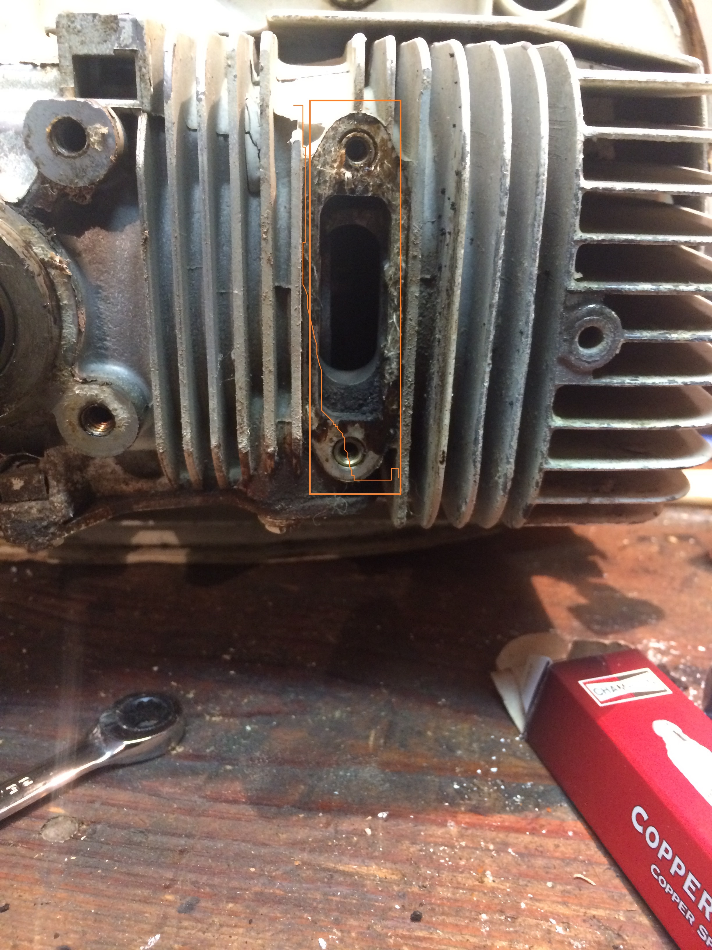

                    I see a muffler pipe attached to bottom of power head. Does any thing connect with where I have drawn a rectangle around the exhaust port????
                    Joe
                    #75040
                    john8504
                      It was just a plate that directs the exhaust flow towards the baffle that I have pictures above.
                      Yeah the reeds were pretty bad. Good idea on the flashlight. I’ll try that when I get home.

                        I see what your saying. So the exhaust leaves exhaust port thru like a diverter then thru the baffle then exits thru the bottom of the outboard near the foot. All that is of course is clear and non-restricted I’m sure you have checked that out. No mud or nests down low where the exhaust leaves the foot? The reeds look good enough now to get the motor to hit. The ignition is firing and you know where to set your lever to make timing correct. Seems like it would hit at this point if you have adequate compression.
                        Once you get it re-assembled let us know if you get it to hit if not have you tried a tad of gear oil in the cylinder yet? Also I would like to know what your compression gauge shows with the oil in cylinder for psi?
