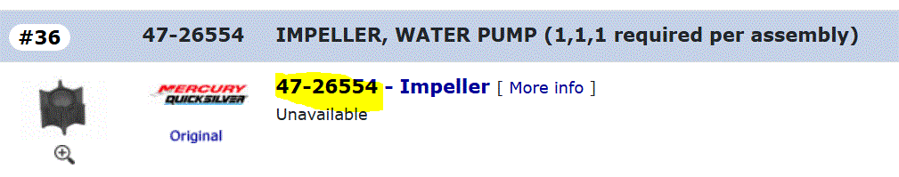

      Has anyone found a replacement for the Mercury 47-26554 impeller? I read the sierra 18-3008 may work if the keyway is filed square. Its for a `65 Merc 200. Serial #1802198. Thanx in advance for any help,Mike.

            seems like that is the proper impeller number NLA… for a Merc 200 with that serial#
            several    47-26554  $$$$$      listed on e-bay but  sierra 18-3015 could be a replacement ?

                SIERRA 18-3008 Impeller Ding for Mercury/Mariner Outboard Motors
                $4 … if filing the keyway works…
                #322996
                fastjohn
                  Sierra 18-3008 or Mercury 47-20813, which is for a Mercury KH-7, Mark 15, 20, 25, and 30, will work in place of Mercury 47-26203 by filing the pin slot square.
