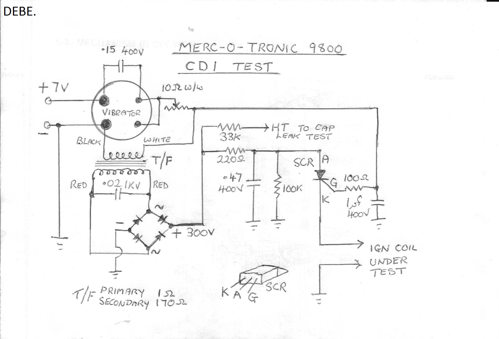

          debe
            I have a Mercotronic 9800 that has a CDI coil test function. This is the circuit of the CDI function of it. So yes there is one model that can be used to test CDI coils.
            #77615
            gofastgramps
              I have a 9800 that I don’t use often (and forgot about) I will dig it out and see if it will work for this. I also have a 800 series for solid state but no info. on how to use it for the outboard coils. thanks for the help. gary
