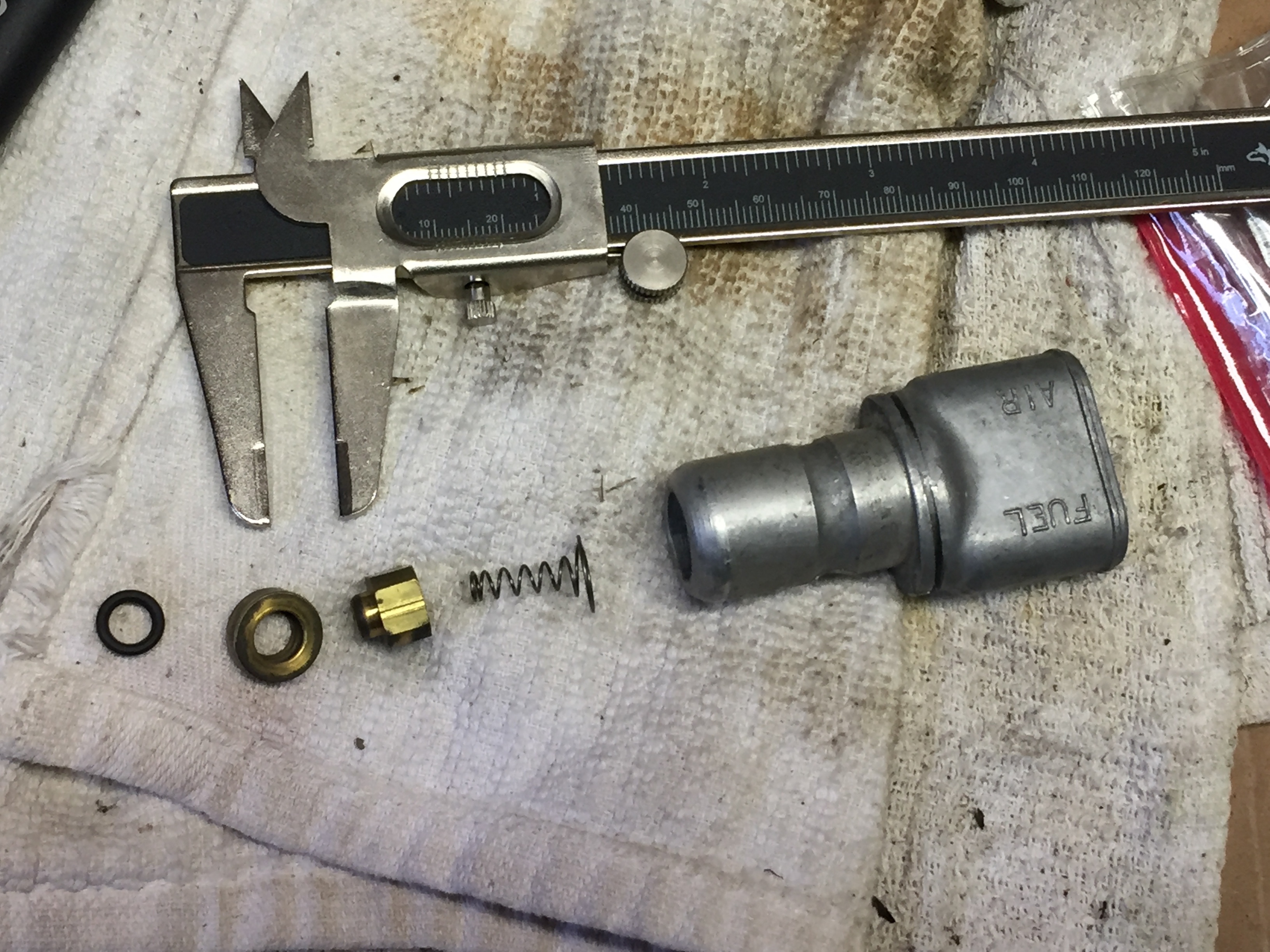

      I’ve installed several o-rings in OMC fuel couplers but this Merc one has me stumped!!!! Have coupler apart but can not get inner o- ring into groove. Help!!

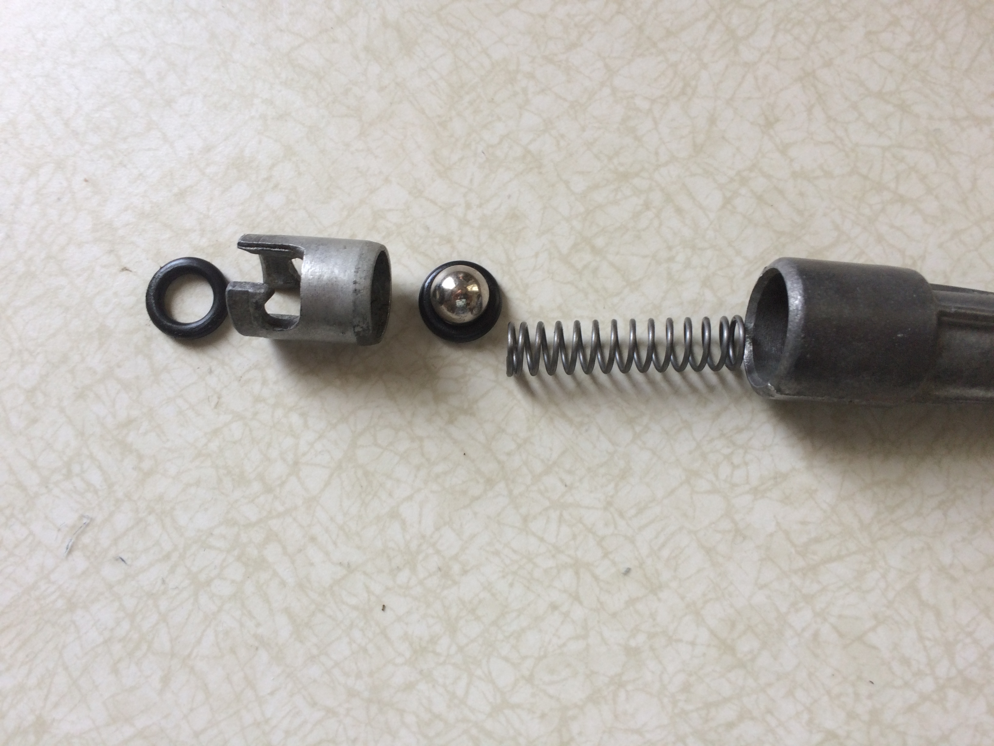

          Looks alot like the OMC connector inerds…….

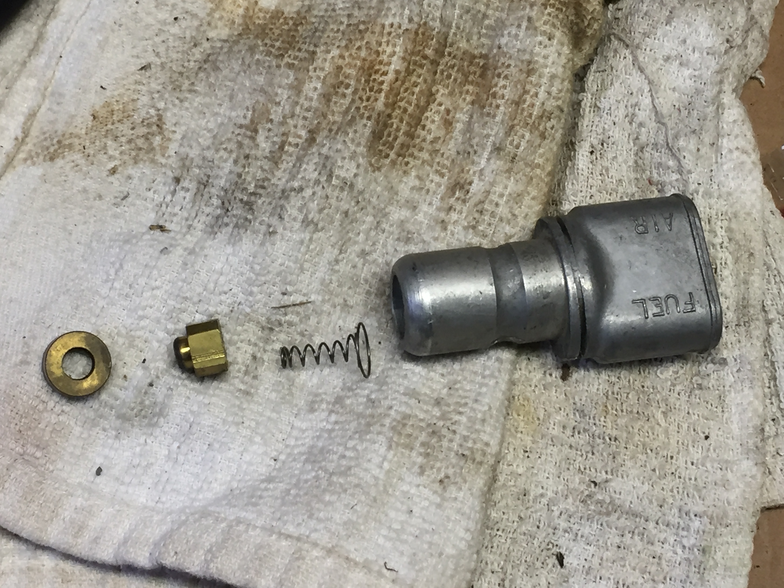

            That’s not the coupler. Getting o-ring into the twist lock part is the problem.

              OHHH you mean the non pressure type connector….
              Not had one of those apart, but have several….

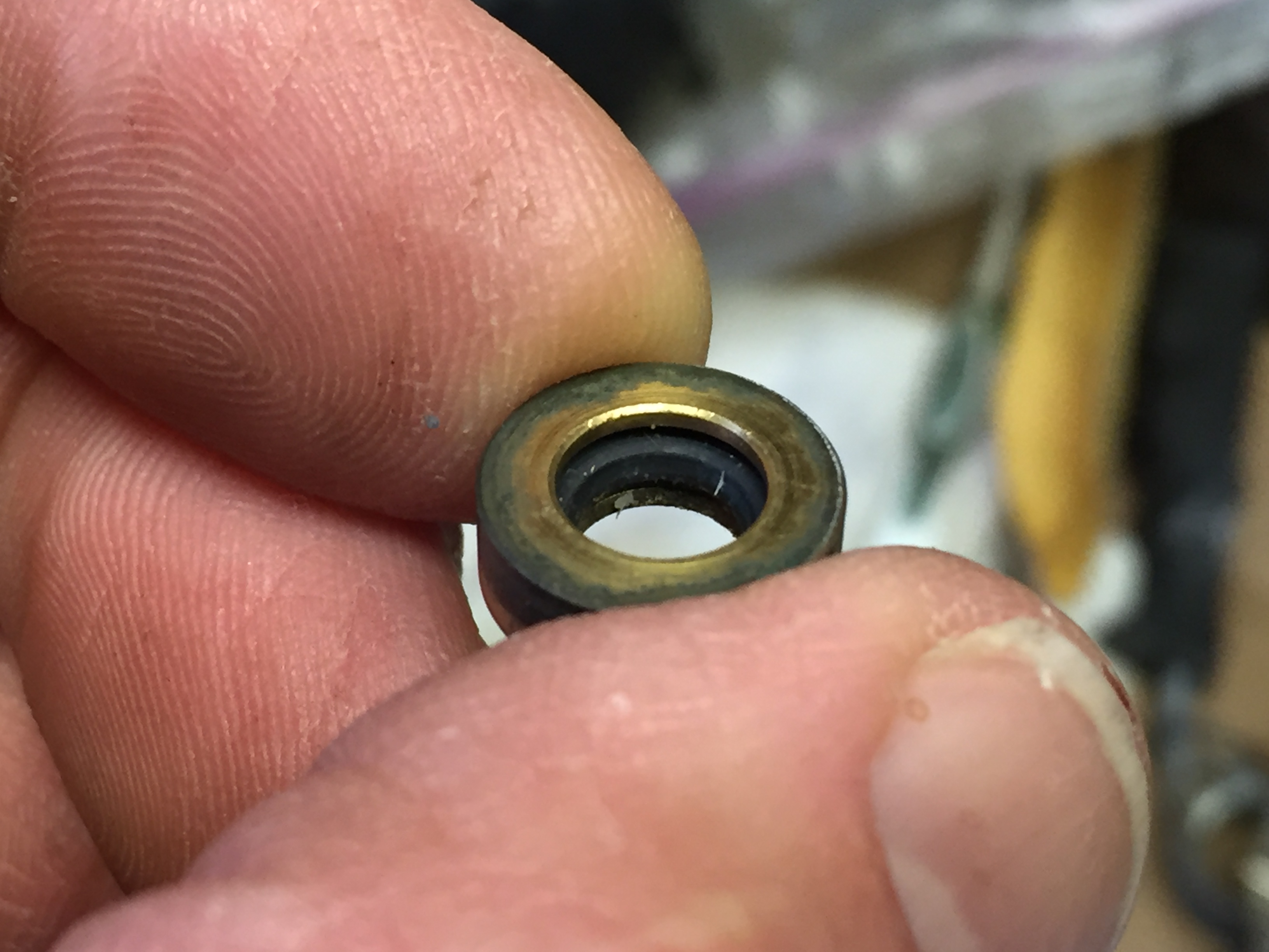

                    I found the answer!! The "groove" for O-ring isn’t actually a machined groove. Part is bored straight thru, then O-ring installed and a washer is pressed in to hold O-ring .
