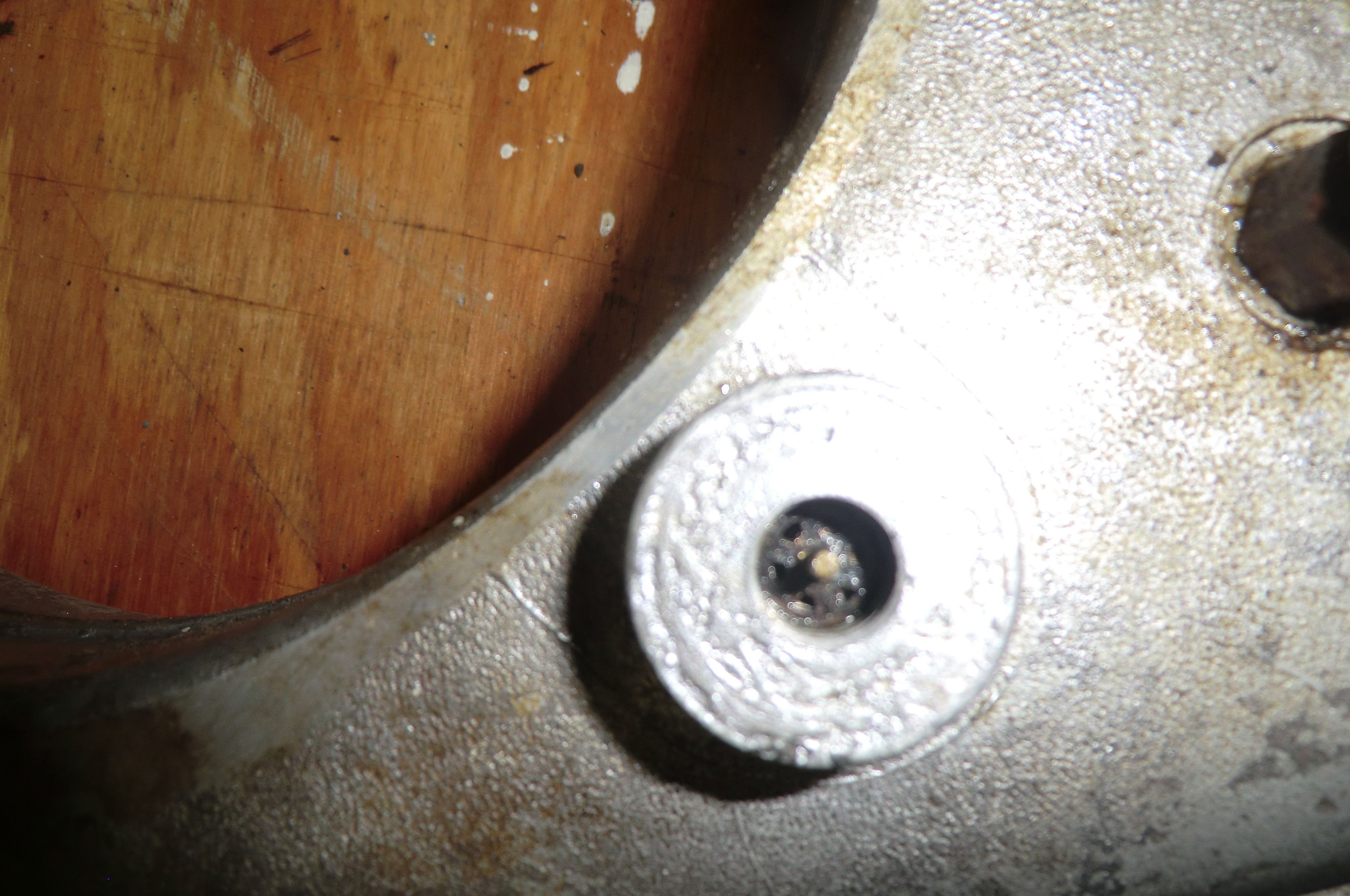

I removed the petcock but I’m not sure if this is a removable fuel filter or something else. It doesn’t seem like it was part of the petcock. I was going to put sealer in the tank for a small leak. I didn’t want to muscle it too much until I checked with you guys.
I really don’t want to take the tank apart but I will if I have to.
Thanks all

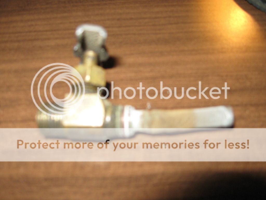

GlenDecember 16, 2016 at 11:03 pm #49293I do believe that that is the fuel filter element. If you should like to view a picture of an element (by itself), please send me a private message with your e-mail address so that I can send you a link, and please post that you have so that I will be sure to login here.

JoeDecember 16, 2016 at 11:23 pm #49294December 16, 2016 at 11:59 pm #49295no need to take the tank apart. tap it in then shake it out of the filler hole do with care.

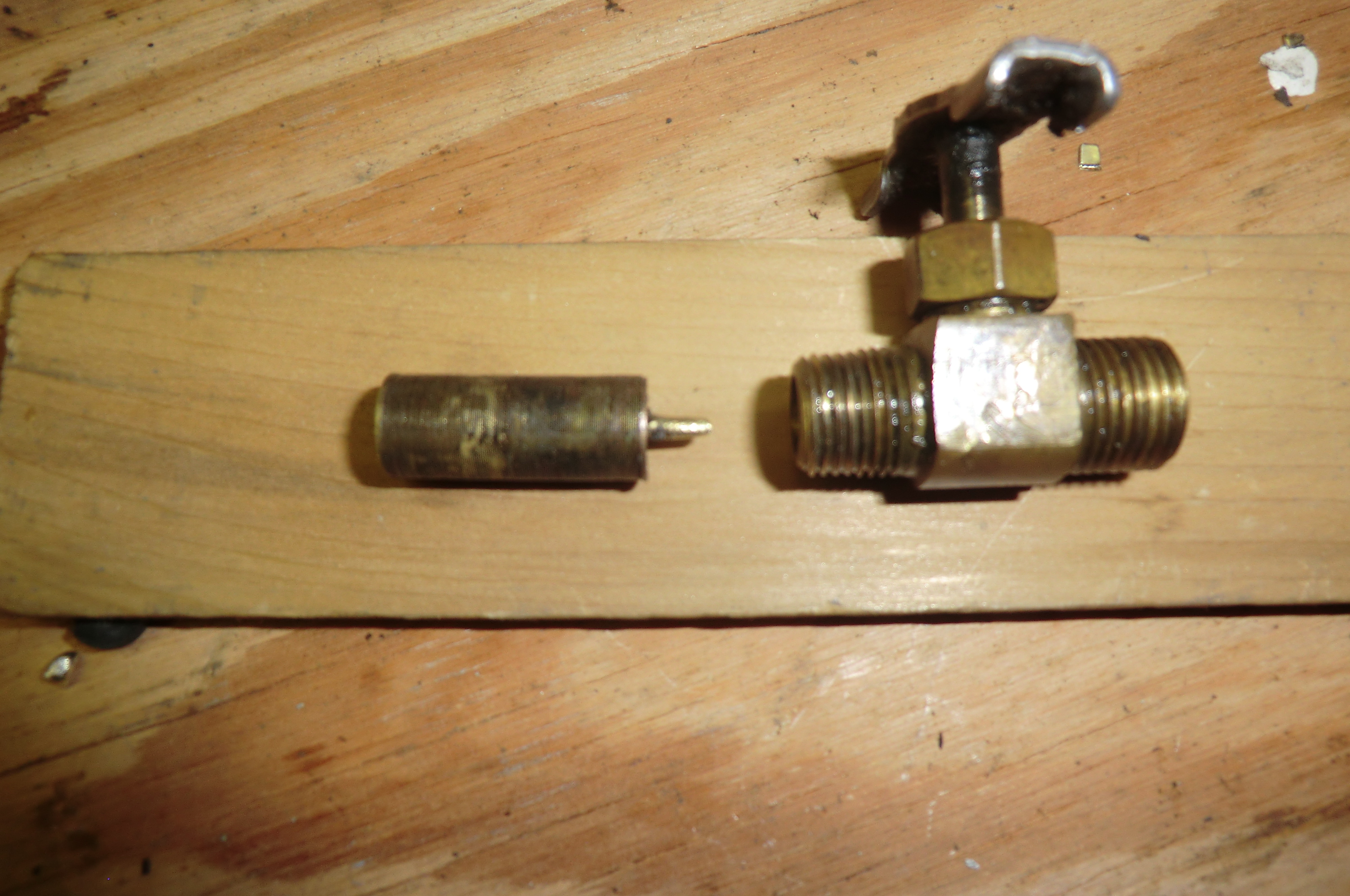

error.I recognize the end of the filter as being the cylinder with a jillion little pieces. It has either
broken off or unwound from the petcock as it was removed. It may be suitable for reuse if it unwound. It should be possible to gently push filter into tank and remove via filler hole.

LouisDecember 17, 2016 at 3:13 pm #49310I pushed it on through as suggested Thanks. There’s about a 1/2 space behind the threads on the tank where it seems to wedge in. It should go back the same way and stay tight especially when I put the tank sealer in. It’s hard to tell if the filter was ever attached to the petcock.

GlenDecember 17, 2016 at 4:45 pm #49312In the petcock there should be a bar that it screws in to. Assemble the filter to the petcock before installing into the tank. as for the sealer DON’T do it with the filter and petcock installed.
