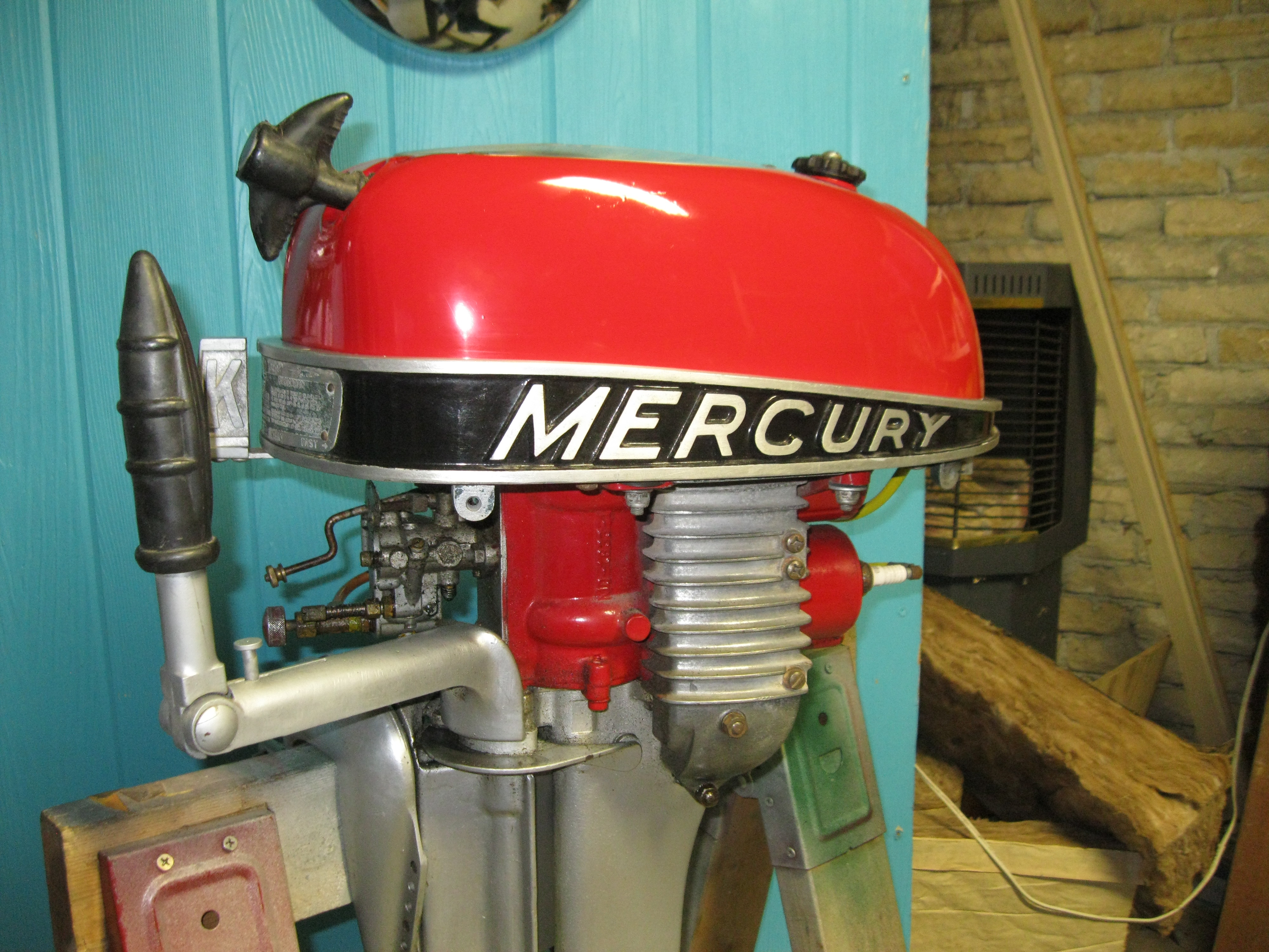

      Go to eBay and look at this KG4 if your motor looks like this below the tank you have KG7, KF7, KE7 or KG4 the carburetor you have is standard on KG7
      #60093
        your pic IS a KE4 Mark7 motor not a KG4 so the AJ23 is the carb for it.
        #60105
        ronboonville
          download/file.php?mode=view&id=9894 below the tank
          #60107
          mercuryman
            That is a KE4 for sure, strange it runs good with a oversize carburetor . You could make a spring just look a photo of AJ23A carb.
            #60171
            david-bartlett
              To me it looks like the choke plate should be flipped as in Dave Bernards picture. That way it would open further than it does in your picture.
              #60360
              20mercman
                One photo of the engine block will answer all the questions. The KG-4 was a Hurricane block, while the KE-4 was much different. Two cylinders, water jackets, etc.
                Steve
                #60361
                jeff-register
                  As usual Dave is correct! Be sure your choke plate is very flat as well.
