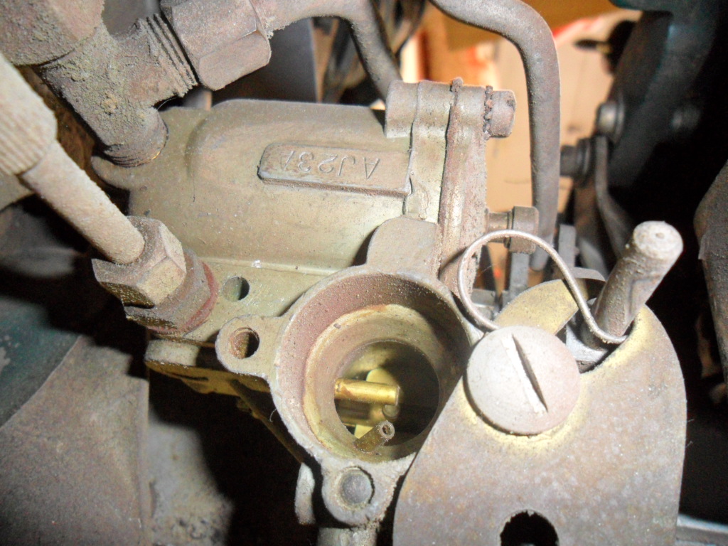

      Can anyone post a pic of how the choke plate works? I’m not doing something right.

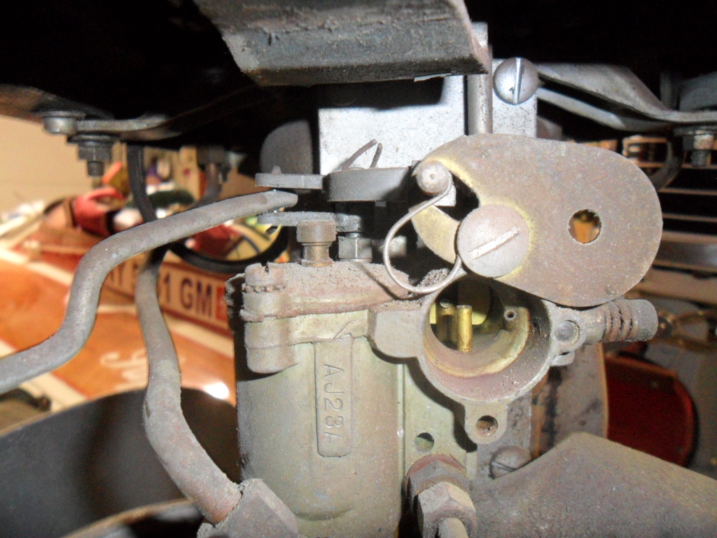

      mercuryman
        KH7 but should be same as KE4

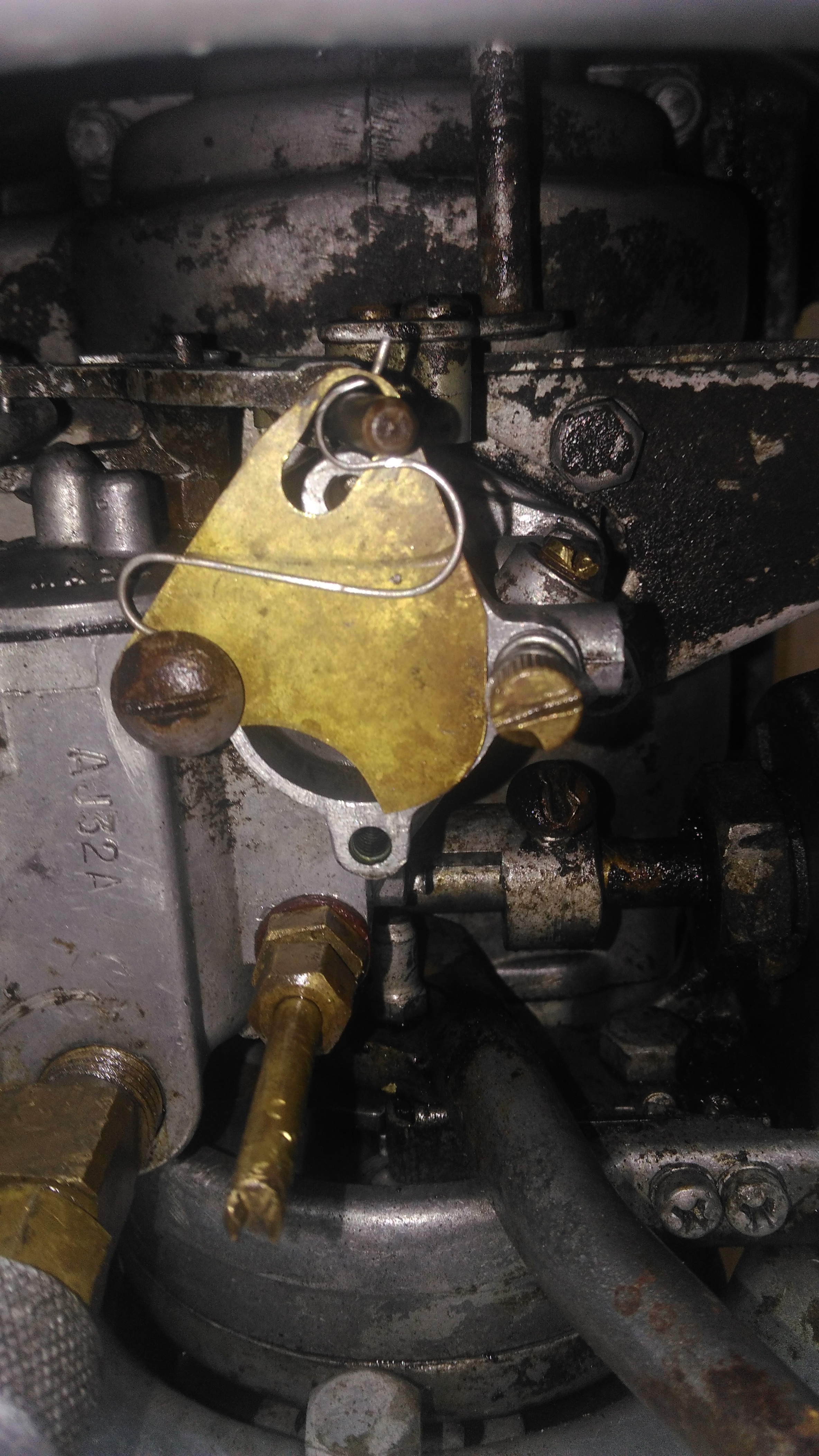

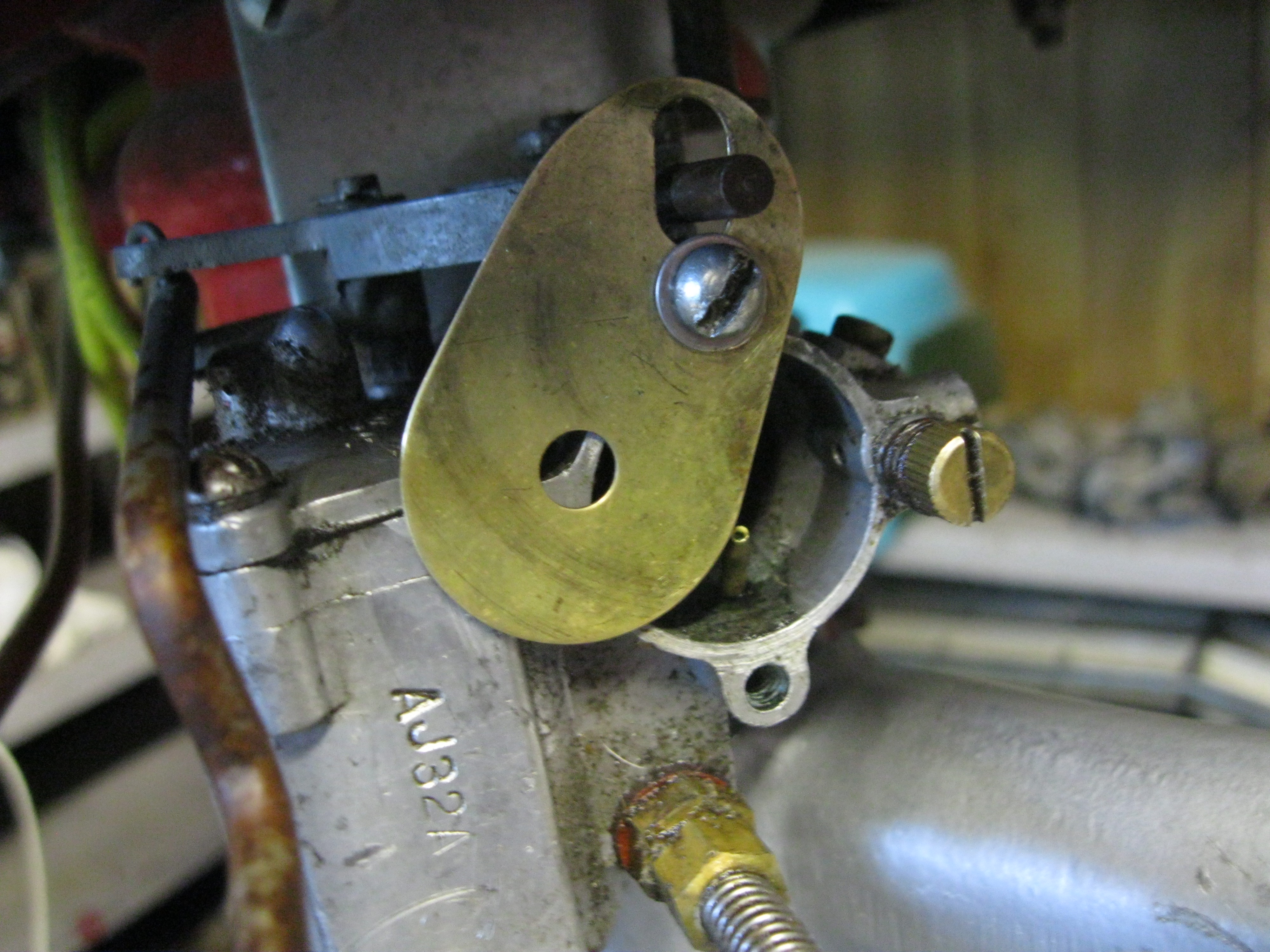

            ronboonville
              download/file.php?mode=view&id=9882 my plate set up is different. rod pushes to choke, and pulls to unchoke. I am doing something wrong.

              mercuryman
                You have a AJ32A that is used on KG7 & KH7 that is the wrong plate for that carb. If you are using the AJ32A on KE4 it won’t run right.
                You need a screw with shoulder to keep the spring from binding, a spring and right choke plate. You pull the choke rod to close choke.
                Go to Marineengine.com and look the the setup for you engine.
