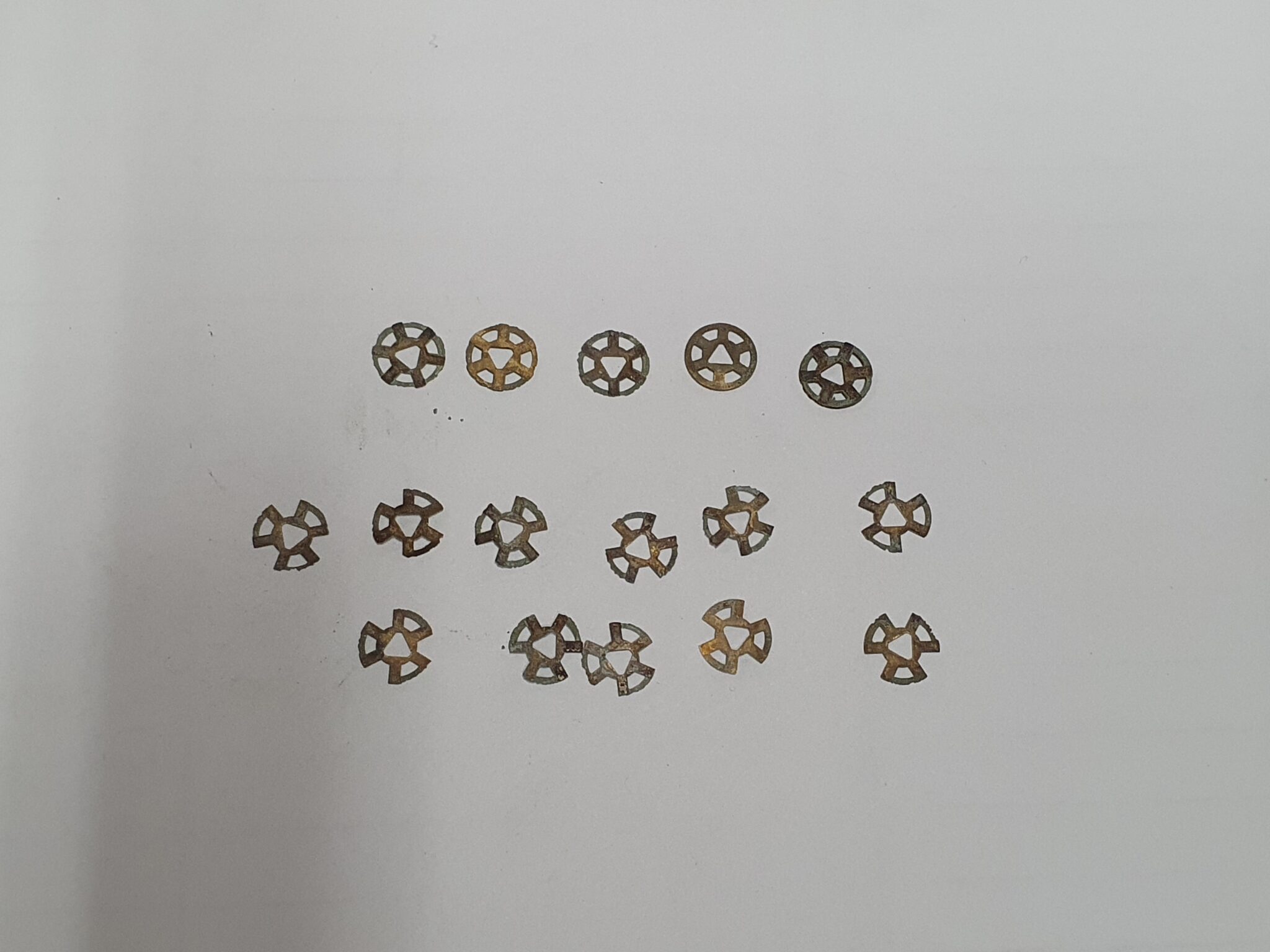

      In flushing out the fuel tank I found a whole bunch of little very small clover leaf shaped discs and when I pulled the fitting out of the tank it had a 1″ long triangle rod coming out of it and the little discs have that same triangle hole in the center. What kind of filter is this? Temporarily I just threaded the fitting back in and will be careful when poring in the fuel…is there an upgrade for this filter?

                  Dave, Here’s a pic of the little brass pieces from the filter in this merc…may not be all of them and I’m sure I destroyed the filter by blowing air thru the tank trying to clean it out. The brass fitting that threads into the tank has a 1″ or so long triangular rod sticking out of it that these little pieces slide over. I’ll just do what Buc suggested and solder in a piece of brass screen for a filter.20220222_152102
                  #255134
                  DAN UMBARGER
                    Dave, Here’s a pic of the little brass pieces from the filter in this merc…may not be all of them and I’m sure I destroyed the filter by blowing air thru the tank trying to clean it out. The brass fitting that threads into the tank has a 1″ or so long triangular rod sticking out of it that these little pieces slide over. I’ll just do what Buc suggested and solder in a piece of brass screen for a filter.20220222_152102-1

                      #255148
                        they were not ment to be disassembled.
                        remove it and add an inline filter.
