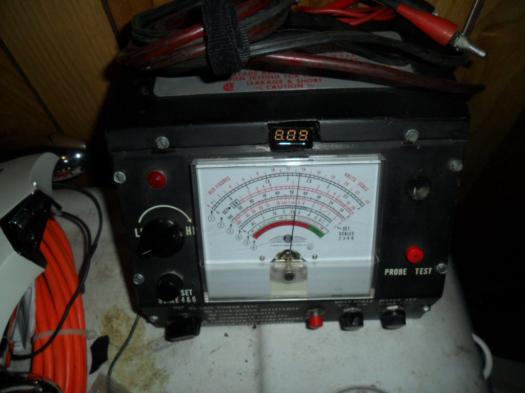

      merc-o-tronic 98.
      I added a volt meter to the on light so I know the condition of the battery when I turn it on.
      Or you can replace the light with the volt meter.

          #253671
            Thanks. the voltmeter is LED so won’t use much battery.
            #253785
              Just a thought but if two insulated terminals were installed somewhere on the outside of the case and hooked up to the internal battery, then the 98 itself could be used to test its own battery.
              #253787
                Bacicly that is how it was done back in the day. just opened the top of the box and test. to much work. this way you know when you turn it on.
                #253843
                  Yeah, it is a pain to take out the screws to lift the lid everytime you want to check the battery.
                  #253848
                    did you install a small — mini    push  switch in series with the display ?
                    #253858
                      NO ! it is hooked to the light. So when it is turned on the light and voltmeter are on.
