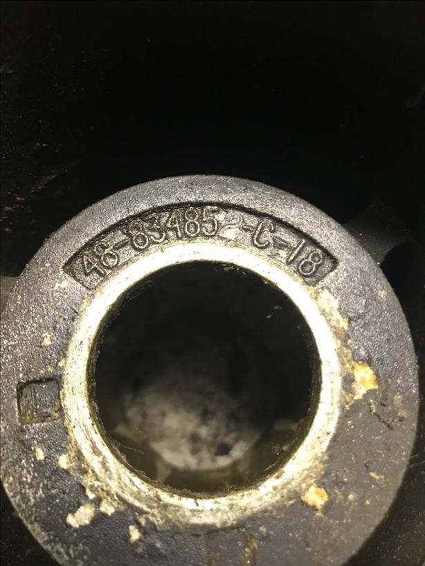

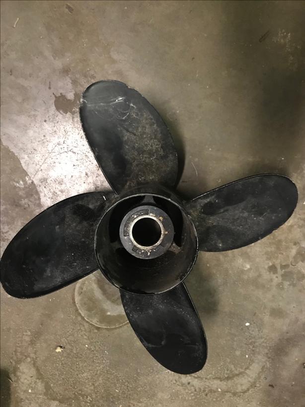

      I can’t find this Merc prop listed anywhere and all it has is 48-83485-C-18 stamped on the hub. It might be for an Alpha drive but not sure. The pitch isn’t stamped anywhere on the hub either. 😕

        Pitch would be 18
        #80651
        outboard315
          14.5 dia, fits 135-275 outboard or alpha/bravo one outdrive. It needs the 835257A hub kit to mount.

            Thanks for the info. I just picked it up and it’s now mounted on my Alpha One Gen II. It’s larger diameter than the 19 and 21 inch three blade props I use but it should work.
