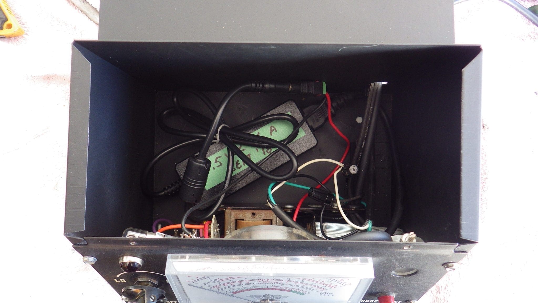

        Dave, if you employ only the power supply, all of the tests are not available.
        The capacitance test will not work. It requires an AC signal. R.T.
        Mine uses a 7.5 volt 6 amp power supply to which produces DC voltage to the unit on demand, just like a battery would. It’s wired in to the mains coming into the unit so only one external AC plug is required. From the outside, the Merc O Tronic looks as original as the day it was made.

        #185589
          yes but that allows you to do all the other test at the dock.
          #185592
            If I ever had to use it at a marina with no shore power to plug into, I do have a small inverter which could be hooked up to the boats battery to get the needed 110 AC power. The bases are covered!
