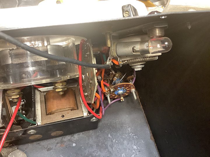

      Tried to contact Mercotronic, but it said the phone number was out of service….
      In any event, perhaps someone here with a coil tester can help me.  The little black lead that connects the unit to the auxiliary battery has broken off from wherever it is supposed to be connected to…  I touched the broken lead to one of the posts on the unit indicator light which seemed to turn it on.  But, I don’t want to connect the lead there if it should be somewhere else.  Hoping someone can look inside their tester and let me know where the negative battery lead is supposed to be connected to inside the unit…

          #297100
          bob-d
            Hi Don here is where it goes on my 98.
            Hope this helps.
            Bob D
            IMG_5155
            #297111
              My 98 is attached to the red lamp.

                  Thanks guys!  I guess that negative battery lead is connected to the power indicator bulb.    I will surely download and print that wiring diagram.
