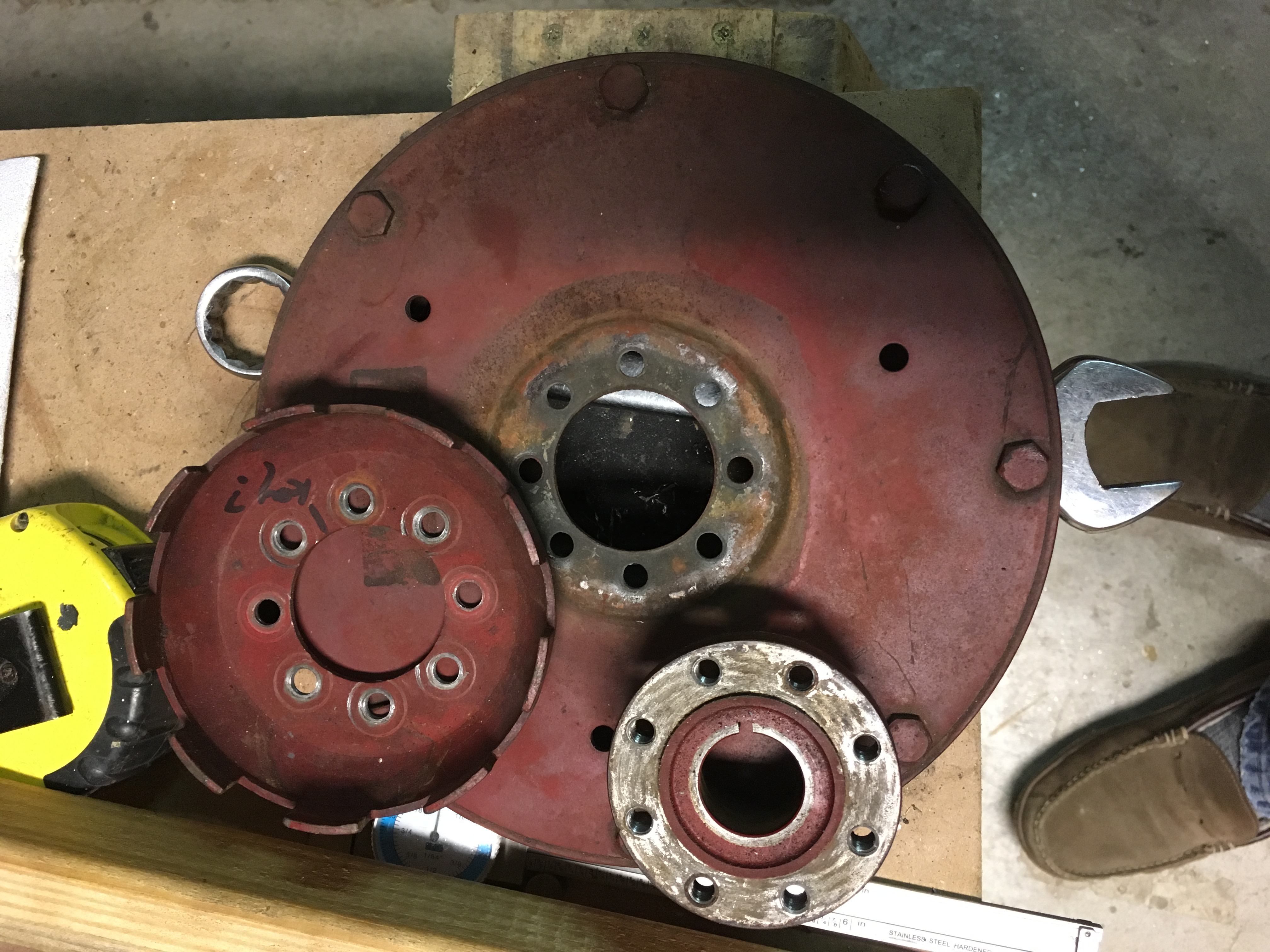

      I have a 1964 Merc 35hp twin. I removed the flywheel to go through the ignition but as this is my first time with one of Carl’s critters, I screwed up right away!
      I separated the flywheel from the hub before I made any reference marks and now I need to know how to put thing right. I don’t want to attack it randomly as there are too many combinations.

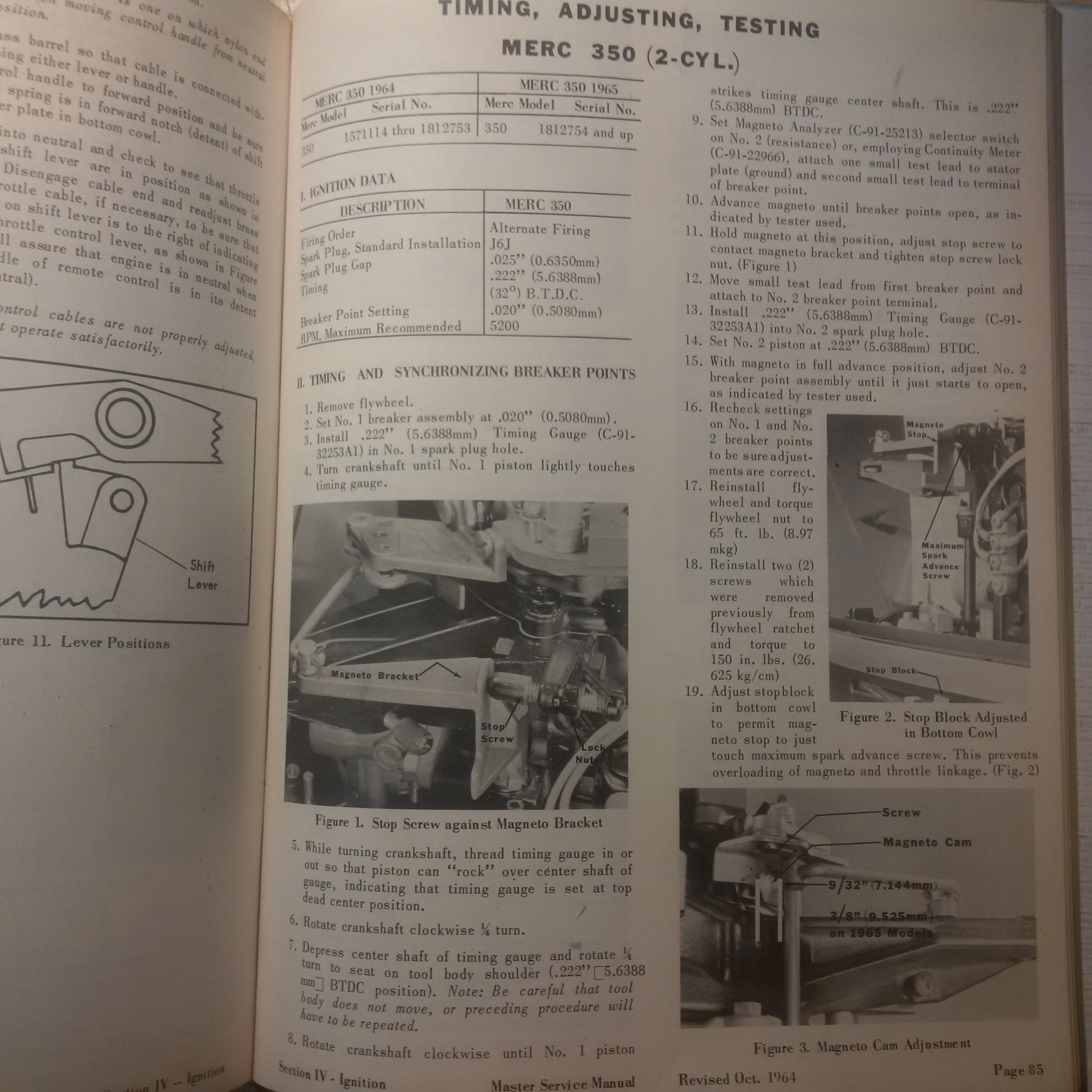

          Not sure if this helps .
              Wedgie,
              Thanks for that. It may come in handy.

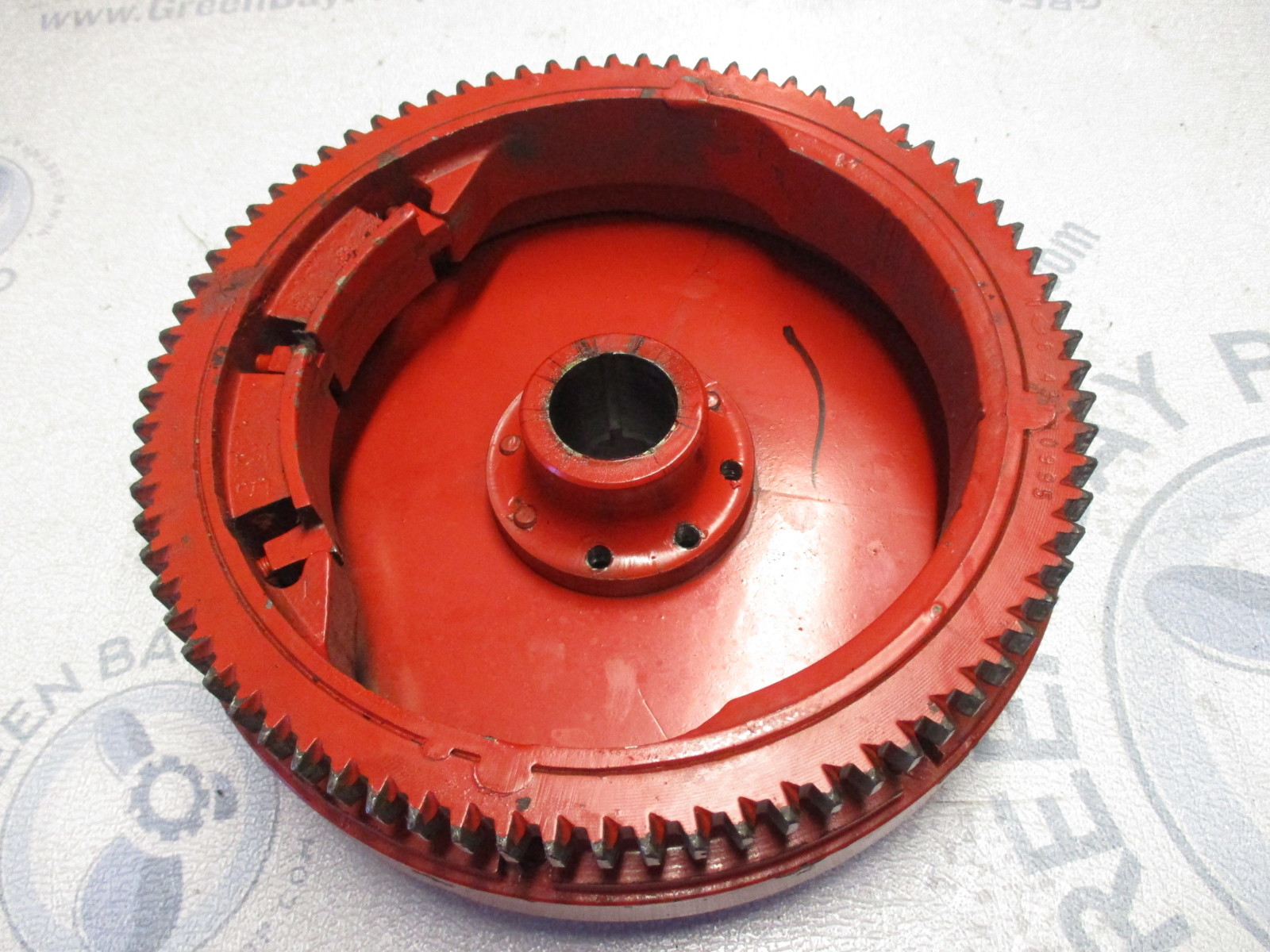

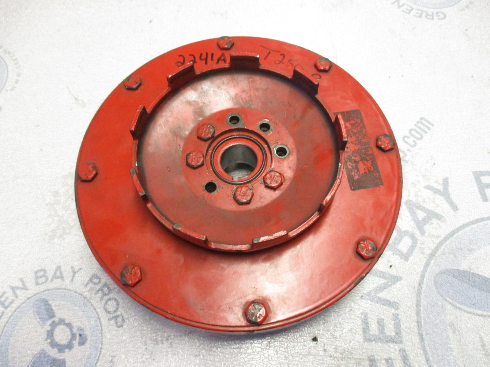

              What I need is a pic of a complete flywheel assembly showing the underneath so I can see where the key way is in relationship to the magnets.

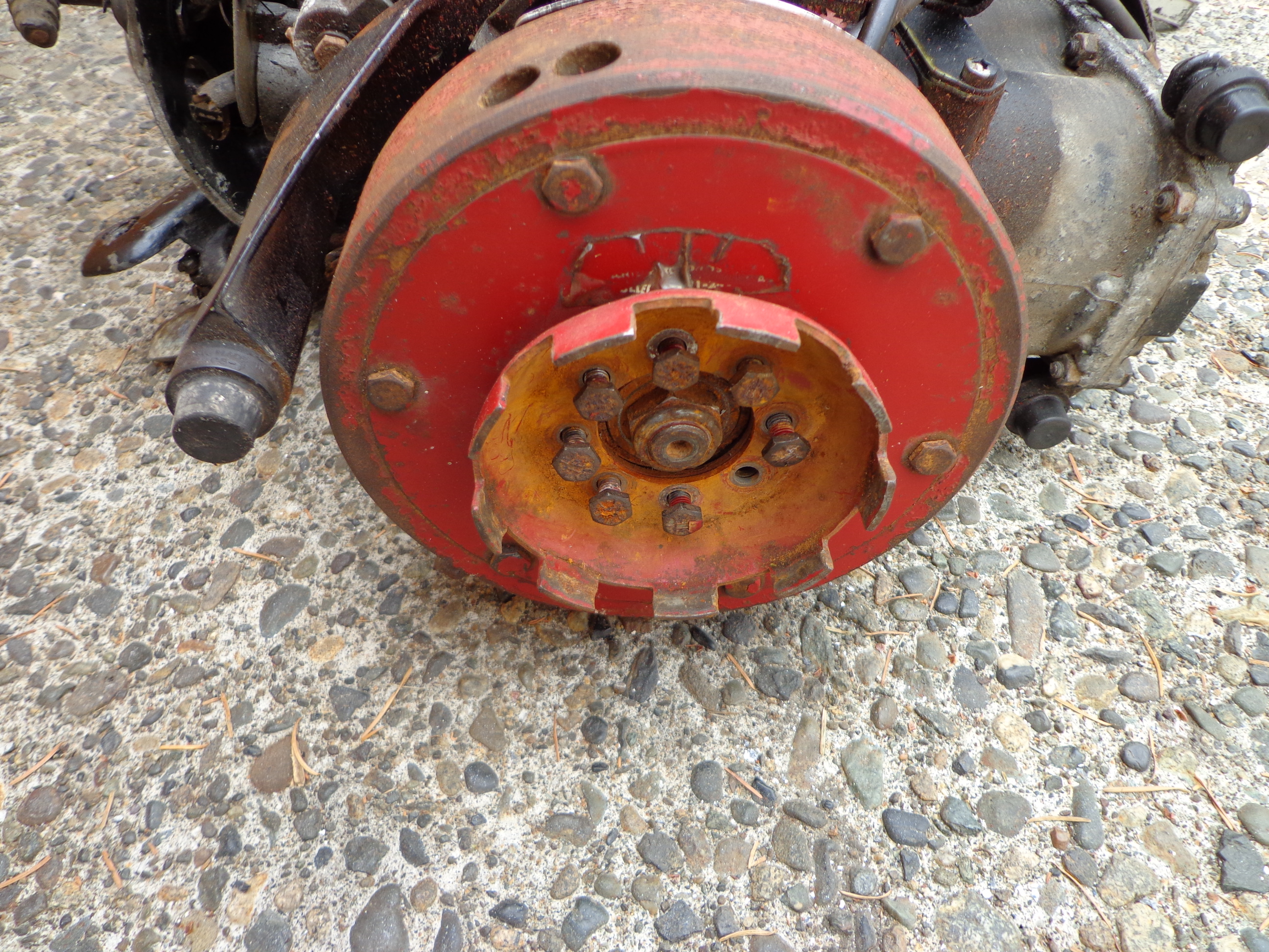

                I’m pretty sure I did something like that on the 200. Also look at any rust stains or corrosion to try and help match it up correctly. You can do it!
                That ’65 200 I had was the Mother Of All Mercs and came straight from hell. I never did get it going and I would have gladly paid the guy who bought it just to get it out of here. :mrgreen: All I have left are some photos.

                  #48710

                    Glad the photo was posted. I would have taken a photo of my 200, but not sure if the relation to the key is the same. Really, you need the magnets to be near the #1 coil when the points open. Shouldn’t be too hard to figure out.

                        You might want to double check the reference flywheel in Wedgies photo as half of the bolts are missing in it. Maybe, just maybe this guy has done the same thing to? 😕
