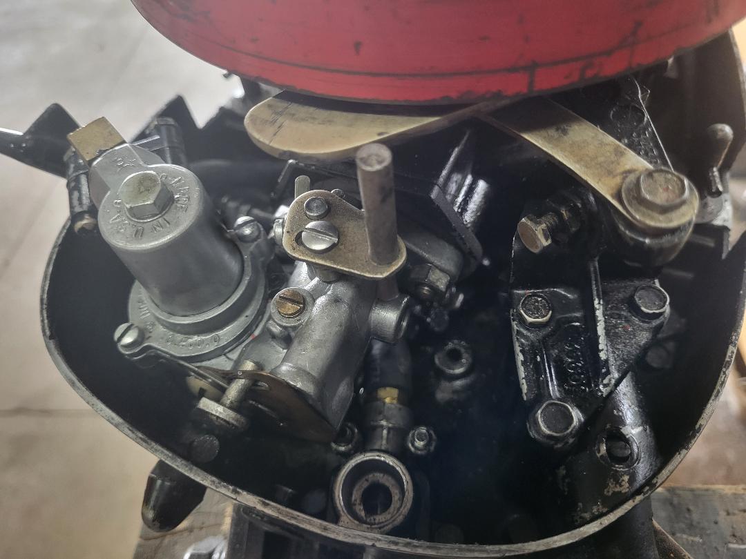

      Seems this motor only runs when the choke is on or partially on. I would like to clean the carb as this motor has been sitting a long time. In order to get the carb off, does the power head need to be pulled? I don’t see how to get the carb off any other way. Am I wrong?

        The back side of the carb mounting flange is relieved a bit, to allow the carb to be tilted/pivited out. To get the choke out of the way, hold the choke arm forward and push in on the choke knob. It is spring loaded. While pushing in, turn the knob 90 degrees and then pull it out of the lower cowl. Even with all this, I didn’t say it is easy….but yes, it CAN be done without removing the power head. It does sound like that’s what you need. Although, if you pull the idle tube out of it (Under the diagonal facing plug on the top side of the carb) you might be able to just clean out that tube and try it again.

          Thank you Bill. I did clean the brass tube I removed from the top of the carb (see attached pic) but that did not solve the issue! So, I guess I’m going in!

                    No Bill, it didn’t. I took the power head off, threw the carb in the sonic cleaner and now it runs fine. On to the next motor!
