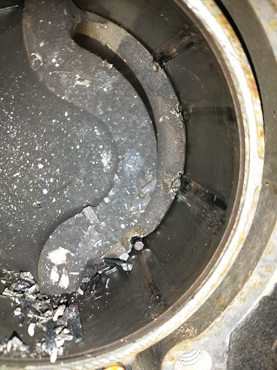

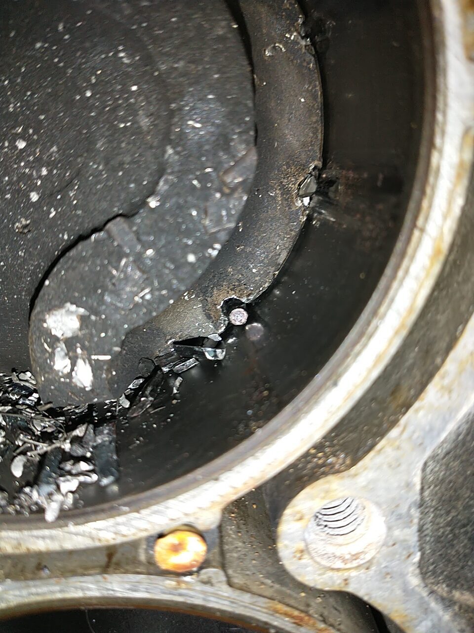

      I seem to be in possession of a four-cylinder Mercury that the needle bearings have found their way into the cylinders.  See attached pics.
      Anyone have any advice with the best way to get the Piston out it’s completely wedged. You can see the needle bearings as they’ve got themselves in between the piston and the Piston wall.   They must have snuck in through the intake.
      After anyone guesstimate the amount of boring that will take to get those scratches out of the Piston walls 30 over, 60 oveIMG_20220813_223416
      IMG_20220813_223410
      r 90 over?

        Is that a Mercury or a Force? I can’t think of any Mercs that had a head gasket except V6s. Is it a Mercury Sport Jet 120? They used four cylinder Force power heads.
        Without knowing what engine it is, I couldn’t know for sure what available OS pistons you could get; but those grooves in the cylinder wall are VERY deep. I seriously doubt that one is worth saving.

        #264353
          short of resleaving that block, it is junk
          #264359
            Yep, that’s a boat anchor unless you can resleeve the block.

              Yes it’s a mercury force. . in this area of the country Mercury forces are on every street corner. They are by far the most popular engine around. Not sure why.
              I figure the engine’s a total loss but there’s a possibility that it could be overbored. The 120hp is in demand. Could also just pull that piston and go with 3cyls.
              Another one bites the dust
