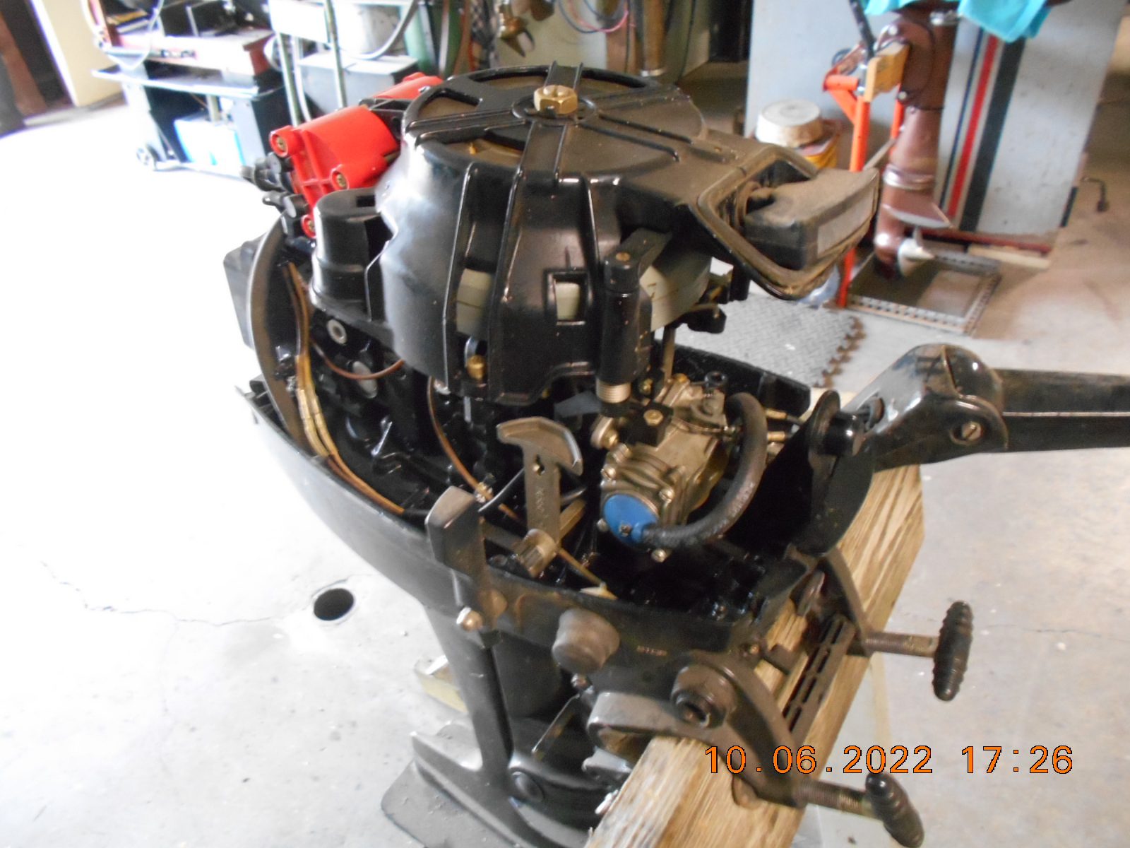

      A friend dropped off this Mercury to see if I could fix it.
      He said it started flooding out and wouldn’t restart.
      I told him I’d look at the fuel system, but if it’s an ignition
      problem, he’s on his own!
      I’m guessing it’s from the 1980’s, but how do I narrow it down
      so I can look up a carb parts diagram, etc?
      I’m not seeing a data tag. Thanks.
      DSCN5015
      DSCN5017
      #267175
        first blue decals came out in 1972.
        Got serial ######## ?
        • This reply was modified 3 years, 11 months ago by DAVID.
        #267183
          Dave, I’ll have to look again tomorrow for the number. Thanks!
          #267191
            should be a plate on the side of the swivel bracket.
            #267192
              Cover graphics should put it at around 1980 to 1981, I am pretty sure. If the ID tag is gone, there is a welch plug with the serial number on the engine block, I think the stbd side.
              • This reply was modified 3 years, 11 months ago by billw.
              #267196
                Thanks for the info guys. Heading out in a little while to look at it.
                #267198
                  Serial Number 5937264
                  I looked on ME and typed the serial number in the “82 and up” box,
                  and it showed parts diagrams on the carb, showing either a
                  Walbro or Tillotson carb.
                  Doesn’t give you a “year” made though.
                  #267251
                    Yup, it is a 1982. Starting serial number for 7.5s in ’82 was 5936301.
                    #267262
                      Good to know Bill, the owner wasn’t even sure. Thanks.
