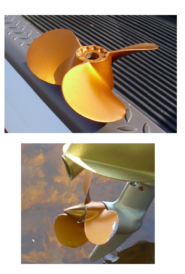

the outer edges of the prop. When I paint a prop
I use a metallic (silver – gold – copper). No
primer. I just clean it well and spray it on. The
metallic’s touch up well and with out the primer
you can easily strip the paint off (lacquer thinner) and
redo it for a show or just to hang on the wall till
spring.

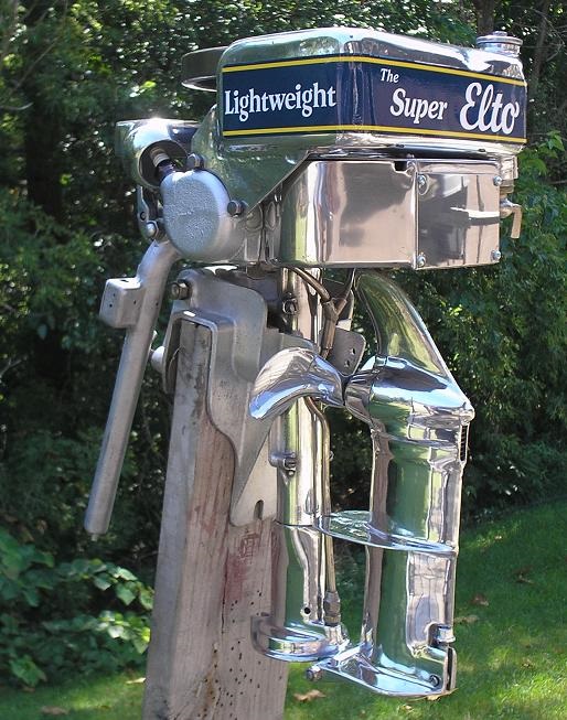

September 23, 2017 at 10:55 pm #65293Tubs,
Nice Merc prop & the KE7.September 24, 2017 at 3:02 am #65296I have had some props that refuse to hold on to paint, and others that I have painted and the have many miles on them and no issues. I think that the ones I have that are resistant are ones that had spent a lot of time with no paint on it, and they absorbed oil into the metal. The hubs are one section that I have on 1 prop that sheds paint like a wet dog.
P.S. I paint some of mine gold like you did on that KF-7 prop. This color seems to have better tooth than my cloud white on my Mercury’s.
