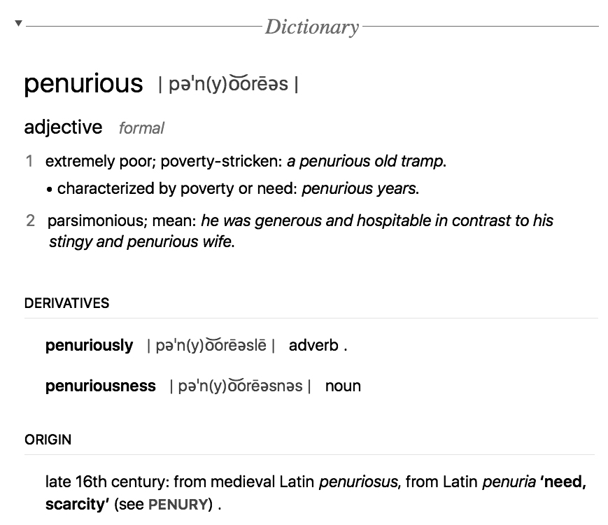

        Never heard the word ‘penurious’ before. Not to hijack this post but what does it mean? When I tried looking it up the definition I got did not fit your sentence. Being an old man I must have missed it in school some 50 years ago.
          probably an auto correct error 😉
          #65329
            This is what I found – – – 😕
            #65335
            wedgie
              I’m guessing Tubs meant to type "porous"
              #65338
                Nope, I’m penurious.
                Its why my hobby is antique outboards.
                There all I can afford. 😉

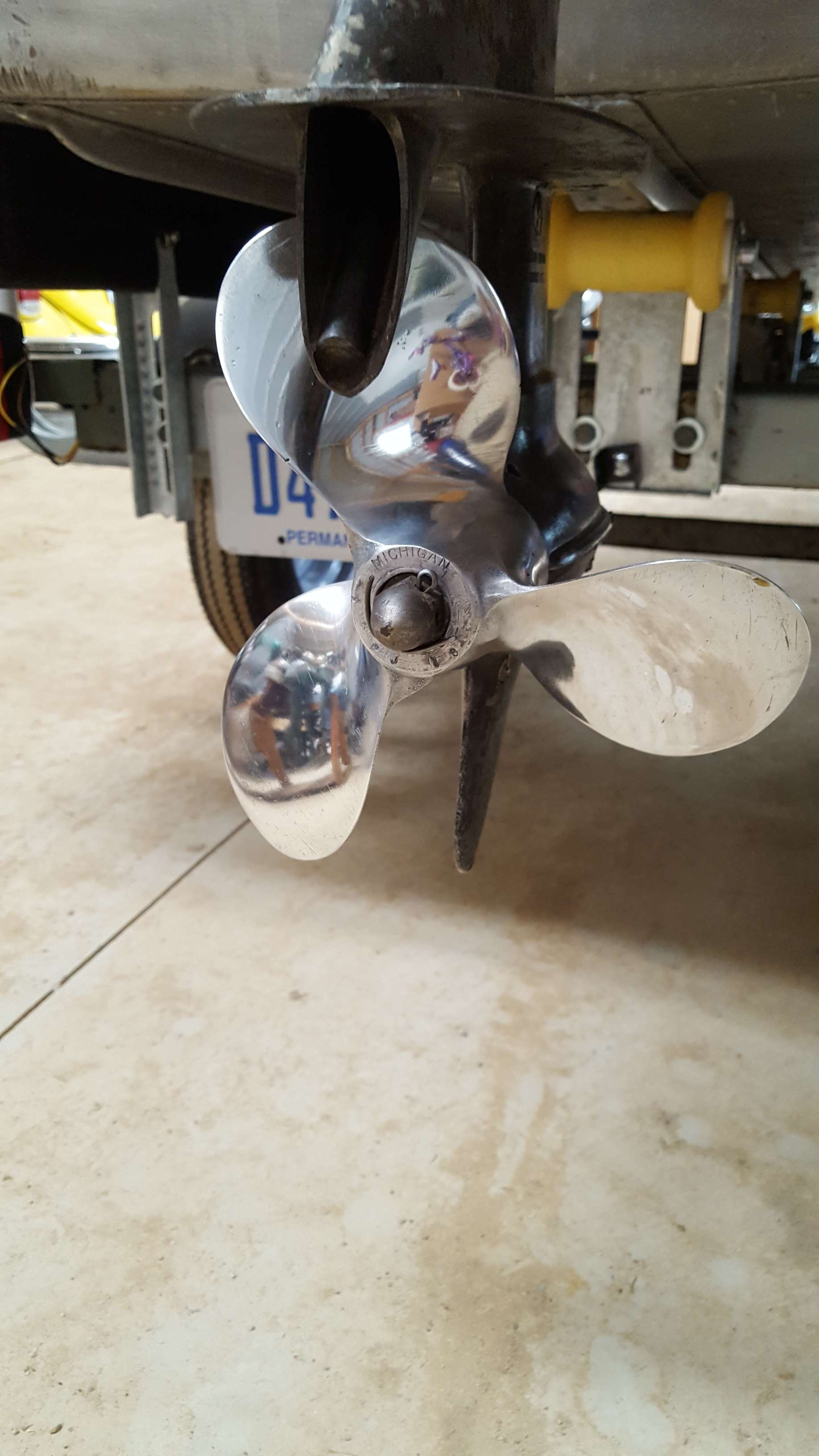

                  Here is a Michigan PJ-18 I polished up. It was really crusty and pretty beat up when I got the prop. I sanded with my orbital palm sander and 120 grit, hand sanded with 220 grit, and hand polished with White Diamond. It will get dull after running it a bit, and you do have to keep up on it to keep it shiny. It does look nice when it’s polished though.
                  -Ben

                    Looks good But I would use a washer under the nut before you loose it.

                      Ya, that’s a good idea Dave. It can’t go anywhere unless the hub let’s go, but if that happened it could possibly slip off there in reverse or slowing down. I usually use the regular cone type prop nuts which eliminates that problem.
