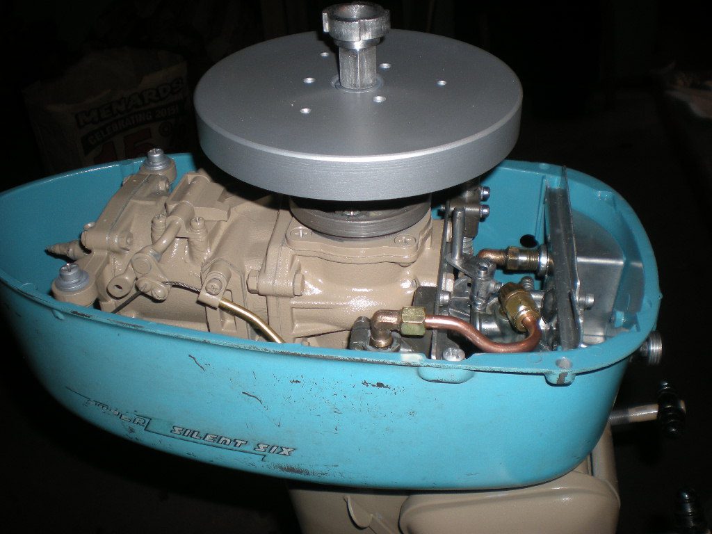

        The guy before you probably used a pipe wrench, but hopefully
        you can come up with something better.
        It looks like my Mk 6 could have used an open end wrench on the
        flats below the top most piece, but guessing the Mk 5 is different?
        Can you use a couple of roll pins for the pipe wrench to engage
        instead of directly on the flywheel nut?

          The best tool for removing Ratchet, Starter  part # 22680
          is Mercury Service Tool M-60-557 Starter Ratchet Wrench
          as shown on page # 25 of Mercury Service Tool Catalog
          posted in Old Iron part of this site.
          Lacking the specific tool, you will have to pad a pipe wrench,
          jam rope into cylinder thru spark plug opening
          and keep in mind Righty Tighty, Leffy Loosey…
