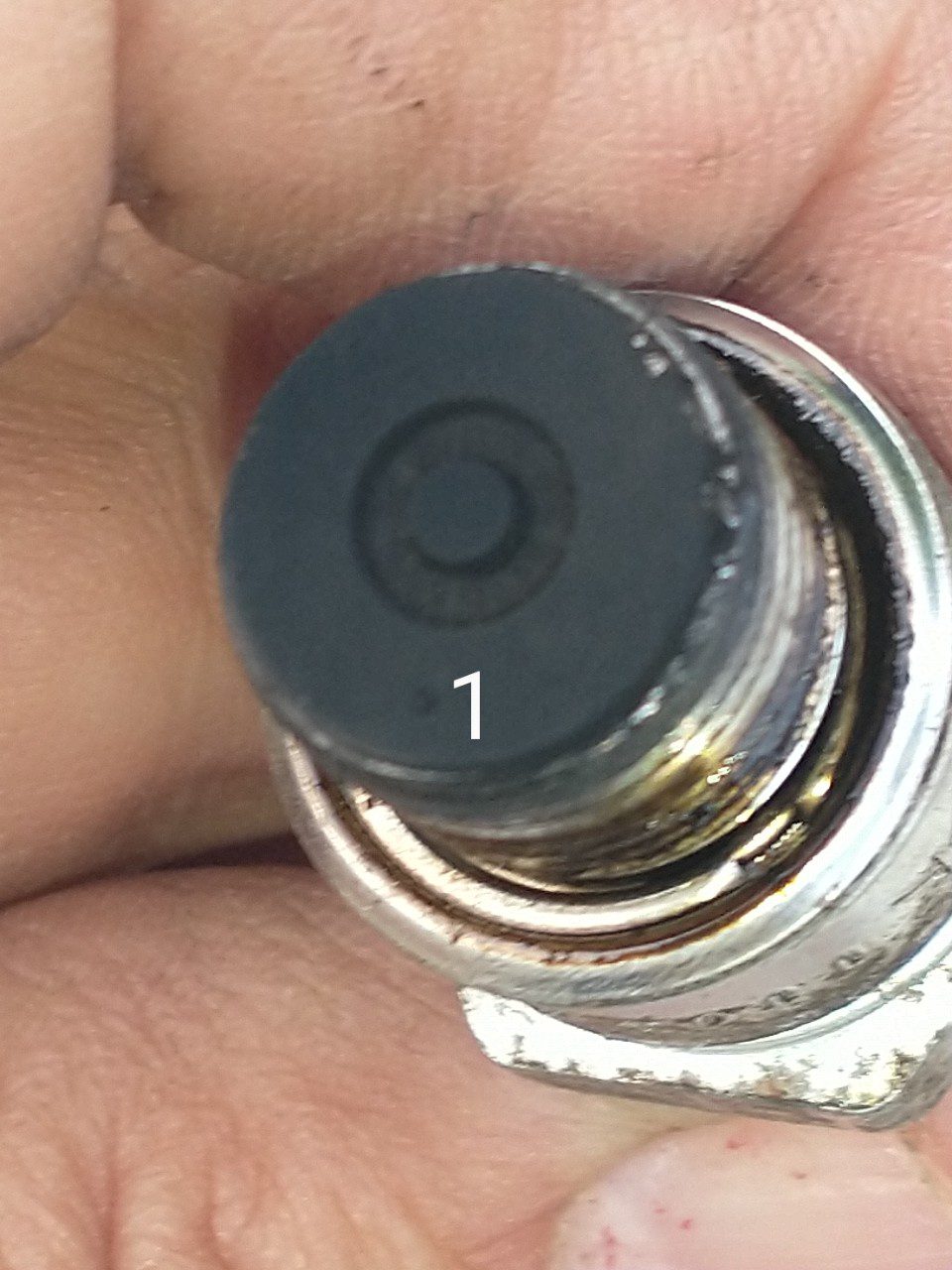

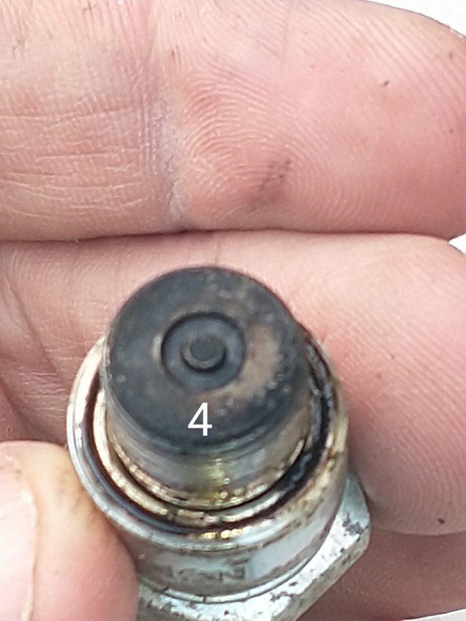

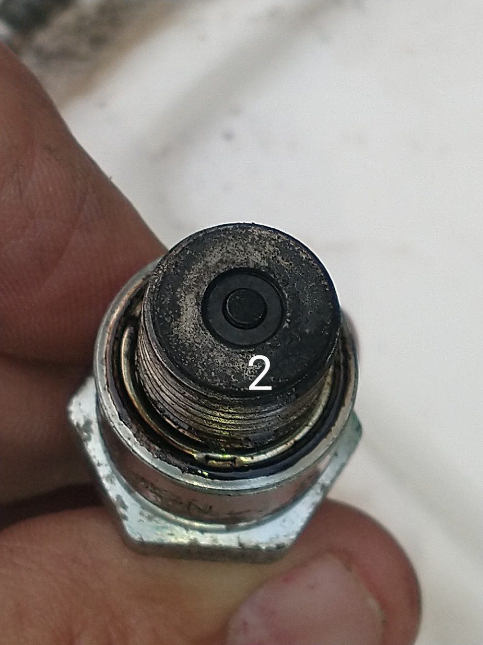

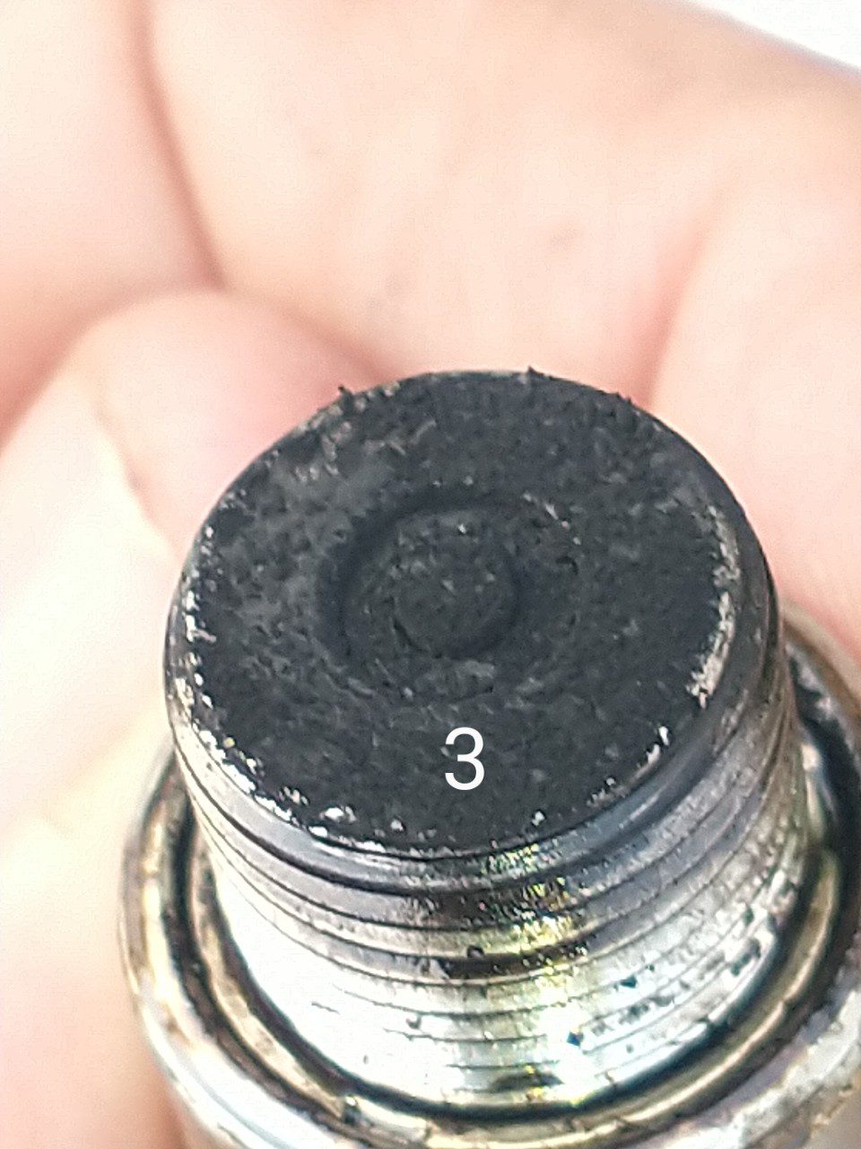

I pulled off all four spark plugs and took pictures and here they are anyone want to try to give me their best idea as to what’s wrong just by looking at the top of the plugs?
(Plug one and three of the worst two and
four are not too bad. I think this will rule out immediately fuel pump diaphragm cracking?)
June 4, 2024 at 10:07 pm #288124Points of interest cylinders one and two share a carburetor as well as three and four share one.
Given that cylinders two and four both look to be better.. I find it hard to believe this could be a fuel issue.

June 5, 2024 at 2:08 pm #288128Ok sorry for the trouble guys. As you know it was cylinder 1 and 3 black on the plugs. So I immediately traced cylinder one and three (and on this system they are brown and purple).
Course I immediately became suspicious because I know from experience that purple wires can look Brown after being on the engine for some time.
Upon further inspection .. even though I could see there was a brown to brown wire connection: looking further there was a brown to purple lower. So I took out my jackknife and scraped on the top brown and voila one micron thick layer of brown scraped off revealed purple. Ok HOW COULD IT HAVE BEEN RUNNING AT ALL?
