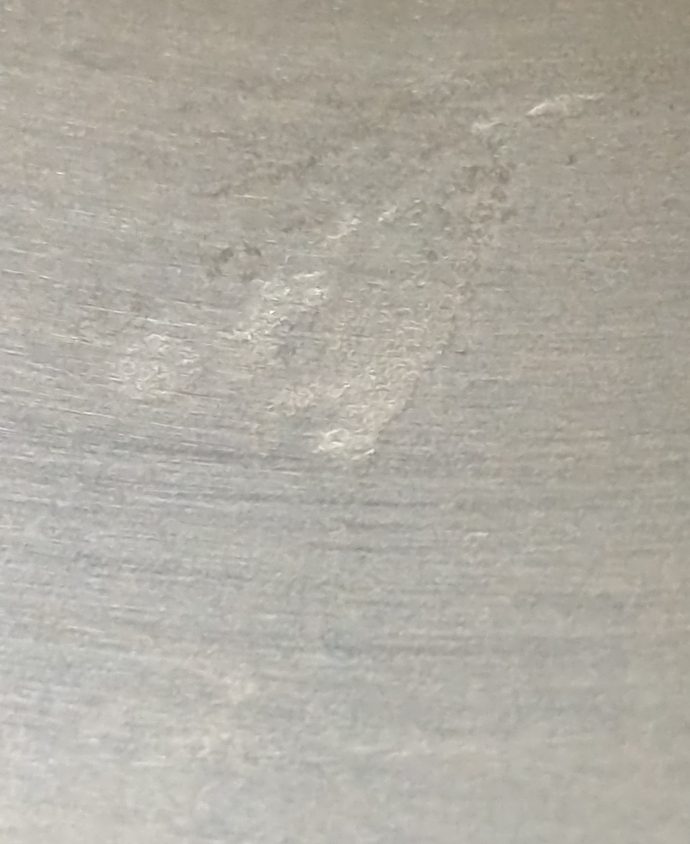

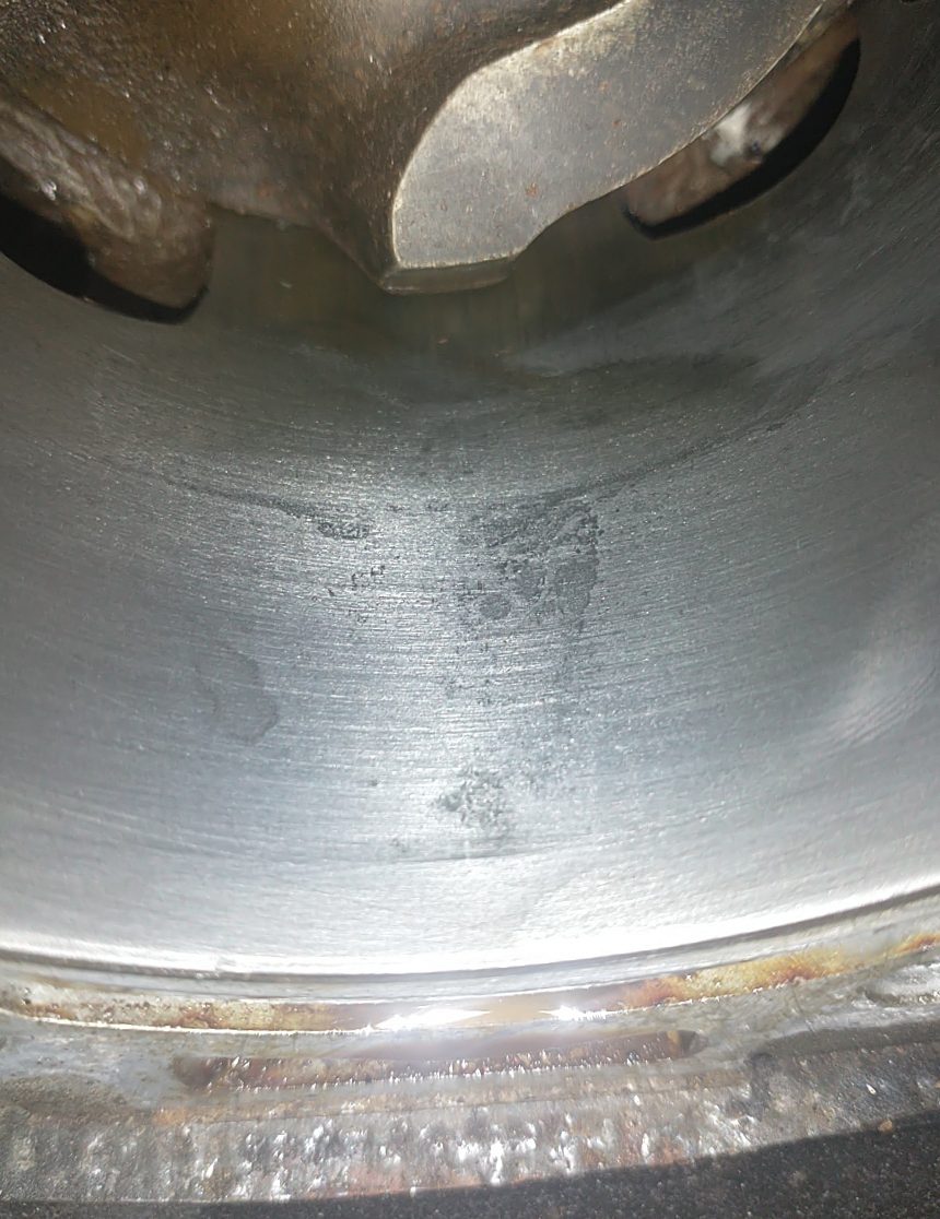

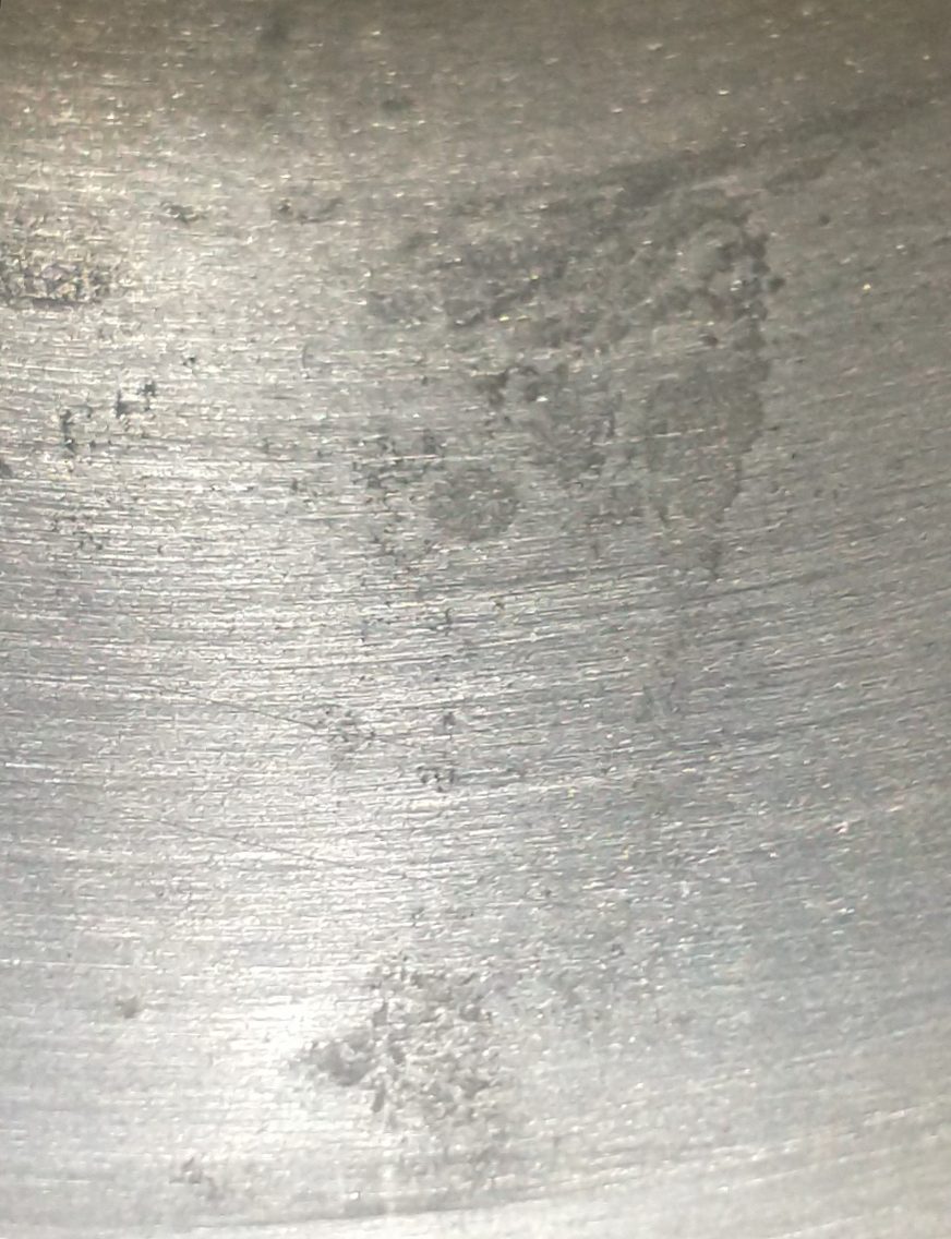

      Picked up this 90 horse 3 cylinder and the bottom cylinder got water in it and sat and it started rusting an obvious spot..
      I hit it with a home and I spent a solid 40 or 50 seconds running the honer over the affected area.
      You can feel the blemished area with your fingernail you don’t really catch your fingernail… but you can definitely feel the abrasion as your nail.goes over it .. IMG_20220904_210146
      IMG_20220904_210244
      IMG_20220904_210312
      IMG_20220904_210233
      it’s not just cosmetic
      The question is is it salvageable? Or will the block last 2hours then melt the piston and rings as the tiny part of the power combustion goes by the ring in that spot?

        It will definitely be down on compression. The engine will not perform to its full capability. But it will fire and run to a very limited degree. If you can still find an oversize piston, you should get it bored out now. You are in the perfect position to do it now. Why be disappointed later?

                I suspect you’ll have more compression loss from
                taper in the cylinders (have you checked that) than
                from the water stain.
