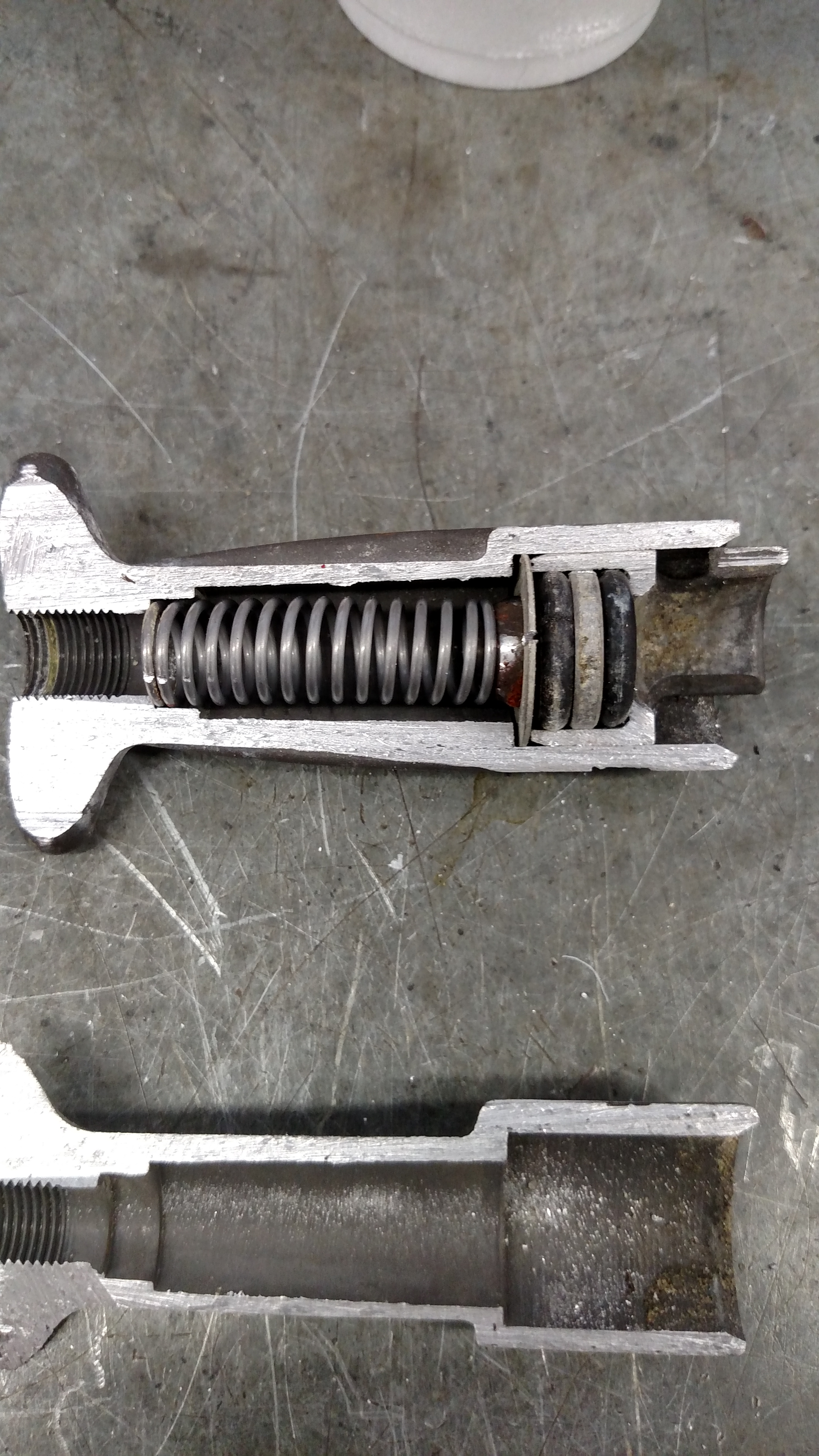

April 29, 2017 at 8:43 am #56794I had a post going about doing the TANK fitting. I seem to recall they take dash 205 o-rings, which are the same on the hose end fitting. They appear big but they are right. (Don’t go buy 100 of them until I double check that number!)
The problem is, there are two o-rings. One is easy to change. The other has the check ball up against it, under spring pressure, all the time. On the TANK fitting, you can remove the pick-up from the tank, remove the tube and reach in with some small tool to hold the ball and spring out of the way. On the hose end, you can’t.
I still have not figured out an easy way to do a hose end. The twist latch part IS just pressed in. I actually sawed a whole hose end fitting in half and made a cut away, to know exactly what I was dealing with. (I could send you a pic if you want it.) However, that thing is a really tight fit. I made a special puller and heated the fitting, but the twist latch ears still snapped off, when I tried to pull one out. Your luck may vary.

April 30, 2017 at 7:50 pm #56883The picture of the hose end fitting is there mostly to show the arrangement of stuff, which is the identical arrangement in the tank pick-up fitting. That’s what David said he was trying to work on. Not sure those are available for $15. Still, I think it would be neat to be able to change the hose end fitting o-rings because $15 may be cheap, but about 20 cents is even cheaper.
